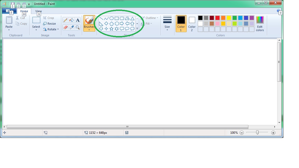

    In MS Paint, use the shapes to highlight, such as a circle. Click image for larger version.
ID:	9159 I used Alt + print screen on the keyboard to capture the active window, In this case MS Paint, then select "paste" in ms paint to manipulate the image and saved as a jpeg. If you upload your image directly to the forum from your computer, it will be resized automaticly and show up as a thumbnail. When a page is full of full size pics it causes the page to load slow for those with slower connections and uses more bandwidth for those with caps. When you use thumbnails the user can decide whether to load them or not... not complaining, just offering a suggestion.
