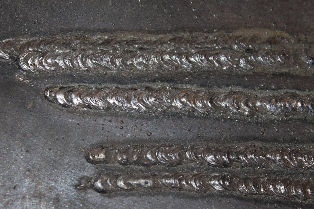

    Same beads, not quite as uniform as I'd like, but maybe not horrible? These were at 80 amps, 3/32" Lincoln 6011 w/a bit of drag angle.

    I think tomorrow I"ll go back to a lower current and see if it burns the rods down slower, making it easier to manage the arc length.
    Everlast PowerArc 140ST
    Make sure your stick torch is in the positive. Looks like it was done in straight polarity (negative).
    Nope - it's definitely in the (+) terminal, and the ground clamp in the (-) terminal.
    Ok, then that tells me you may be holding too long of an arc. 6011 has a tendency to burn a little quicker so they can cause a longer arc.
    I believe that. Whenever I focused for even a moment on the molten pool, the arc would get longer than I intended. Just takes practice until it's automatic I guess - like so many things in life. Thanks for the feedback - I'll give it another go tomorrow and see how it goes. Should the bead height be shorter and broader - is that what I should be looking for? Sorry for the remedial questions.

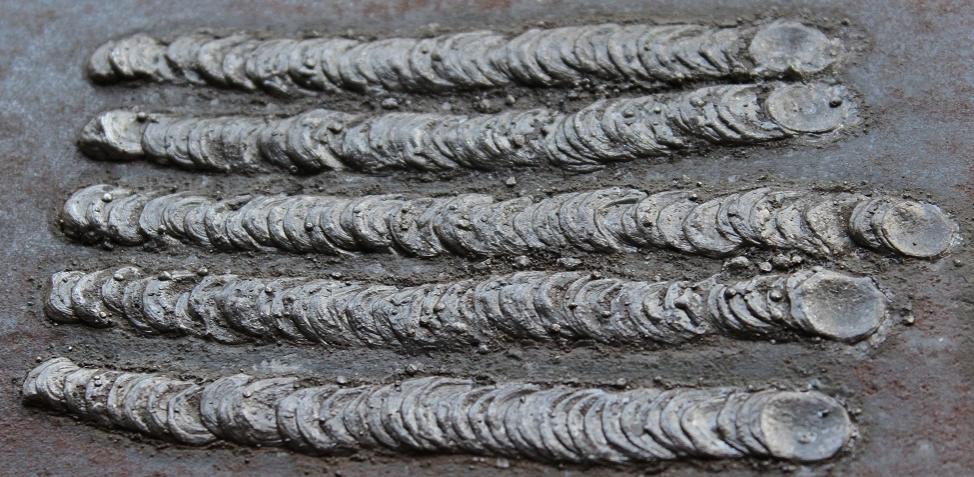

    OK - I've been practicing a bit, and my results (to my eyes) definitely look to be a bit regular. The ripples are more consistent, probably down to my learning how to hold a more consistent arc length.
    3/32" Lincoln E6011, 65-70 amps. Base metal is a section of 6" square pipe, 1/4" wall, a bit rusty from sitting in the backyard for years, but wire brushed to remove the major rust.

    The first part of each weld has more buildup than the rest of the weld -once I get going I must get into a rhythm of something, or the metal heats up making the puddle spread a bit more, or ... ?
    Not as professional looking, and more variability from bead to bead, than I'd like, but I think it's adequate to actually join something together soon. I think I'm going to get some tubing and make a rolling stand for my radial arm saw. I'm planning basically a simple square of angle iron with casters on the bottom that the existing stand will set into. It'll probably be ugly, but I'll do a little grinding to clean it up if it's too bad. Should be a bit more fun (and practical) to actually join metal rather than just make lumps on a sheet, I think!
    Any suggestions for how to smooth out the start of the weld, and how to better reduce the crater left at the end of a weld would be appreciated. I've been experimenting around a little bit, but nothing seems to work great so far. Thanks!

    I'm in the exact same boat as you are. The 140ST is an amazing little box isn't it? The lincoln fleetweld 3/32 6011s are my staple. Also tried the Hobart 3/32" 6011s too but prefer the lincoln. Have not broken open the 7018s yet. Wonder how they'll do.
    My main issue was arc length too. I was either long arcing because I'd focus on the puddle and delayed moving or just ramming the rod in there to stop the long arc cus I was burning too hot. Was using the lincolns at about 80 amps and seems to be good but when I turned it down to 70 amps it all clicked. I stuck a few times but as my hands got steadier, the weld was more controlable. Most of the material I was welding was 1/8" light carbon square tubing. I had a few brake rotors lying around but couldn't get a decent bead on them. (Too Rusty)
    As for the ending, are you coming back onto the weld and snapping out? That's what worked for me and leaves fewer craters. The lower amps allowed me more time to adjust the weld so that improved my starts, although it stuck more often.

    Lately, I'm holding a little bit at the end of the weld, and instead of just snapping out all at once, I'm pulling away a touch more slowly. That's helping a bit - the crater is still visible, but still above the level of the original base metal. I'll try backing over the weld for a second or two to see how that works for me. I've tried running everything from about 55 to about 85 amps, just as an experiment, and 65-70 amps definitely seems to be the sweet spot for these rods. Good to know we're not getting completely different results!
