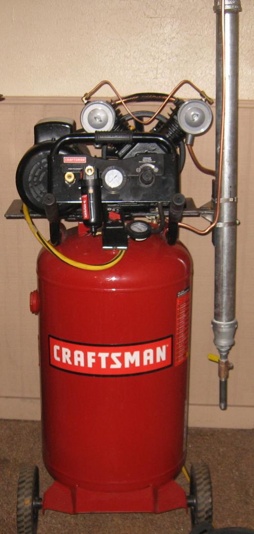

    Don't mess with having to continually replacing compressors. Get yourself a Harbor Freight or Craftsman oil less compressor. Take off the pump and put it up for sale on Craigslist. I sold mine for $60. Keep the tank or even better, get a non working compressor off Craigslist for almost nothing. Then buy a good 3HP or higher 220 volt electric motor and then get yourself a good oil lubricated pump. I got my electric motor off E-bay for $35 and the pump I got from Eaton Compressor in Ohio. The one I got will pump out 14 CFM usable at 90 PSI and fills my 33 gallon tank quickly and quietly. (72 DB).
    Don't forget to make sure you have a way of removing water out of the air. That is what the silver thing (Franzinator) is on the right side of my compressor.
    I have about $600 in my compressor but it was well worth it. It is portable, quiet, fast and does everything I need it to do. I can run my PowerPlasma 50 easily and also any air tools I care to use. I can even paint a car with it and it will handle just about anything I need it to do.
    Don't waste your time with cheap junk. You have a great plasma cutter in the PP50 and it needs plenty of good clean air.Click image for larger version.

    the silver thing (Franzinator) is on the right side of my compressor.Click image for larger version.

    Thank you for that post. Can you post more pics of this setup and more info on materials/fitting used please? Is your pump pumping into that contraption before it goes into the compressor tank? Are you running any other water/air filters and do they pickup any water or is this thing doing all the work before it hit them? I'm asking because I was working on making something like this but my idea was more elaborate and maybe over kill. You're seems much more simple and cheaper.
    Your setup is to heavy to haul up and down my basement stairs on a regular basis however I was giving some serious thought into building my own standing shop compressor like your setup here in the near future. This small compressor won't handle the high demands of a blast cabinet, HVLP sprayers, sanders or other high demand air tools. I really wanted this compressor for the portable aspect as well as it being quite plus it's power for such a small compressor. Right now I do as much upholstery work as I do metal work so the sound level and portability is important to me. If it can get my by for a few months (with an auxiliary tank) while I piece together a proper shop compressor I'll be happy. Part of the issue is also dealing with yet another 220V outlet in my shop. I need to talk to an electrician because my box is maxed out and I'm unsure if the main box is capable of handling all that load plus what I have planned for the future. I don't own the house so I'm limited on what I can do.

    Here is a link to this site discussing the Franzinator....http://www.everlastgenerators.com/fo...-dry-air/page2
    The compressor pump pumps air directly into the Franzinator where it changes direction of the air and cools it down so the compressed air drops the moisture in it as it cools. The air is forced downward in the pipe where it stops and then moves up to the top of the pipe where it then exits and goes directly into the tank. I have noticed a huge drop in main tank moisture with this set up. I also run a standard air moisture filter and finally a Motorguard filter to make sure there is no water in the air.
