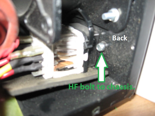

    Does anybody know if using the HF ground terminal on the PP256 would cause any issues with a GFI breaker? I'd think that for it to be able to affect the HF noise coming from the machine, there would have to be something flowing through that lead, (whereas normal ground is a safety path that shouldn't normally carry any current). I'm also not sure if the GFI breaker would be sensitive to current flow at that high a frequency anyway. It would be unfortunate if using the HF ground would cause the breaker to constantly trip.

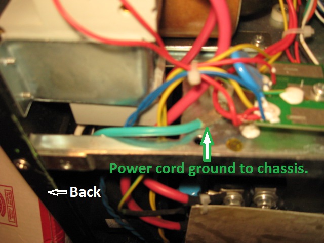

    The ground bolt on all these machines is a chassis ground and just gives you a connection point for a shorter ground path. Click image for larger version.
Name:	IMG_1131 - Copy2.JPG
ID:	9333Click image for larger version.
Name:	IMG_1133 - Copy.JPG

    It's not a seperate ground it's a bonded ground.

    True, probably not the best wording on my part. Let's say alternate ground path. The net result is that the GFCI will no longer have the only ground path to measure current on. So you could have some current leaking to the chassis and going through the ground attached to the ground point on the back and the GFCI will not trip, because it will see no current through it's ground line. Not anything I would mind, but something to be aware of.
