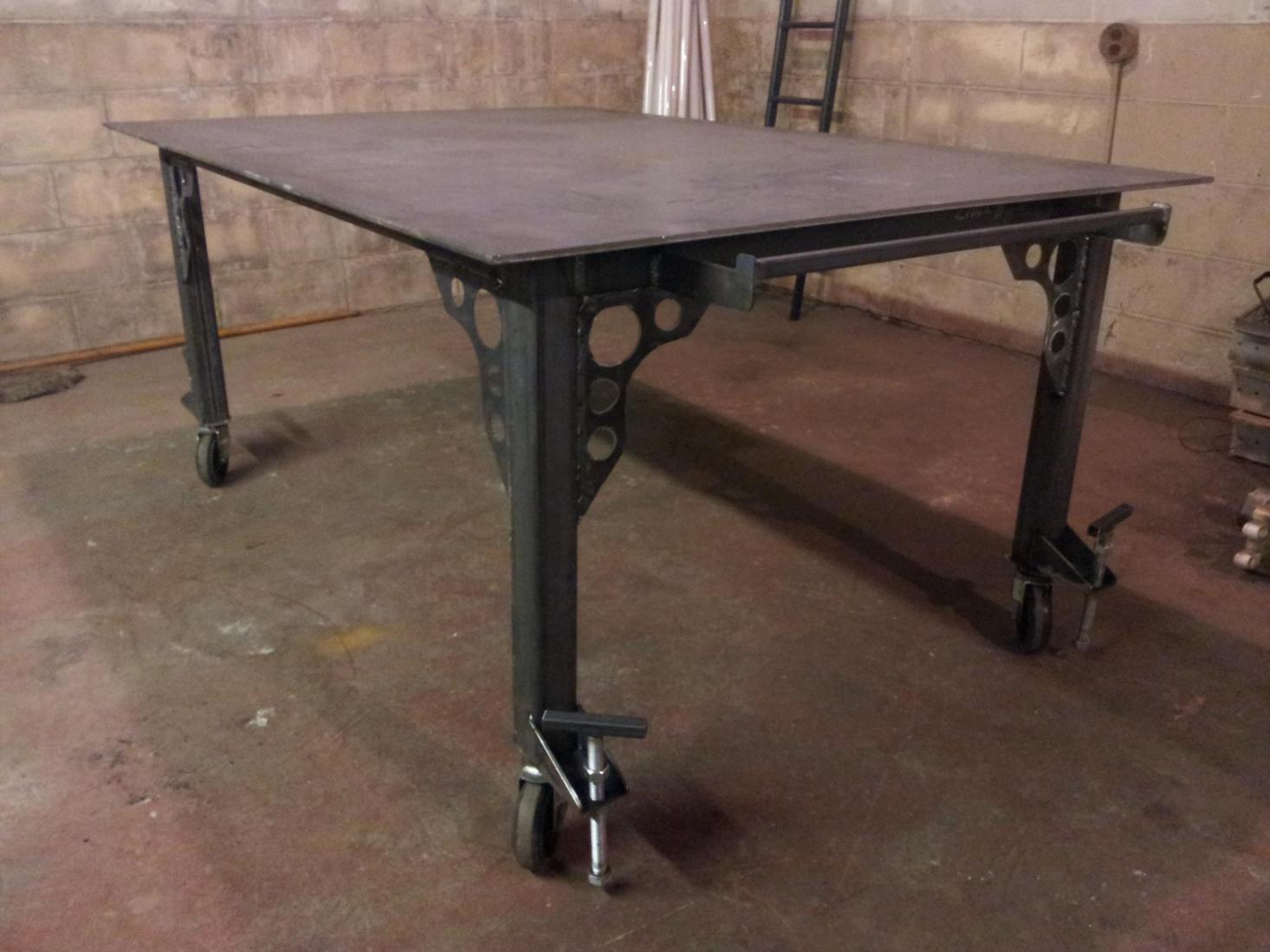

    Default New 4' x 6' Welding Table
    Top plate: 3/8th"
    Legs: 2.5" square 3/16th" wall
    Longer side rails: 2" square 1/8th" wall
    Short side rails: 2.5" square 3/16th" wall
    Gussets: 16 gauge (The gussets are really just for cosmetic reasons. This was plenty strong enough without them.)
    Leveling feet: 3/4" threaded rod, 3/16th plate for the mounting brackets, 3/4" square 16 gauge wall for the "T" handle
    Casters: HF 5" 300lbs (If they don't hold up I'll replace them. I didn't want to spend big dollars on casters if I didn't have to.)
    Handles/Clamp Rail: 3/16th plate for the brackets and 3/4" square tube 16 gauge wall for the rail.
    I still need to put a handle on the other side and cut and weld the other 4 gussets tomorrow. I may paint the frame too.
    What do you think? Click image for larger version.

    Nice table. I can't tell how far the handle sticks out, will it interfere with clamping to that side ?

    Nice table. Is it just me or does it look bigger than 4"x6"? Sorry couldn't help myself.
    Are the holes in the gussets decorative or for tool storage?

    Thanks for pointing out that I put inches instead of feet lol. Now I feel like a dumb #### lol. I guess that's why I should have went to be rather than posting when I'm dead tired lol. Someone please fix this so I don't look like a complete ### lol.
    As for the handle: Thanks for pointing this out. I won't be putting one on the other side as a result. I personally have deep clamps so it won't get in my way but it could get annoying if I have one on both sides. It sticks out 3.5". I honestly need the handle to make it easier to wheel around. I have a really long driveway and I will be using this to unload the steel when it's delivered and wheel it back into my shop without breaking my back anymore. My last order included that 3/8th plate and a full 4' x 8' sheet of 3/16th plate. That was not fun trying to move that with only a hand truck.
    As for the holes in the gussets: I guess I could hang stuff from them but it was done purely for cosmetic reasons.

    How do those 5" Harbor Freight casters roll with the weight of that table on them?
    They roll just fine right now. How long they will last is another story lol. Or how well they will do with a 300 or 400 pound piece of steel plate on it while I wheel it down my driveway into my shop is still up in the air. We'll see lol. I think they'll be ok though. HF is what it is. It's hit and miss. I've seen good reviews about these casters though.
