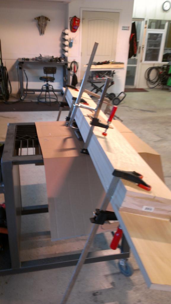

    I wanted a wood propeller but didn't want to pay for one so I decided to build one myself.
    I started out with 5 pieces of 1x8 @ 6' long and glued and clamped them overnight.

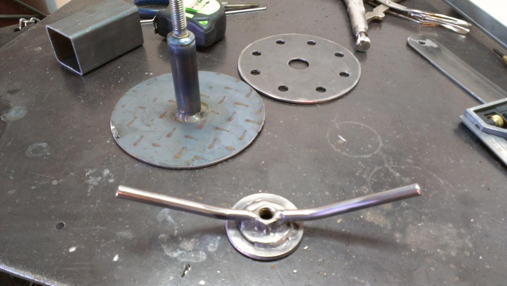

    Then I made a mount to hold the propeller while working on it.
    I used 1" tubing with a bolt welded to it and a nut with handles welded to it. The mount was welded to an adjustable small welding table I made to slide in the rails of my welding table.

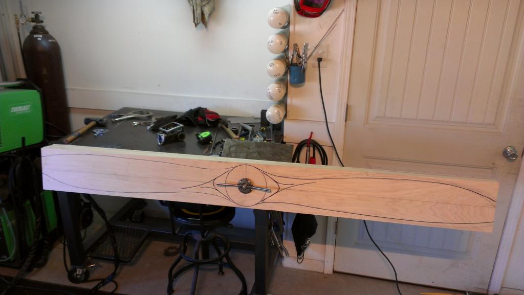

    Then I drew out the propeller on the wood and put it on the mount to cut the bulk of the wood off to get the shape.
    I used a sawzall with a 12" blade to cut the rough shape.

    Once I got it close with the sawzall.... I switched to a 4 1/2" grinder with some 60grit flap discs......you can't just tear into it, you need to "stroke" the wood so you don't gouge out huge valleys.
    After the flap disc, I went over it with 100 grit then 220 grit sandpaper.

    So how slow was the flap disc for sanding wood? Did you have to replace the discs a million of times? I never thought of using an angle grinder for shaping wood! I like the out of the box thinking on that one!
    A flap disc will eat through wood like crazy! I only used two discs. Yeah, the grinder was my best idea because it didn't take long to get the shape I wanted but it was tricky to make it smooth and not gouge the wood.
