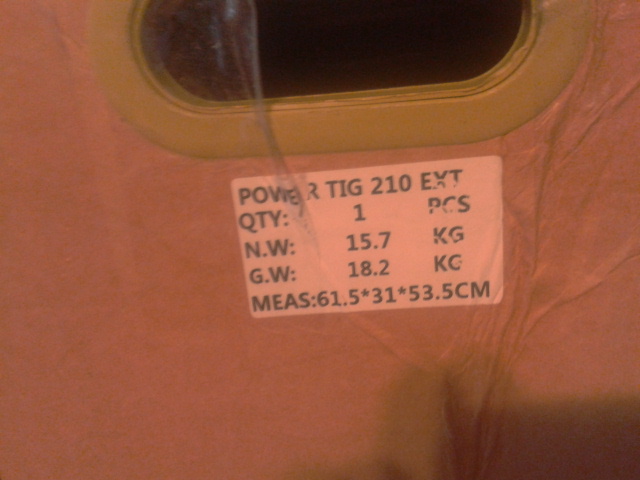

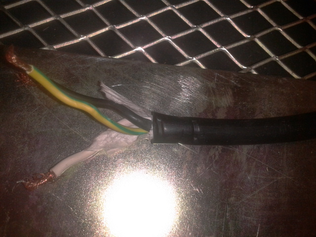

    Looks like I was Ripped off By Amazon / Everlast!
    Amazon listed the machine as new with all accessories (bundled), What came in was clearly a used machine, with several cosmetic scratches on the sides and top of the case, power cord has the markings of a plug being peviously installed (crimp marks, sloppy wire ends), and most disturming, only the Stick Stinger and ground clamp, loosely packed in the box. NO TORCH!, let alone no gas hose or regulator, or manual or anything else. Already invoked the Amazon Return/Refund process (did not trust them to send a replacement). I am wondering if Everlast is using Amazon as a dumping ground for used, machines, and Amazon is listing them as new. SHAME!.
    I will call Everalst sales line as soon as they open this morning, to see if they have an explanation or remedy, but my confidence is ready to go out the window.Click image for larger version.

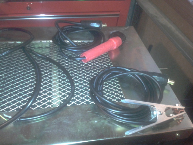

    Yeah, I hope that is was Amazon, and that I just got a previously returned item. Even though, I am dissapointed that Amazon would do that.
    I went ahead and put a plug on it, to see if it was alive or DOA, and it appears to power up fine, and I went through the options, really a nice setup.
    I looked at some unboxing videos of other everlast units (Could not find one for the 210), and it is definitely a repackaged item. Missing are the Pedal, torch, regulator, gas hose, and gas hose connectors. Not sure if the pedal is included in the kit, as the everlast web site indicates only the torch, not even the stinger, regulator or hoses. In all the factory packages, the extras are in another embedded box, and the unit is wrapped in plastic. Also the box itself is different. I think the scratches on the case are just from the ground clam and stinger bouncing around while UPS played Brown Ball with this thing. I'll probably at least wrap them in bubble wrap, to the damage is minimized if they do send this back for refurbushing.

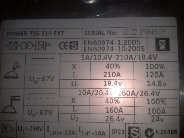

    Note the serial number in the photos, if someone else orders this model from Amazon, and gets this thing shipped to them, that will confirm that Amazon just turns it around.
    Aside from all this, it looks like a nicely designed unit, and the LED segments are quite readible. I guess the online videos just don't do them justice. It is extremely quiet, nothing even close to the 250EX in the videos, but if you want 60% duty cycle, I guess that is what it takes. Great idea for these thngs would be a fan on demand, ideally a variable speed fan on demand, so when you need it, it is there.

    Givenn that all I had with the unit was a stinger and a ground clamp, i tried to strike an arc, and it appears that I discovered the reason for the original return. IT DON'T WORK!
    Seemingly simple to set up for MMA (Stick), it just displays "EEE" on the amps out display when I attempt it. I verified all the hidden menu options are correct, and set the amps to 100. NADA. VERY FRUSTRATING!
    Was hoping that since it is a microprocessor unit, their would be a reset to factory defaults option, that is always good for s's and grins. There are'nt any real options on stick, so all I can guess is the unit can't sustain any current out. One last option, I am about to try is holding my tweeco connector in the dinse outlet, and trying to strike an arc on TIG. If you don't hear any updates from me, then it was a bad idea.

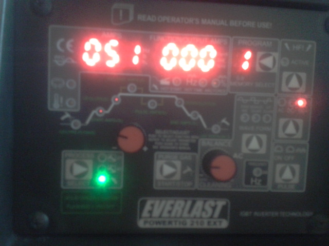

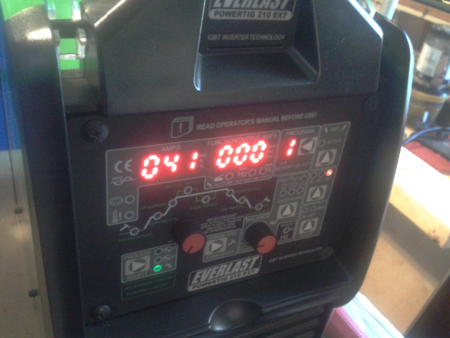

    I did get a chance to play with the menus, and got used to it already. It is actually intuitive, once you step back and look at the sequence. Also, the youtube videos distort the display due to photographic issues, and the segment display is fine.
    With this kind of support, i think Lincoln and Miller have a serious issue. the internals are all made in China, or mexico, and if they think that their customer service is the differentiator, they are disillusioned.
    In my experience, if the unit survives the first few days usage as burn in, it will keep working. I played with the Lincoln 205 and this unit appears to be a clone, at less than half the price.
    Earlier, I commented how the display looked really "funky" on most of the youtube reviews. Looked like a bunch of dots, vs a smoother LED segment display. Thought I would post a couple of shots here that show the display when looked at from a slight angle, as opposed to straight on. Still shows some flare in the photos, but looks fine in real life.
    Also, note that the upslope and start amps leds are glowing dimly. This is part of the issue with this specific machine, also, when going through the programming process, the welding amps LED never lights at all. I suspect this might be the root of the issue with this particular machine. (If this is a problem with this panel/control board, and it fails in the future, under warranty a new board is just 4 screws and a ribbon connector. Takes less than one minute to swap out (I cheated and peeked).
