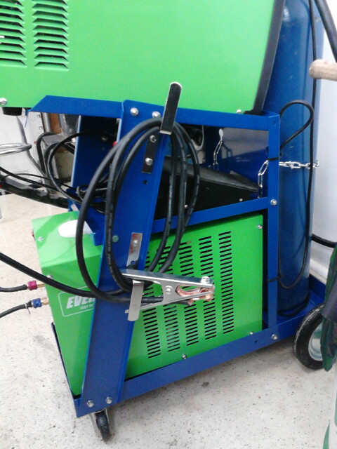

    I purchased a Harbor Freight welding cart the other day. Needed one for the new tig welder. I was not sure it would work but with a coupon it was only $25.00 dollars. It was well worth the money as it worked very well with some light modifications. You have to drill a few holes to make it work. The one photo shows the holes moved back one inch to allow the cooler to fit on the bottom shelf. Also had to cut out the back for the air that is exiting the water cooler. I also attached two hangers from Home Depot to hold the torch. I used both brackets that came with the cart on the other side to hold the ground clamp. Also had to drill new holes at the front of the middle shelf to make that work. The only thing I need to finish would be a 5 foot velcro strap for the Tig machine to keep it on the cart just in case.
