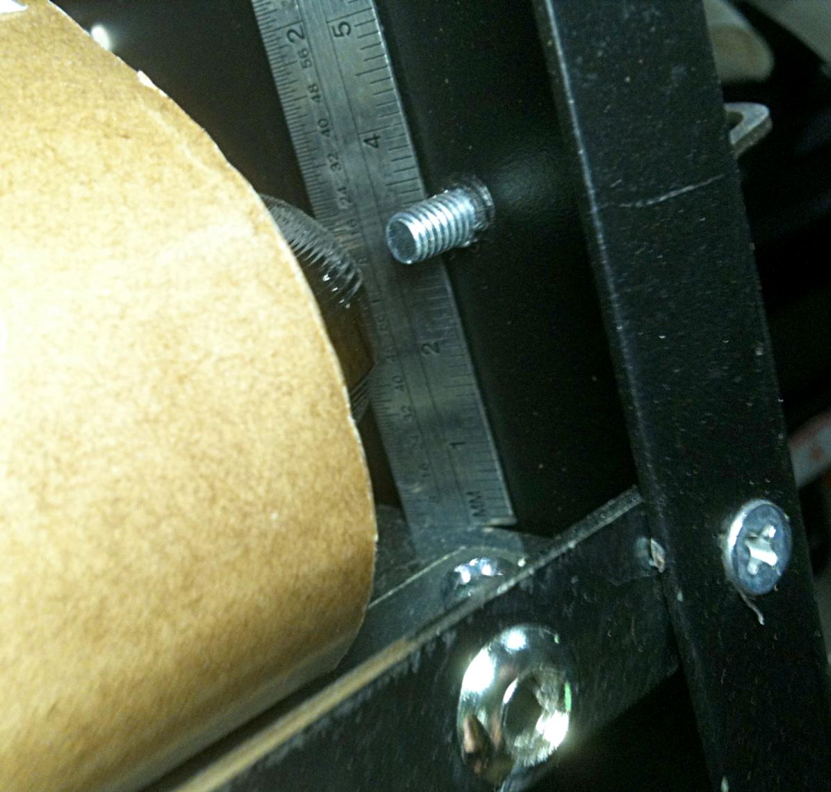

    Quote Originally Posted by halojumper View Post
    thanks for the heads up!
    due to your advice and others having issue with the HF gap, I decided to pull the cover off my unit and take a peek, just to make sure everything was okay.
    sure enough, the same clearance problem exists with the air regulator mount as last year (surely someone at Everlast knew about this?????)
    they could move both holes down about 1.5cm and be okay (or maybe move the transformer forward some?)
    the quickest fix would be to supply 2 shorter screws.
    Attachment 9789
    Attachment 9790
    Attachment 9791

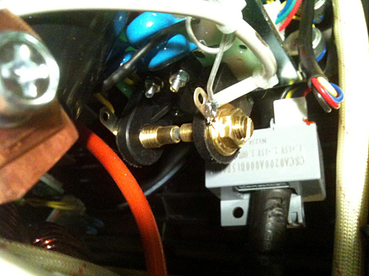

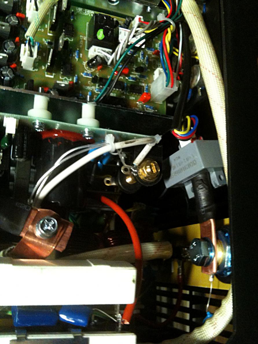

    The HF gap is new and improved quite a bit from what I've seen in other pictures... this one shouldn't move at all
    (located on the left side, front)
    Attachment 9792
    Attachment 9793
