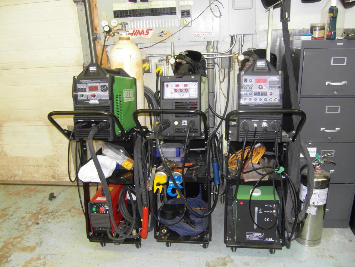

    I solved the dry air problem no loud compressor just put an high pressure argon welding tank full of 99.9% dry air from a SCUBA dive shop it last about two half hours of cutting for $15.00 you would use more than that in hydro(electricity).
Name:	air cylinder 3500 dry air.jpg
