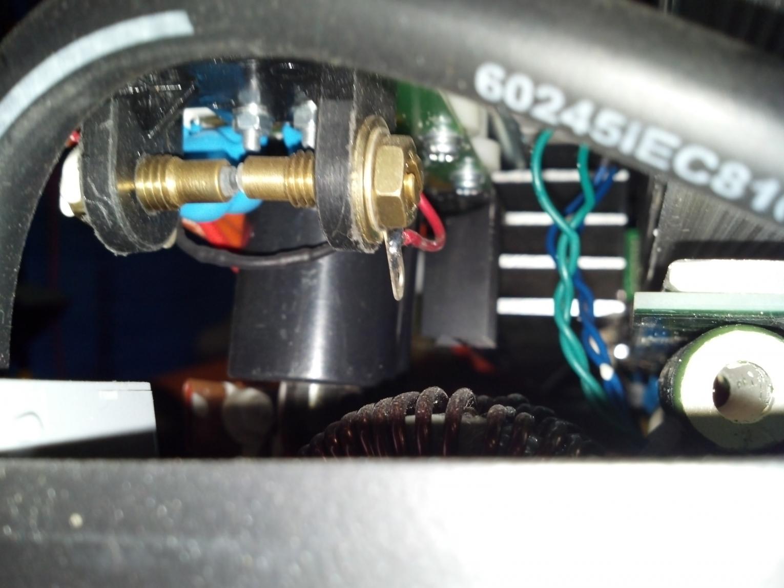

    I pulled the cover and checked the points. They were at .037" before, and I adjusted them to .030" just to see if it would change anything. It didn't. Still no HF. There were no signs of arcing or anything out of place inside except for a loose screw rolling around the bottom of the case. I hope it isn't from anything important...
    You have the new points that should last a long time between adjustments. Call the tech line and they will help diagnose the problem.

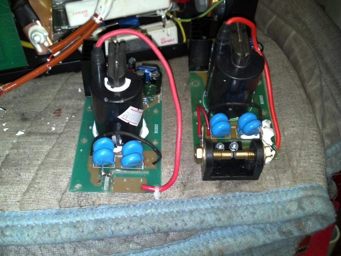

    OK, an update! The replacement HF circuit board Ray sent was delivered to someone in Wisconsin (I'm in Illinois), so he sent out a second one. It was a little over 2 weeks altogether, but it finally got here.
    When I opened it, I discovered it was the early style HF board with the stamped contact points, unlike the one in my machine with the new style points (threaded brass/carbon tipped). I modified the new board by installing my "old" new style points on it. Rewired, set points to .035, and installed the board. Works great! I hope this one out lasts the previous one. 9 months seems like a short life for such a necessary part.

    From what I have seen around here, that's a bit of a rarer failure. Used to be that on some machines one of the blue capacitors was sometimes a bit close to the points, and it would arc into it. That happened to me. But I doubt that could ever happen with those new points.
    Nice work!
    Actually, the good brass points on the right in the picture are the old ones. I removed them from the bad board and mounted them on the new board on the left that didn't come with them. I wasn't going to move backwards in quality. The blue capacitors were glued together so they couldn't move out of place. I thought that was odd when I saw it, but now it makes sense.

    Thanks for the great pictures. You've answered a few peoples question of what it would take to upgrade to the new style points. It's nice to know that it's basically the same board and looks like a pretty easy upgrade.
