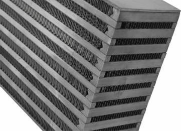

    I'm welding a charge cooler for my turbo bike.
    Note, when welding at 150 amps on an aircooled torch for a while, don't inadvertently bump the gas lens cup into a mounting tab. Kind of made it crack.

    150 amps seems like alot. How thick is the aluminum ?
    I am welding the end tanks onto the core. The core is a bit difficult to heat up and it is relatively massive on the edges. ~ .375" square or so on each edge.
    It is realistically closer to 120-130 amps after the weld gets going, but it is higher in the beginning.
    It's basically one of these:

    The welds are between the corners and formed / welded end caps made from .100-.125" thick sheetmetal.
    Show us some pics when you're done please.
