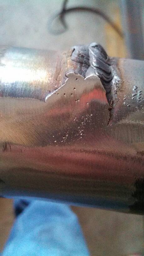

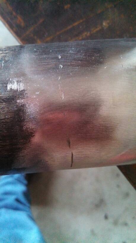

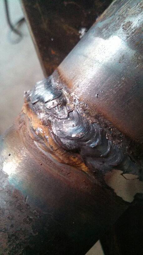

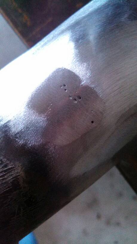

    Ok I was at welding school the other night and done my tig root hot pass and 7018 cap then cut it and bent it and it passed. Ever since then though I kept getting porosity on the cap. My rods were not stored in an oven and are a couple months old. I bought a oven that gets to around 250deg. Can I just put my rods in there and them be ok or do I need to bake them? Here are some pics. Running 3/32 rods at around 90 to 95 amps. I think I might be moving to fast also. I am keeping a really tight arc though (REALLY TIGHT). Is there such a thing as to tight of arc? The first pics are from the un heated rods and the last two are from ones stored in oven at school. Had one area of porosity still and some undercut.

    250 - 300 degrees is for storage, to recondition them you need 500 - 800 degrees for 1 or 2 hours depending on how wet/ damp they are, time to pull out the old grilled cheese electric cooker for those rods

    Overheating the joint can also cause porosity. To me it looks like you may be running a little too hot.
    Those pics look like you were shaking like a hooker in church! Welding pipe is not a race.
    Let the joint cool down between passes.
    I put old rods on a clean baking sheet and bake them for a couple hours at 450F.
    Then into my trusty home made rod warmer. Once the moisture is out of them
    it don't take much to keep it out.
    No Crack Too Tight, No Gap Too Wide. If You Don't Like The Way I Do It, I'll Let You Try It!
    Yes, you should rebake them. Use your home oven if you need to. A damp rod could possibly cause this issue, but I don't think so because you have one pass that looks better.
    A couple of things I see.
    1) You could have left the top pass or two off.
    2) Too long of an arc length, usually caused by trying to make a rod angle adjustment as you are coming around the pipe. This will almost always cause porosity.

    First if the rods were wet, look at the instructions on the rods. Many say they need to go to 600 deg F, but moisture on 7018 is more to prevent hydrogen cracking from what I remember.
    Starts, stops, and long arcing will be the biggest issue for porosity. It is best to grind or file the starts and stops out. Also, you need to watch your start and stops to ensure they are staggered so large clumps of porosity do not build up.
    If you notice that you are long arcing, I would just assume that there is porosity and grind it out.
    Also watch your slag as it looks like it can be cleaned off better and if previous passes had slag left behind this could also show up in a bend test.
