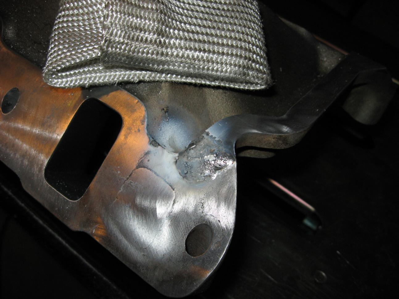

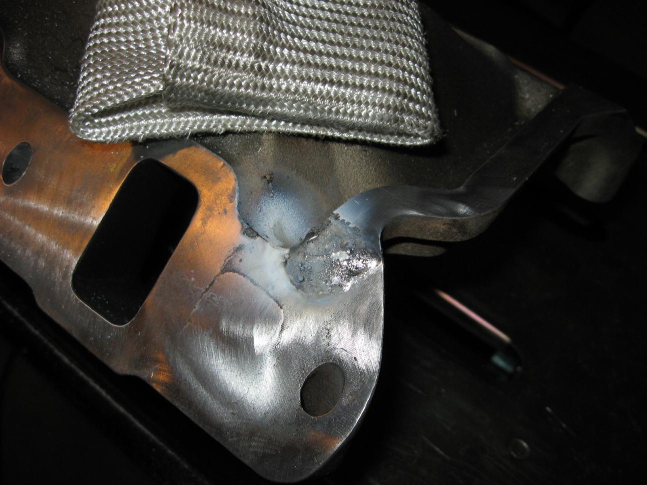

    I got that powdery stuff too when doing an aluminum manifold repair a few weeks ago.Click image for larger version.
ID:	10048 I'm not sure what causes it but there was all kinds of crap cooking out of that manifold and it was a p.i.t.a.

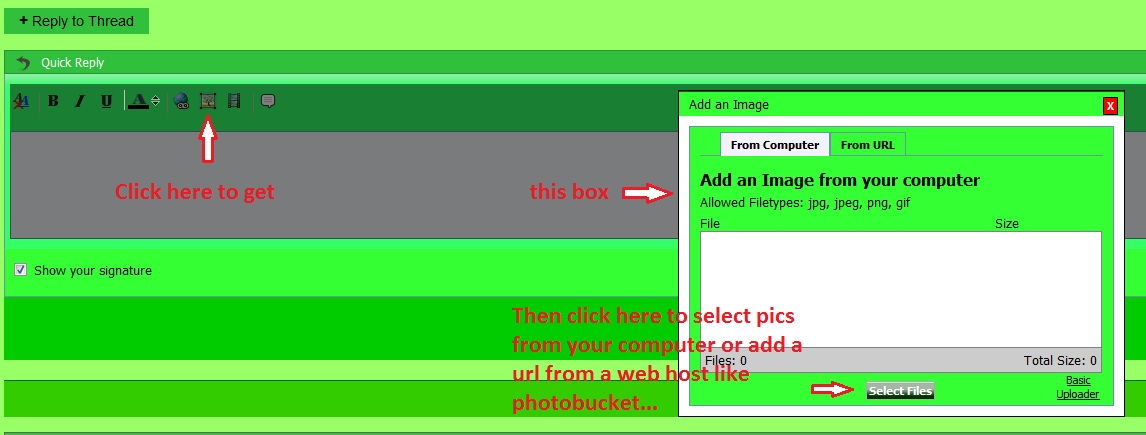

    Uploading pics directly from your computer is the best way, using the forum tool. Click image for larger version.
ID:	10049 If you have the pics on your desktop, it will be simple to find them with the uploader. You can highlight a group of pictures and choose them rather than one at a time. If you need help, please ask in this > http://www.everlastgenerators.com/fo...s-to-the-forum thread so that others may benefit.
