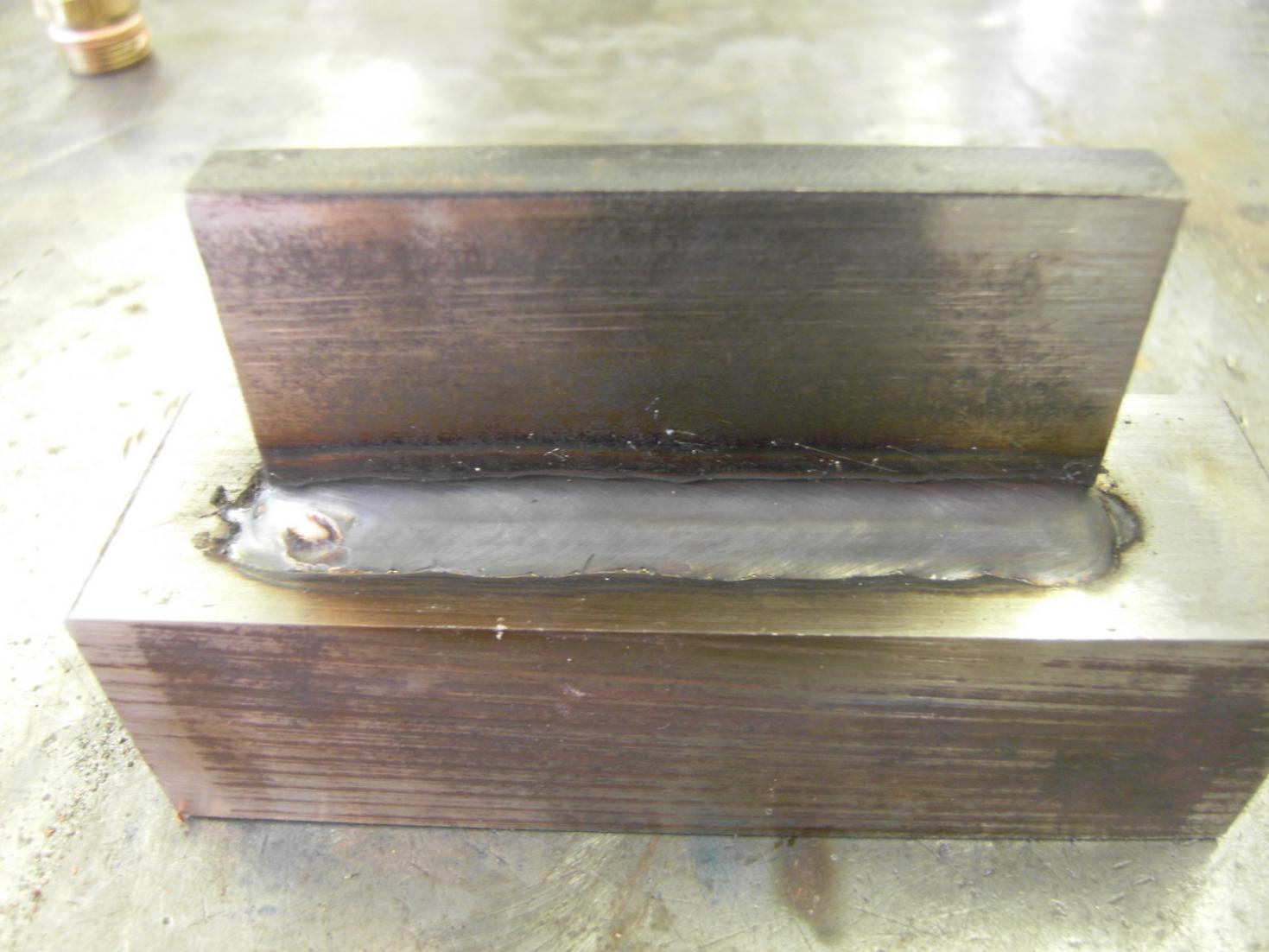

    I tried 98% Argon/2% O2 for Spray Arc Transfer on steel it worked OK but with a little adjustment I got 75% Argon 25% co2 to work just fine, 80% Argon 20% Co2 I could not find any different for the price. I set the MTS250S to SYN Mig 24.0V 200A SYN to Steel and wire to .035 wire was S-6. And welded .375 plate to 1.5 X 1.5 bar. Good grinder is nice with different disc hard and soft.
Name:	spray weld .035.jpg
