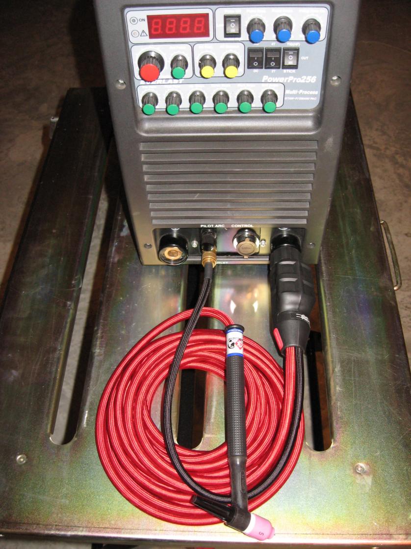

    Mine... Click image for larger version.

    Hey Zoama, it seems that some safeloc DINSE come with a short argon hose while others have a 6' hose, both with QD fittings. Do you know the portion of the part number that specifies that?
    I cut the one in my pic and put the Everlast fitting on it. I talked with Sjon Delmore at CK about the proper length gas line for Everlast machines and he agreed to make them 18" but since then several people have gotten 6' ones.
    I'm sure by now that Oleg has got Sjon to come up with a better suffix for everlast than the previously used "LG". In any event the gas line now comes with a qc that has a screw collar to secure it, so shortening the hose takes about 30 seconds.
