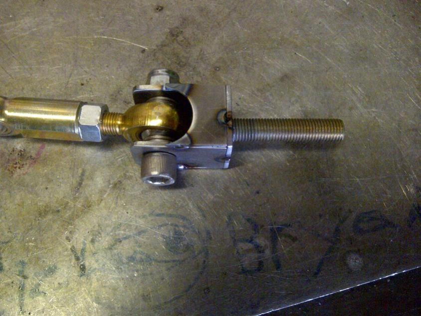

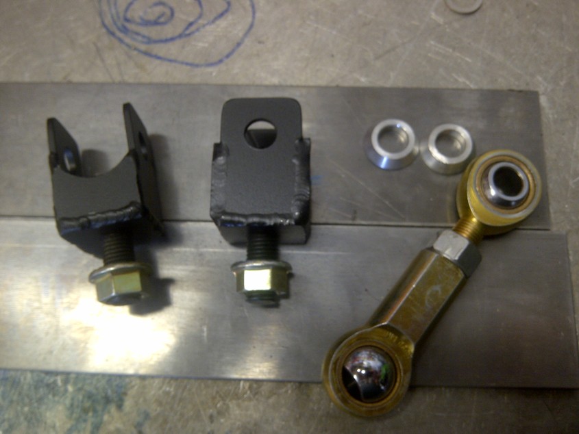

    Small and not particularly cool or fast, but hey, it's On Road Fabrication! I made up some control arm mounts for some 3/8" front anti-roll bar links. These are cut from 0.090 CrMo sheet.

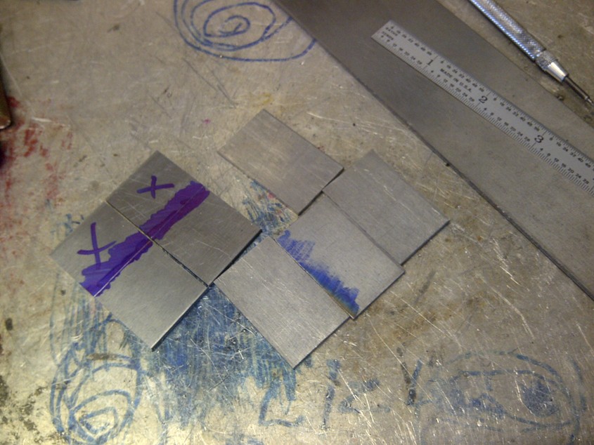

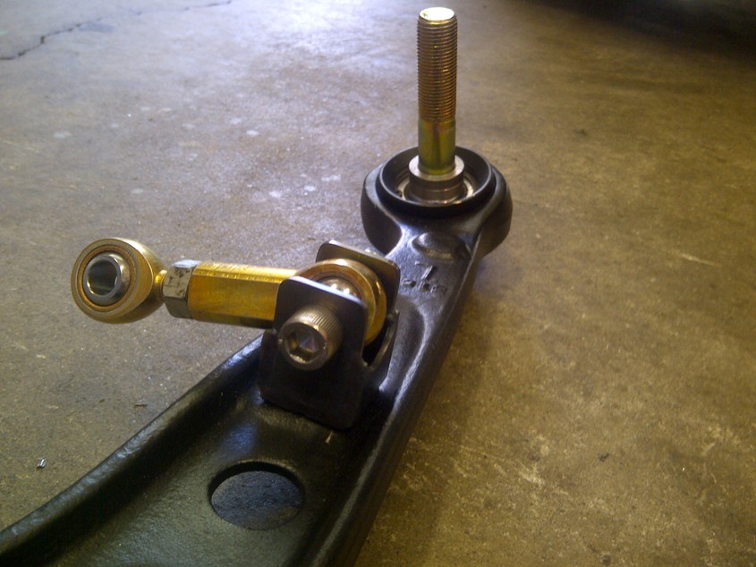

    I tacked a bolt through the bottom plate as a mounting stud, then mocked up and tacked up.

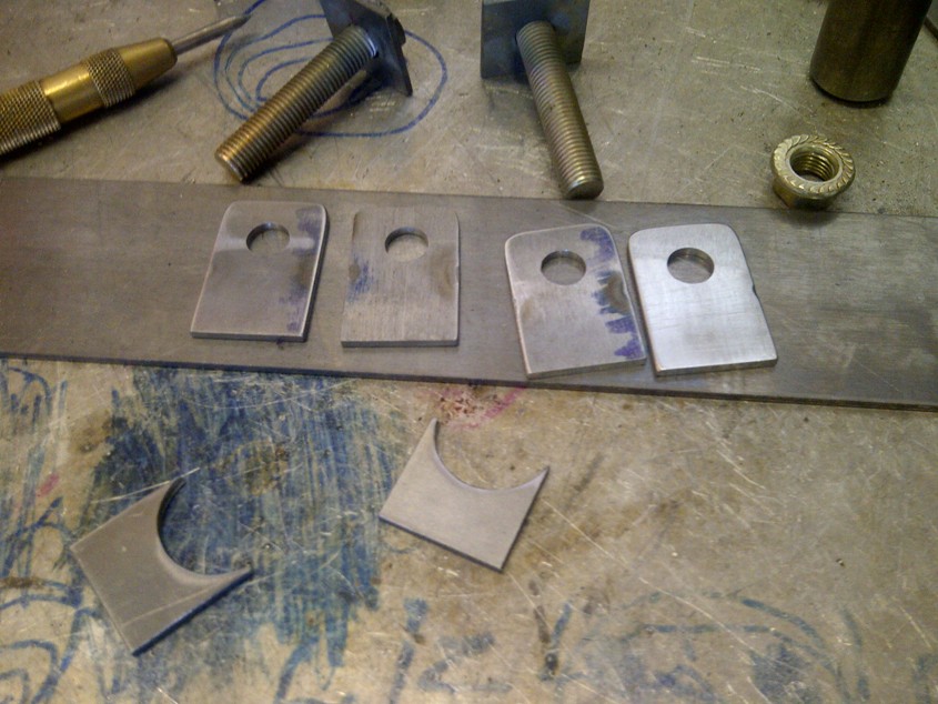

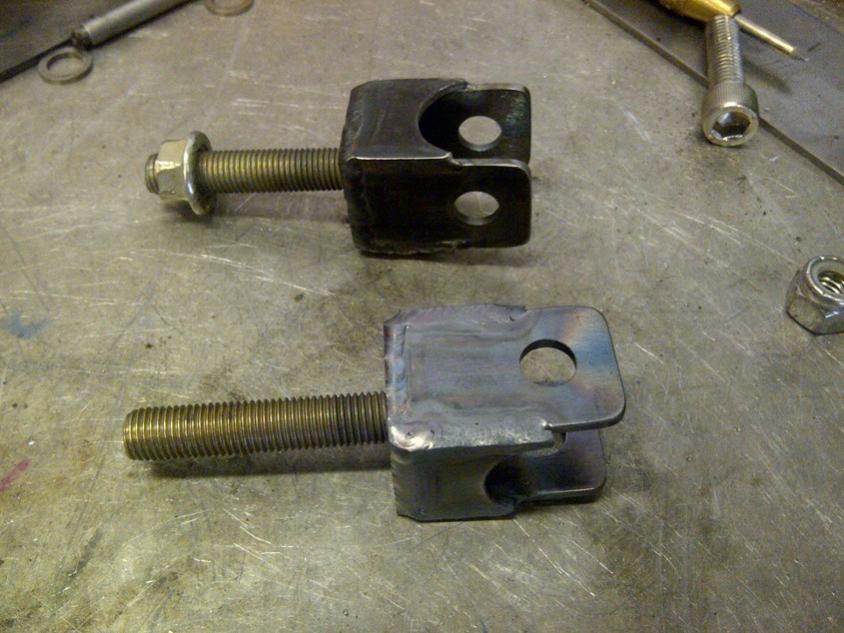

    After welding them up, I cut the studs down to length and added a quick coat of Krylon.

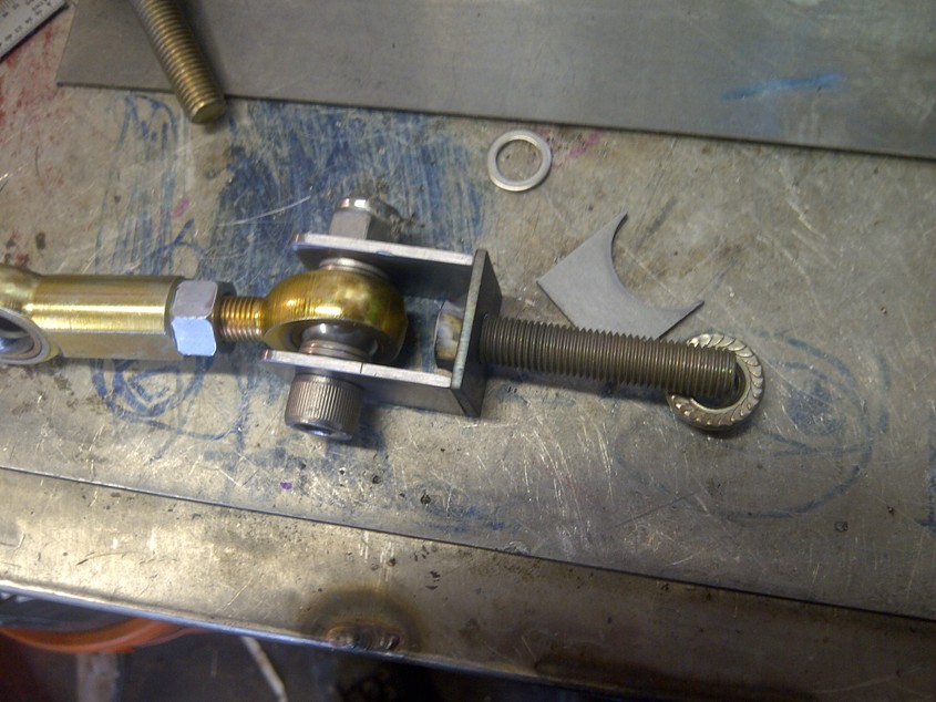

    Here's a shot of the mounted configuration:

    Turned out real nice, well done. Can I ask, what are you using to cut the half circles out of the end in picture 2 of 4? Those are some clean cuts.
    Just a hole saw and then dressed them with a sanding roll. I put a 7/8" hole in the center of a 1x2 piece then cut it in half to make two parts.
    Nice, I like the adjustability that they have and that will have some positive effects. Should be nice and stiff without any rubber bushings too. I changed my factory rubber bushings to poly inserts.
    Preload is bad, so adjustability is a must. The purpose of this was actually to relocate the mounts inboard and reduce the effective rate of the bar.
