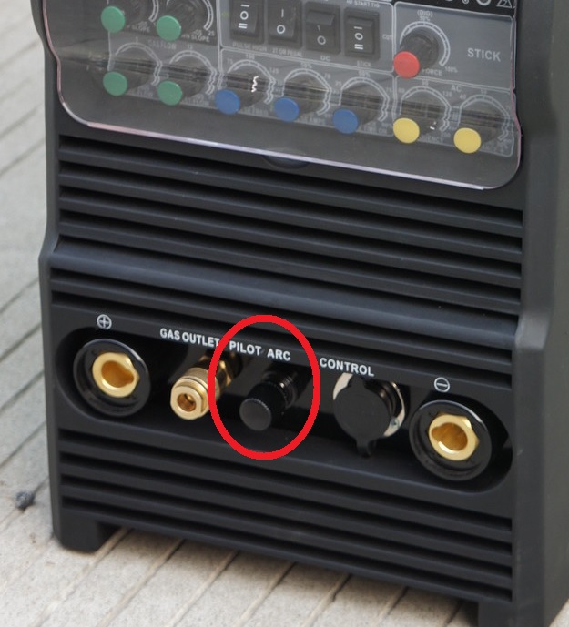

    Hi all I have a brand new power pro 205s and the plasma gun has a wire with a small eyelet at end where the gun connects to unit and the manual doesn't show where this would connect so if anyone can help I would appreciate it.
    Pilot arc wire. You should connect it to the little knob with the knurled edges on it. It unscrews.
    I completed an updated manual of that unit before the manual was posted, and was supposed to have that correction in it, but apparently the webmasters put up the wrong version that doesn't show the wire and connection.
    Unscrew the plastic knob. Click image for larger version.
    Thx guys got machine hooked up and made some test cuts on 3"x3"x1/4" angle and everything is good very nice operation smooth and just blew through that metal with ease.
    Thx again.
