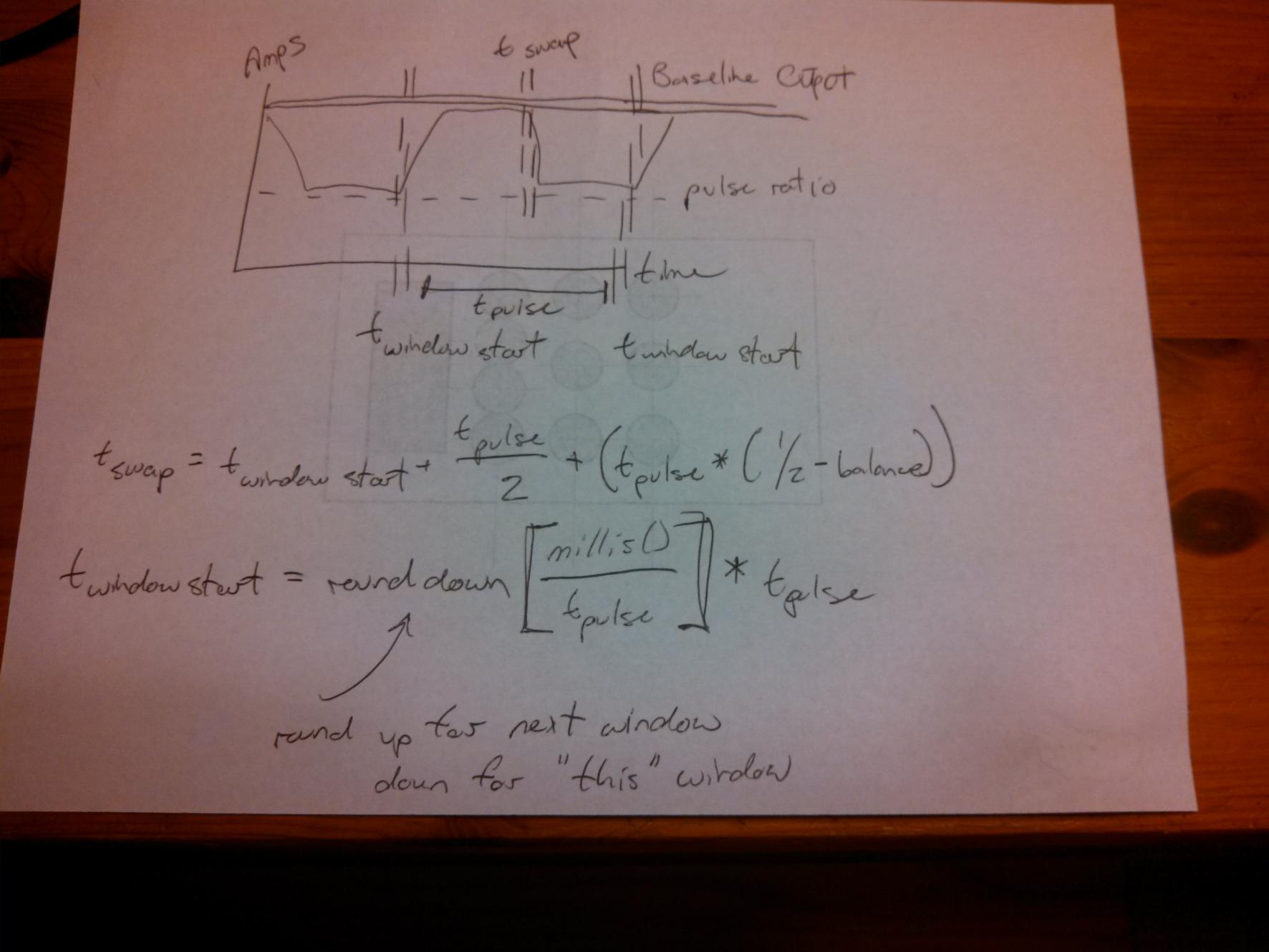

I sat down tonight and started working on the code that manipulates the welder's output when actually welding. If pulse was ignored, this would be pretty straightforward, but with pulse in the picture, it gets a lot more complicated. Certainly, one way to handle it would be to write separate routines--one for welding with pulse and one for welding without--but that gets pretty complicated pretty fast. One for pulse in 2T; one for pulse in 4T; one for pulse with pedal control. Etc... I wanted to come up with a single routine that handled welding output, regardless of other parameters. It's absolutely possible to come up with a Grand Unified Algorithm of welder output, and to then create cases like plain old 2T by setting some parameters to zero and having them drop out.
I think I made a big leap towards cracking it with this information--the Rosetta Stone of coding pulse, at least for me.

Once I get the main welding algorithm debugged, which will include the pulse functionality, that will actually be a huge step towards completing the unit. I still need to do some tweaking on the user interface (lighting up LEDs when buttons are pressed); I still need to implement the multiplexer chip so that I can actually read all the inputs at once; and I would like to try out the "transistor plus fixed resistor equals digital pot" trick to see if it works. Short of wiring everything up and putting it in a box, those are the last main steps until I have something that I can call an alpha product. All in all, not bad for... what is it, a week's work?
I'm really psyched to profile my pulse algorithm to see what the lower limit on pulsing frequency would be. At some point, the code itself is the limitation. So far, all of my output involves using the serial interface for debugging, which introduces a lot of delay.
