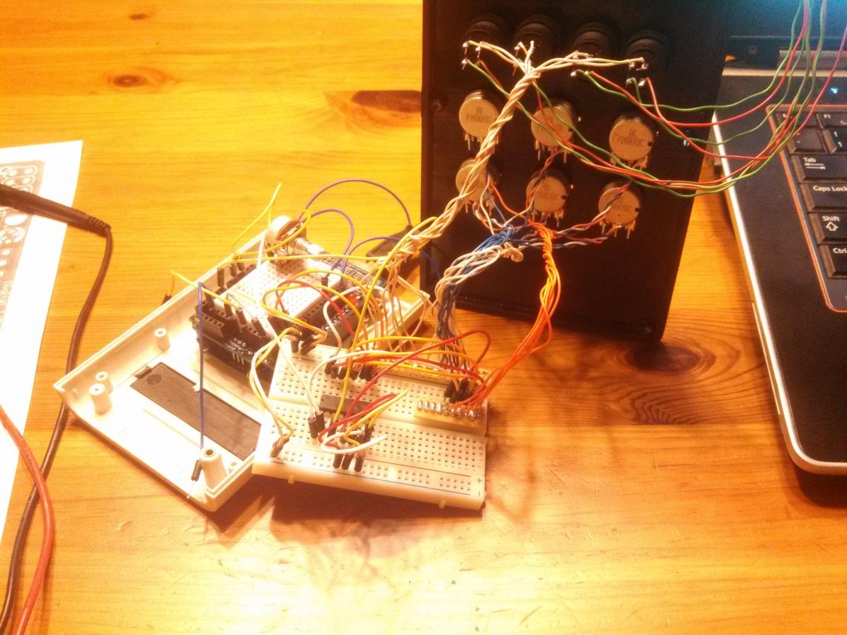

    Nothing to show, but a small update anyway. I have integrated the analog mux chip into the code. It was actually shockingly easy, because there is a library out there for the chip that means you can use the exact same function call that you use to read from the Arduino's in-built pins. Instead of typing, "analogRead(pinNum)", you type "analogMux.analogRead(pinNum)", where analogMux is an object from the library that you have instantiated. Anyway, the upshot is that all I had to do was search-and-replace "analogRead" with "analogMux.analogRead" in the appropriate places, and I was good to go. Took like five minutes. It took longer to wire up the chip than it did to change the code.
    BTW, speaking of wiring up the chip. This was my opportunity to learn what the difference between Vcc and Vee is. Both were labeled as "power supply" in the data sheet, so I hooked them both up to 5v. Whoops. Sorry. Vee is supposed to be ground in a 0-5v system, which meant I created a dead short between +5v and ground. The chips got hot, but I noticed that something wasn't right (bus voltage dropped from +5v to around +4v) and unplugged things before anything fried. Fortunately, I was feeding the chip straight off the Arduino's power rail, instead of off of a data pin. The power rail can supply up to, I think it is, 250 mA, while the individual data pins can only provide 40 mA. I blew the fuse in my multimeter measuring the current draw, so it was over 250 mA, but it wasn't enough to fry the Arduino, for which I'm glad.
    I have been working on debugging the pulse algorithm, which, as you might expect, is taking some effort. Not extraordinary effort, but just figuring out all the places where things aren't working like I'm expecting them to. Now that I have the analog mux chip integrated, I can hook up all of the input pots and actually use them to twiddle with the parameters for the box, which is nice. Pretty soon, it will be time to start putting things on a board, in a box, and actually hooking up the real pedal and torch, instead of using a bread-board pot and switch.
    One main thing outstanding is to test the feasibility of using a transistor to modulate a parallel resistor to simulate a digital pot. I bought some BJT transistors and am working out the wiring, but it's not as straightforward as I would have hoped. Someone suggested that a FET would be a better choice for my purposes, and as long as I was ordering more things, I ordered a couple analog switch ICs and some solid-state relay ICs too. I think the solid-state relay ICs will have too slow a switch time to use with the Arduino's PWM output (I think it's about 490 Hz on all but the Arduino Mega), but the FET and analog switch IC should have more than enough bandwidth to handle it. Meanwhile, I continue to poke at the BJT just on the principle of experimentation and learning.
    You might think this is funny: I soldered the common leads of the pots to a bus connector and put pins on it, to make a jury-rigged connector that I could plug into a header on the board. This will allow me to take the faceplate of the box off if I need to get at the internals. When I soldered up the potentiometer leads, I accidentally wired all the pots up backwards, so that increasing output is counter-clockwise and decreasing output is clockwise. At this point, I have zero interest in rewiring them, and this is a protoype anyway, right, so who cares? Right?! Anyway, it's pretty amusing.

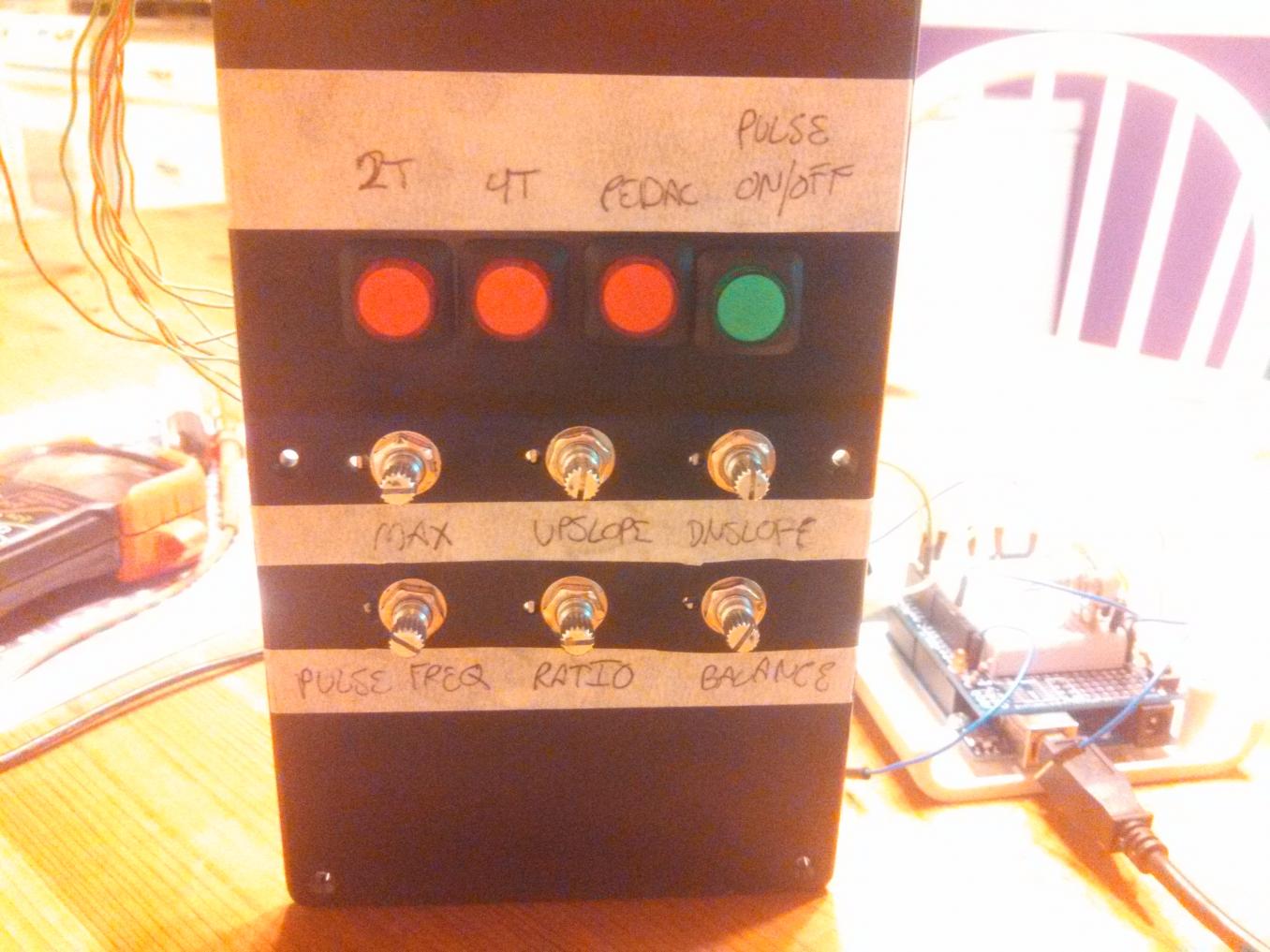

    Here are a couple photos of the project as it currently stands.

    The reason that there is a "pedal" button, in addition to 2T and 4T, is that I want to be able to leave the pedal plugged into the box and select welding mode purely through the box. The way the welder detects the pedal is that pins 6 and 7 in the connector are shorted together. This tells the welder that it should take its output from the pedal pot instead of the panel pot. So what I can do is put a relay or transistor between those pins and, if the box is powered up, I can connect those pins and the welder will take its output from the box. If the box is powered down, the pins open up and the welder works as if the pedal/box were not attached at all. Through the buttons on the box, I can choose between fixed-output 2T (2T button), pedal-controlled 2T (pedal button), and 4T (4T button--duh) operation without having to un-plug anything. I have considered putting two remote receptacles on the box and plugging in both the torch and the pedal at the same time, so that I never have to un-plug anything at all, but for now, I'm keeping things simple. Having both the torch and pedal plugged in at the same time would add some complexity to the code, and I don't think the benefit of not having to un-plug the pedal and plug in the torch, or vice versa, is worth it.
    So if I want to stick weld, for example, I don't need to unplug the pedal or the box, I just power down the box and the welder registers the pedal as disconnected. Or if I am TIG welding and I want to do fixed-output 2T mode--for example, for tacking up or something, where I don't want to move the pedal around every time I move to do another tack--I don't have to unplug the pedal to give control back to the welder panel dial. I just hit "2T" mode and BAM it's done.

    Sounds like it's coming along. No pictures, though. Don't forget to include the original intent of being able to have the pedal only give a limited current, with full travel.
  7. #67
    Photos fixed. No worries on the max output setting. It's already implemented and working perfectly.
