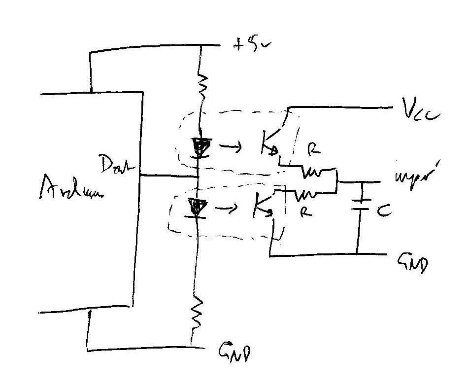

1) EPOT no bueno. Can't find one that actually meets my specs, specifically the necessary impedance. Basically, they only come in 10k, 50k, and 100k impedance. Yes, there are some others, but they have other problems that are deal-breakers.
2) DAC: I hadn't thought that they would work because, to achieve galvanic isolation, I would need one that could run off the 2.7 volts the welder is supplying on pin 5, but actually it turns out that those exist. Mildly annoying that they're SOT23 form factor, so I would need a breakout. Also would cost me an additional digital output pin to run I2C, but altogether not out of the question. Will keep it in mind. Only problem would be if I wanted to transition the circuit to a welder with a signal voltage of < 2.7 volts or > 5 volts, then the DAC would be sad.
3) My current approach is to build the attached circuit. Easy galvanic isolation. Works exactly like a PWM-controlled potentiometer. Only challenge is to design a filter such that the PWM signal is eliminated while not producing excessive ripple. Given that there are as many as three orders of magnitude between the PWM signal (max frequency about 32 kHz) and my desired signal (pulse rate 30 Hz), I think this should really be doable. Only challenge there is the maximum bandwidth of the optical isolators. PWM frequency cannot exceed that. Still, I think a middle ground can probably be found.
That circuit will still be overlaid with your PWM switching frequency. Filtering it out from that type of voltage divider will not be as easy to still keep your pulses somewhat crisp. I would say you might be up to a 3rd or 4th order lowpass filter, to get something clean. I can't remember if your pedal was the 22K version or the more standard 47K version. If it's the 47K, a 50K E2POT with 100 steps ought to work fine. I believe Mike or Mark mentioned that the SSC pedal for Everlast uses a 50K pot, as well.
Sorry to say it's the 22k pot. I'm half tempted to just crank the PWM frequency and let the opto-isolators' rolloff do the filtering. The Arduino can do... I don't remember the max, but it's like 32 or 64 kHz PWM I think. If I need to, I can get a high bandwidth isolator with a built in amp, but they're expensive.
Well with a little code and the right circuit you could cascade two 10K pots, for a 20K or parallel two 50K for a 25K. I would think either would be close enough for what you are doing. The opto-couplers will still let through frequencies higher than what I think you want. but give it a go. Have you got a scope to see what is going on? At the frequencies you are using, even a PC soundcard based O-scope program might be adequate.
You're right. It's just not the direction I've gone. I still have hopes of being able to run the pot with a single output line. There is a lot to be said, though, for a stable output (vs. PWM). One thing that could help is, the Arduino uses digital pins 0/1 for its serial output, so you can't use them at the same time that you're using serial for debugging. But after you're done debugging, or if you're not using serial, they're fair game. So I could use those two pins for I2C interface to a digital pot (assuming I can find one, vs. SPI), and then have a preprocessor directive that just turns off the actual output if I'm using serial to debug.
Ah, but the challenge there is that with I2C, you send an address byte and a a data byte for every command. So that's 16 bits per sample. Which means I would have to drop my sampling rate way down to bring it to a level that the optical couplers could handle. Whereas if I'm sending a PWM signal through the optical couplers, I can potentially just blast away and not care about the frequency rolloff, because the HF signal doesn't really matter anyway.

Sure, sure. So fine, add a low-pass filter with a 100 Hz cutoff frequency after the optical couplers' rolloff. I guess all I'm saying is, the frequency response of the optical couplers seems like it's just going to help me, unless the rolloff in the upper frequencies causes undesirable corruption of the LF component. Still, intuitively, it seems like if the -3 dB point of the optical couplers is around 4 kHz, and my desired signal is around 1-3 kHz, and my PWM signal is up at 32 kHz... seems like things should be fine.The opto-couplers will still let through frequencies higher than what I think you want. but give it a go.

I got around to building and testing the "digital potentiometer" circuit that I posted a couple posts back. This is the closest I've come so far to getting the performance that I want. I ended up using a capacitor value of 100 nF, which when combined with an 11k resistor, gives a cutoff frequency of 144 Hz. I expected that, the higher the PWM frequency I used, the better filtering I would get, but I couldn't predict the effect of exceeding the cutoff frequency of the optoisolators.
What I found was that, at PWM frequency 31 kHz (divisor = 1), there was almost no resolution at the top or bottom of the welder's output range. The welder basically stayed at zero until about halfway through the pedal's travel, then the welder jumped to about 45 amps, scrolled quickly through about 55, then jumped to 96 amps (100% output) and stayed there.
At PWM frequency 3.9 kHz, I was able to achieve sub 1-amp output over almost the welder's entire range, but the output skipped from about 80 amps straight to 96 amps.
Best results were obtained at PWM frequency 1 kHz. Output still skipped from about 85 amps straight to 96 amps, but response was excellent throughout the rest of the pedal's travel. Performance was worse with fast-PWM compared to phase-correct PWM.
At lower PWM frequencies, the welder did not register the signal properly, most likely due to lack of smoothing.
I'm guessing that the "skipping" of the welder's output at high PWM frequencies may be due to the cutoff frequency of the optoisolators. At very low PWM values, the signal turns on/off very fast, and likewise at very high PWM values. Perhaps the optoisolator is not achieving full on/off state and is simply misisng the pulses? Whereas in the middle of the range, the rising and falling edges of the signal are most evenly spaced, so the optoisolator is given the biggest window to turn fully on/off.
Or, heck... maybe some other dynamic is occurring entirely. I'm not sure what direction to go from here. I really want to see proper full-range output. One direction to go would be high-speed optoisolators, but that would run about $8 each, and I would need two.

I can, but it won't address the issue. The lowest PWM frequency that is still smoothed enough to be read by the welder still has the "skip" issue. And I want to keep the PWM frequency high enough to implement pulsing. I have some suggestions to help improve the responsiveness of the optoisolators and I'm going to continue to explore.
None. I used the circuit attached to post #123.What Digital pot did you go with?
If you go back to the pot idea 47K pot and 47K R across will get you 23K range.

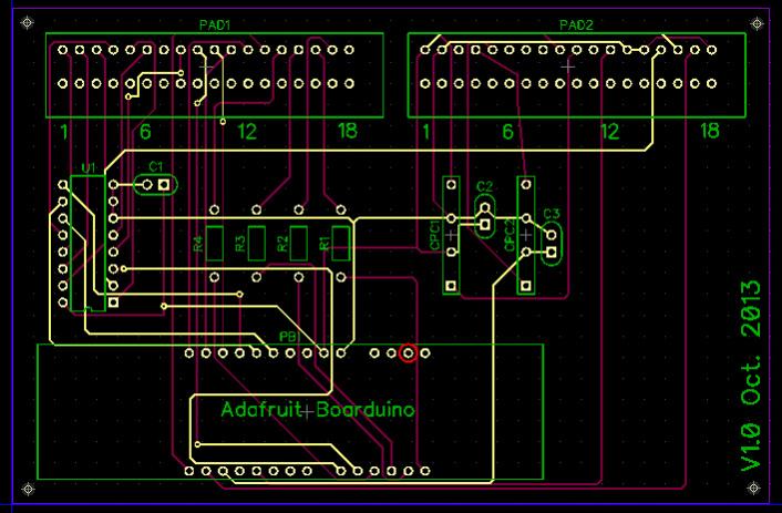

While I have time to kill, I've also been working on building up a schematic for the project, and playing around with converting it to PCB. Some of y'all will get a kick out of this:
It's my first PCB, so go easy! I'm sure it leaves a lot of room to improve. BTW, this does NOT include the welder interface circuit, so it's incomplete. Just playing around with PCB layout is all.
If you are really planning on making a PCB for this, you might as well just get the bare AVR chip for it. By doing that you can also get one with enough ADCs to handle your project. Something like the 20MHz ATMEGA328P-PN. You can get them with the Arduino bootloader pre-programmed, so you don't need a stand alone programmer. And if you feel like going SMD you can up your pin count so you have plenty of I/O. Terminal blocks or even just pin headers are a good idea, for sure. It's always a pain to have a board hard wired to the front panel. I try to remember to cannibalize all the nice plugs and headers from any electronic junk, like old PCs, before I toss them.
What capture software are you using? And I agree on the bare chips as well.
Using DipTrace. I tried Eagle, but gosh it's really clunky to use. I still have Eagle installed, because DipTrace comes with an Eagle script that exports to a format that DipTrace can import, and darn near anything is available as an Eagle file.
I agree about the bare chips. For now, I'm using the Boarduino on headers because I'm sure my first Rev of the board won't be my last, and I want to be able to reuse components easily. What I'd love to do is just drop the existing PCB for the board into my design. I have the file, after all... It may be worthwhile to go with one of the SMD based Arduinos, like the Pro Mini, and just use its PCB like a breakout board. You can get Pro Minis off eBay from China for like $5 a piece. The Boarduino is based on a through hole chip, so it takes more space, but could easily be integrated directly into my PCB. The kit is $17 with PCB, and I don't know if it's even sold without, but it'd be easy to buy the components separately. Lots of options...
DipTrace is way better than Eagle for sure, you might also look at KiCAD, it's open source and has a number of nice features. Word is that there will soon be a free or low cost version of Altium Designer, too. For something that simple, hand soldering SMDs are pretty easy as well. Especially if you are going to spin up your own board design, as you can tweak the footprints like a Schmartboard.
My very-brief impression of KiCAD is that it's still up-and-coming, and some important features have yet to be developed fully. However, the minute I start running into the free version of DipTrace's limits, I'm going to think hard about other options. I think free DipTrace is limited to 300 pins total, which is plenty for my project, but when I dropped the Boarduino PCB into the project, and then accidentally clicked twice to drop a second one in, that exceeded the limit. And the Boarduino isn't particularly pin-heavy.
What's y'all's opinion on autorouters? I tried routing the board by hand, but about a quarter of the way through, I ran into a situation where I had painted myself into a corner and couldn't reach a pin, even with vias.

Autorouters are mostly bogus, unless you have a real standard design and have populated all the design rules. For an 8 layer board they are worth the trouble to configure, but not for something like a two layer. Routing is as much art as science. When looking at your first board I was thinking that you could have probably gone with a single layer, if you played with it some more. It does take time, but after a while you will begin to see patterns and find it gets easier. Look at other designs for inspiration.
