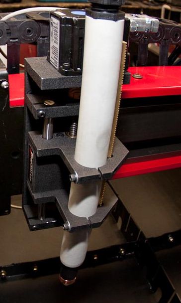

    Is this what you are talking about? Without a pinion and a clamp release, it doesn't lend itself to adjustment. However, the Z axis drive should allow on the fly height adjustment, no problem, just not as much range.

    Yes that is exactly what I'm talking about, however I don't have the avhc on mine but the machine torch holder that TM sells has a pinion gear with an adjustment know to move the torch up and down while traveling, it also has a clamp to hold the torch tight in whatever position ( up and down ) you set it in. And I've called TM and they said all the Lincoln, hypertherm... Etc come with them on there torches and I'd have to get ahold of them to find out. I just wish it was as easy as the torches coming equipped with one. I will check out McMaster and see what is available..

    Now I got ya. Yeah without a Z, the hand adjust would be nice to have. Check with Lincoln, Miller, Hypertherm to see if you can order it as a part. Or McMaster, but you might not know what pitch or pressure angle you need. I would guess even if Trafimet had one it would probably be metric. Such is life.
