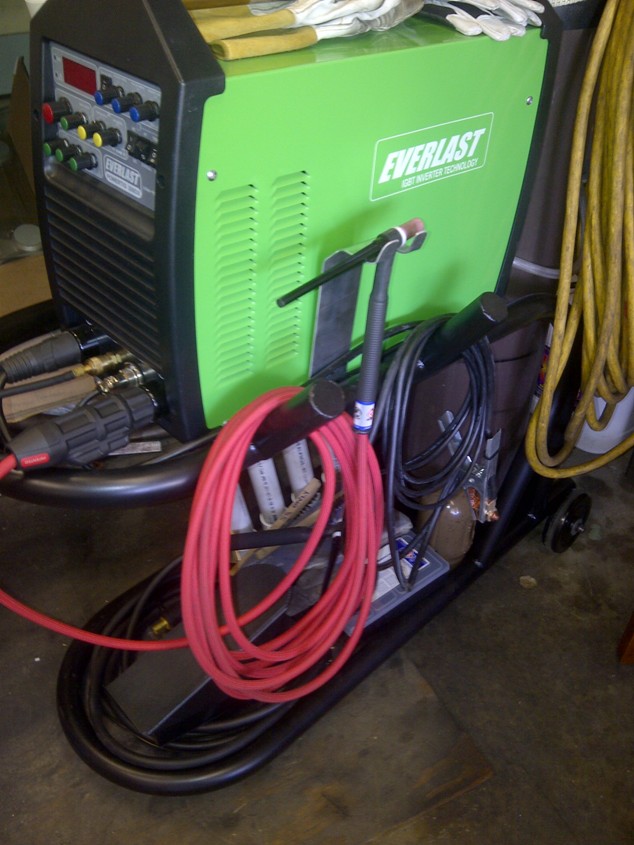

    I made this to hold my torches one mount to the cart and one on a magnet mount to use on the bench or were I am welding.
    That looks much safer than just letting the torch dangle. Thanks.

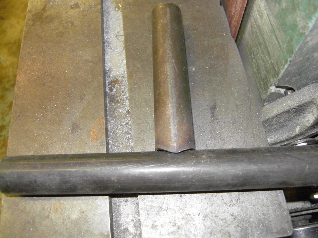

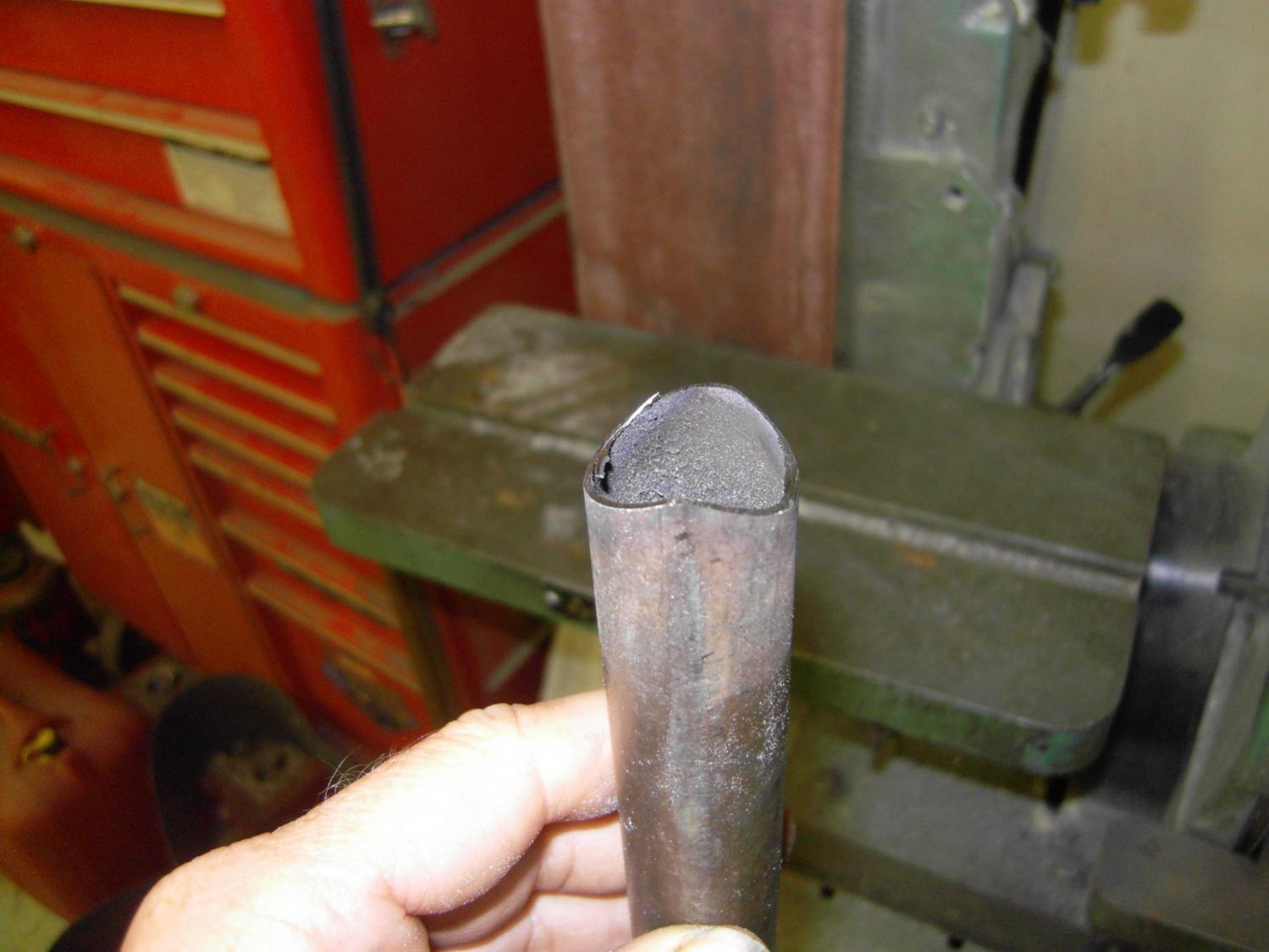

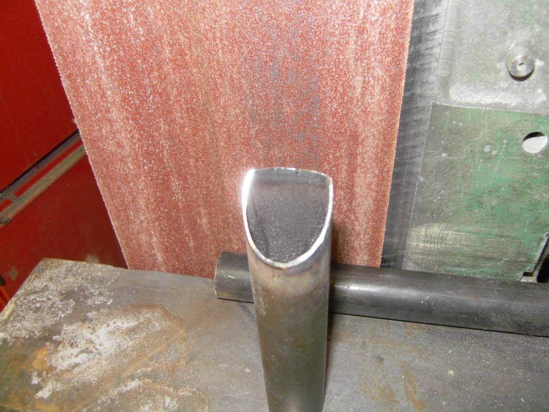

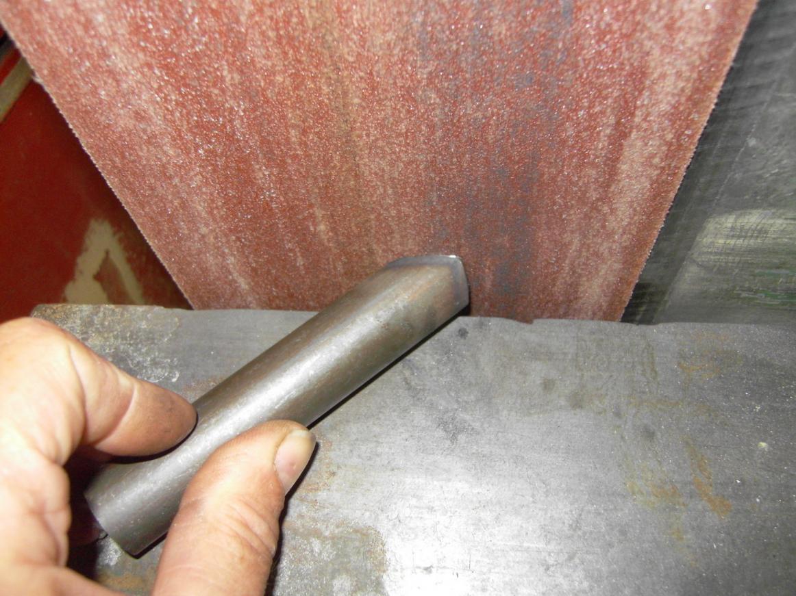

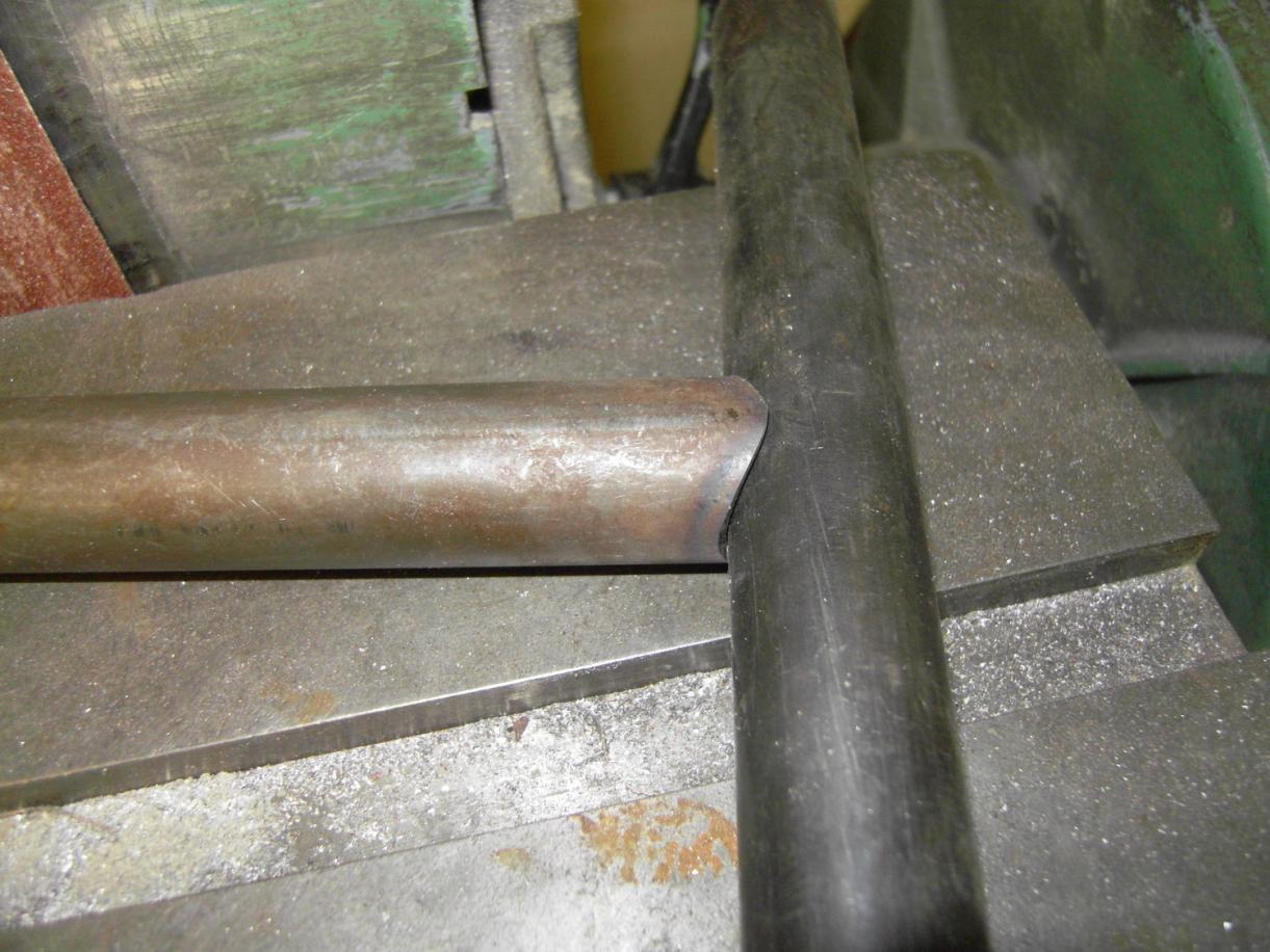

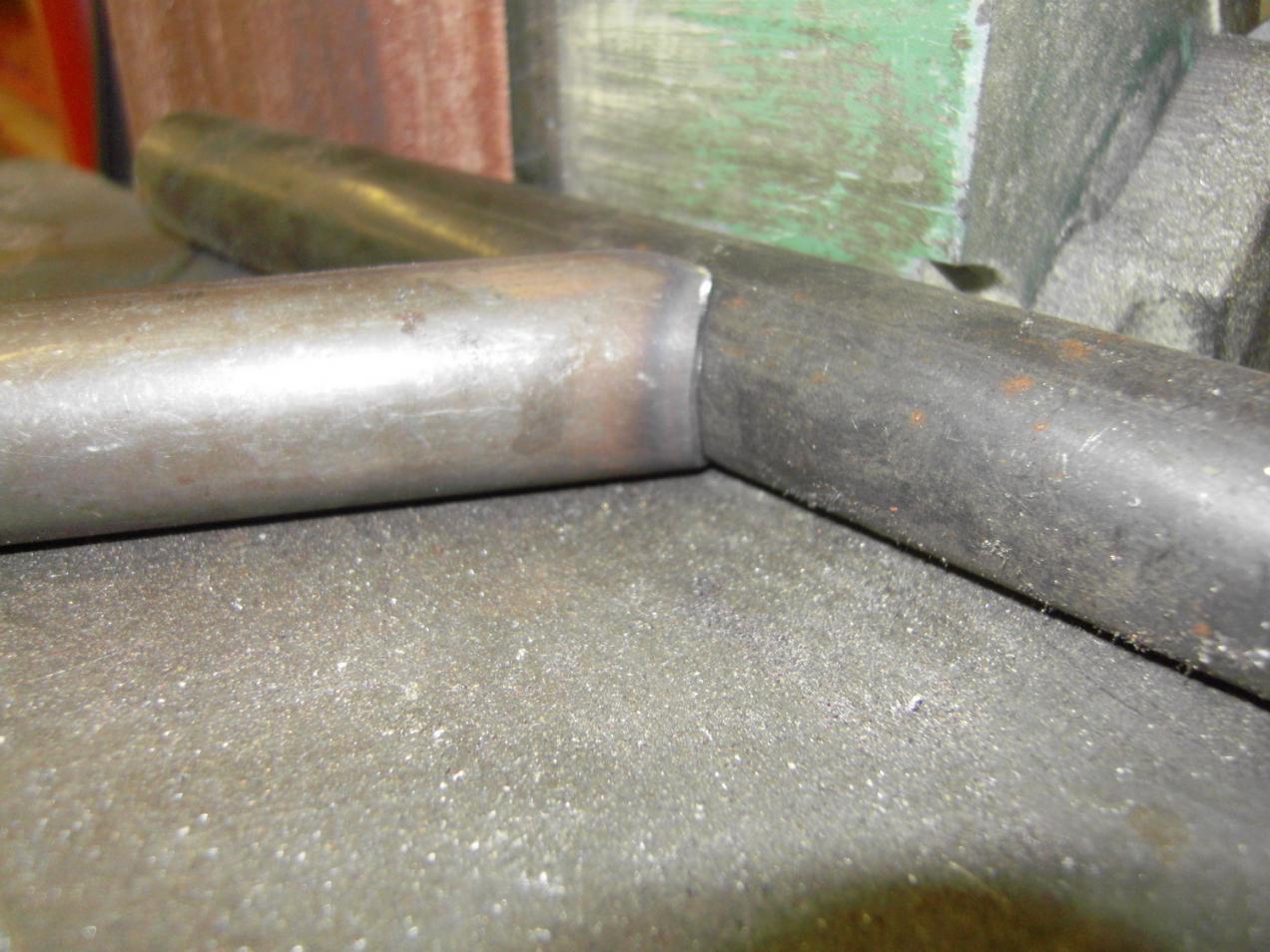

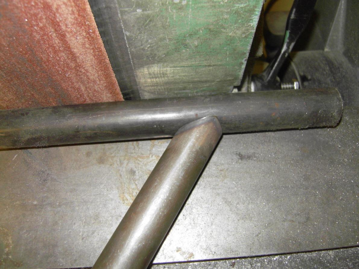

    The chop saw I don't like but belt sander is what I use and works very well it is quick and you can do many angles fast.

    This is encouraging. I have been looking at many of the cheaper tube notchers including the the HF one. The Eastwood notcher is another one I've checked out, which others have noted the same issue with the offset. Is it that hard to get them centered up during production? Shim the machines that produce these notchers if you have to people!
    I probably made it sound worse than it is. Out of the box, mine would cut a notch that was probably 1/4" longer on one side than the other. There are three mounting bolts on the clamp and I used various washer thicknesses to get the spindle centered on the tube. It wasn't. A major ordeal. Using a quality bit is key as SeanMurphy265 mentioned.

    That's a really nice fit. I imagine this method can be tedious with heavier wall tubing but it looks like you have a pretty substantial sander that's up to the task. My little 4x36 would shred a belt before too long (or stall).
    School board sell off old tools and getting new ones it is a 6X48 Delta belt sander for $200.00, Rockwell 14" Table saw $210.00 and a Delta 12" Radial Arm saw $100.00.
    I used a Sears 4X36 for years and yes I usually do tubes up to .125 in. wall and max. dia. of 2.50 in. if it is heaver I saw it close and then sand it.

    I notice you are not using the miter guide. Do you do all these by eye? I move between things so much lately, I doubt I would ever get enough time to get a good eye for this anymore, and would resort to using the miter guide. I also had to hunt down an older cast iron 6x48 belt sander, to get what I wanted.

    Yes just my eyes you get use to it just flip it up and look at it to see if both sides are the same. I use to draw a line down it and keep it up in center but not now.

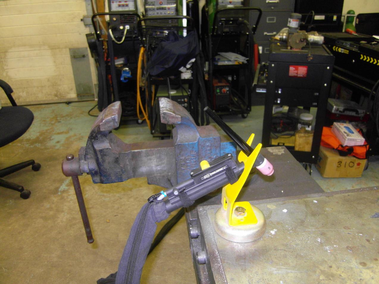

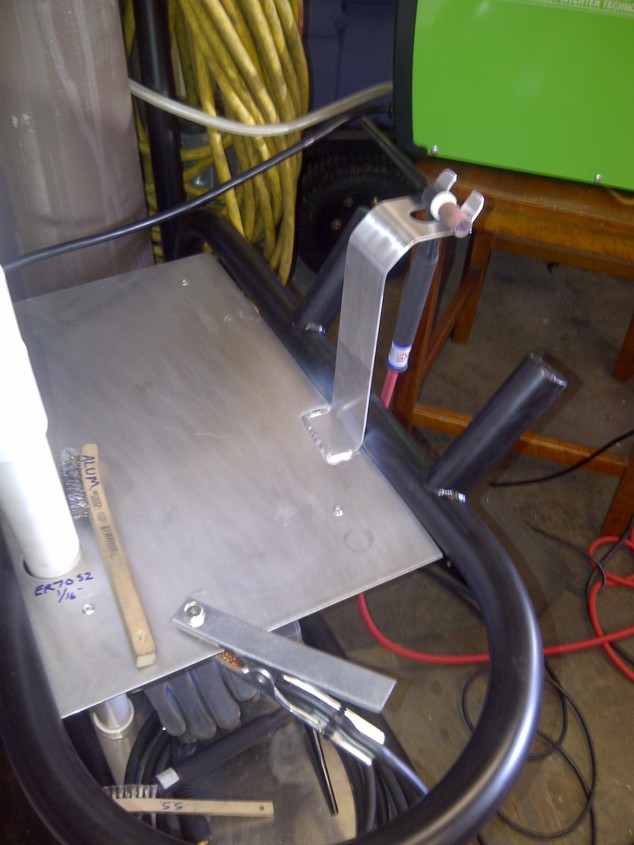

    Thanks, Kempy. I stole your torch holder idea and fabbed one up today.

    Glade to help and you did a very nice job on it. I find the ones you buy put a stress on the hose bending it over time and some times they are hard to get out with a long tungsten cap but they are only $10.00 at P.A. you can use the magnet mount.

    I see what you mean. Looks like that could do some damage if you had a good length of hose unsupported but the magnet is pretty convenient.
