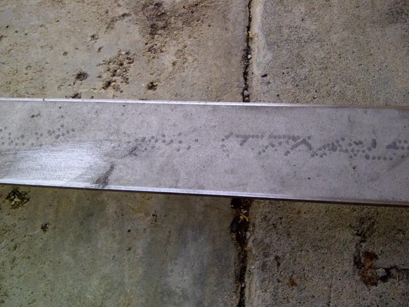

    This is a piece of 304 flat bar, as received. No scale as Rambozo said, very easy to finish and even easier to scratch!
    Thanks for responses. I wouldn't expect "easy to scratch"... does that vary between varieties of stainless?
    "Easy" is relative to carbon steel, but it can be a big issue if you selected SS for appearance reasons.
