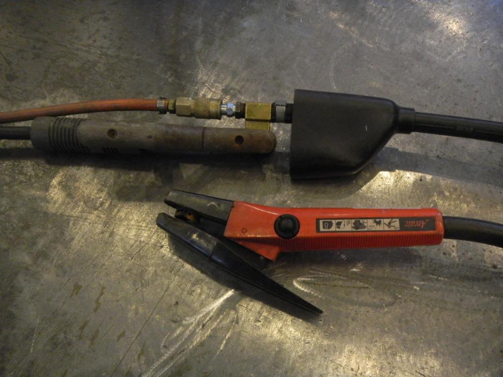

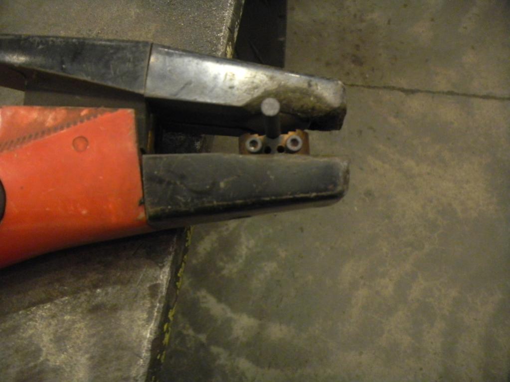

    If you do buy used and don't have a big enough compressor, I closed off two of the holes in my torch. Can't tell any difference in it's performance. But now a days the biggest rod I use is 1/4-inch.
Name:	Carbon Arc 1.jpg

    Shield Arc,
    You've got some of the best suggestions for my partcular situation that I've seen. I appreciate the photos too.

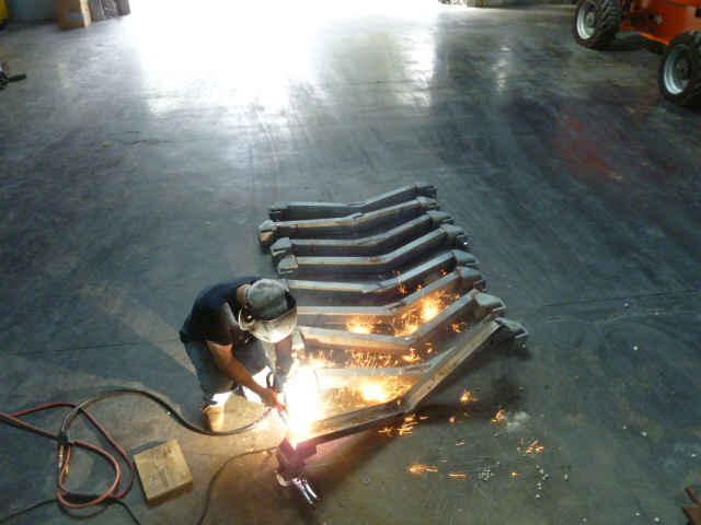

    more unsubstantiated opinion. i'd go with mfg's recommendations on rod size and amperage, is it likely they would mention it as a process and still warranty the machine? i don't think so. just be cognizant of the limitations of your machine, use a compressor that will provide you with the correct air flow and don't go plugging holes in the torch.
    there are a number of threads on other sites that deal with this issue but here's a suggestion; call and ask if it will void the warranty.Click image for larger version.

    I have done carbon arc gouging several times. I would suggest an arcair K2000 head for a small welder. The K2000 can use 1/4 round and 3/8 flat rods and it works with 40 psi of air . If you get the larger heads they take a lot of air to use them. On a 300 amp machine the K2000 will do all the machine will let it. Carbone arc for those who have not used it is very messy. I would suggest full leathers, and clear all combustables in the area to at least 50 ft. Have a good extinguisher ready and put ear plugs in your ears ( for the noise and for the slag that will want to find its way into your ear cannal). There are times when it is definatly the tool for the job. It is just very limiting as to where you can do it because hot slag goes everywhere. I would not do it in a garage either because there is a considerable amount of smoke involved also. The best place to gouge is in a large parking lot with nothing else around . It can remove old welds very quickly and is good to prep cracked areas that you want to weld on large thick pieces .
