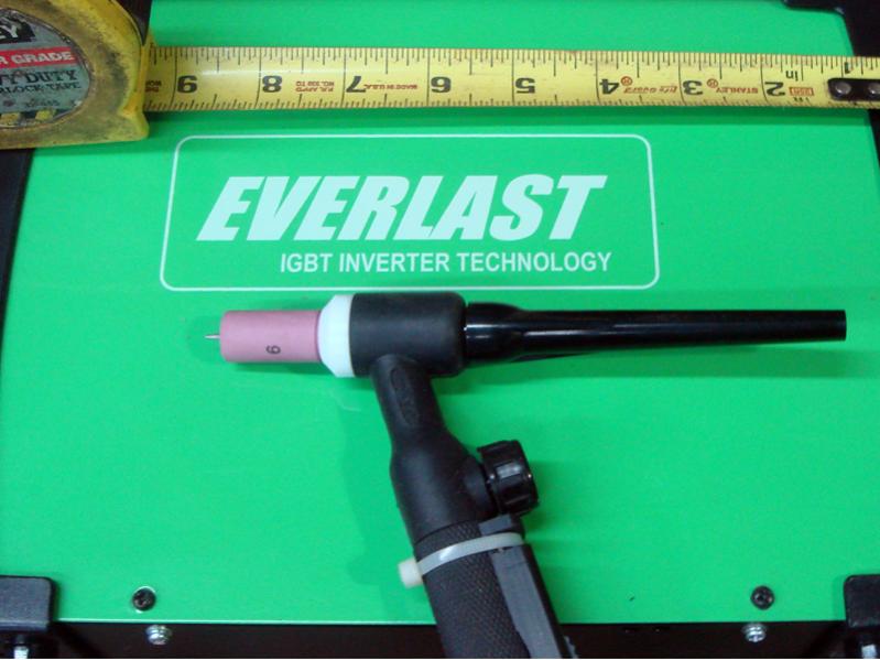

    If I don't like the size of the Tig torch on the 200. Can I just replace the body or do I have to get a complete torch. Just searching ebay looking at options for something small or even flexible for those tight to reach or awkward areas.
    The internal connections vary from brand to brand, so typically you would swap the torch and cable/hoses when switching brands. The stiffness of the stock cable and cable cover is one of the complaints, so it makes sense to swap that when changing torches. However, the stock setup is not bad to start out with. You can also get stubby components that shrink the size to very close to the smaller torch series. For example, here is the stock and with the stubby kit...
ID:	11249 Click image for larger version.
    And here are an assortment of common torch sizes (no micro torches shown)
    All of these can also have short back caps installed for tight areas.
