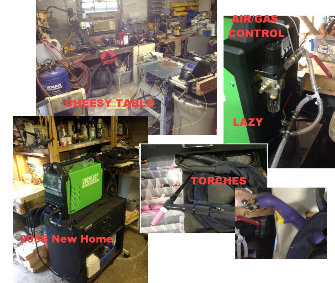

    Okay I promise to quit posting to this thread soon... But would like to report, so far so good... After dinner, I opened up the chassis fully to inspect, and everything looked and felt okay, all the little sub assembly's and daughter boards and attachments/cables looked good, nothing rattling around, relays still tied down etc. etc.. Found the HF point adjust, didn't bother to stick a gauge in it (so far it's fine)... As for the fan replacement, 4 nuts and two solder joints and some heat shrink and that will be done. Katya sent me the tracking#, the parts will be here on the 27th I think.... I must say they have been on the spot about taking care of these problems so far... Thanks guys...
    Anyway, after that I hooked her back up to the 26 torch, and my gas/air valve assembly and fired her up, let it idle for 10 mins or so while I rummaged around for crap to weld on, and ran a few beads and a root pass on a 1/4" butt weld on some rusty old structural steel unkownium... So ran in DC w/the 26 and 3/32 2% lanth. Just using the switch.. No problems... Then switched over to the wp9 and the foot pedel, for the first time really, using 1/16 2% lanth on AC... Just ran a few beads on 1/2" 6061 and then did a lap joint on some 1/8" scrap pieces.. Looked like crap but it was a weld ;-) it ain't coming apart...
    I ran it for about an hour off and on in between grinding tungsten ;-) a few times... Just ran TIG both DC and AC didn't run the plasma or stick yet on this unit... And didn't try pulse mode while welding either, still nervous as that was when the first welder croaked, was 10 seconds after trying pulse on 1 PPS, 30 and 30.. It probably was a fluke, bc it worked great right up until it failed..

    Oh well, anyway as promised here are the pics from the inspection and just a few of the welders new home…
