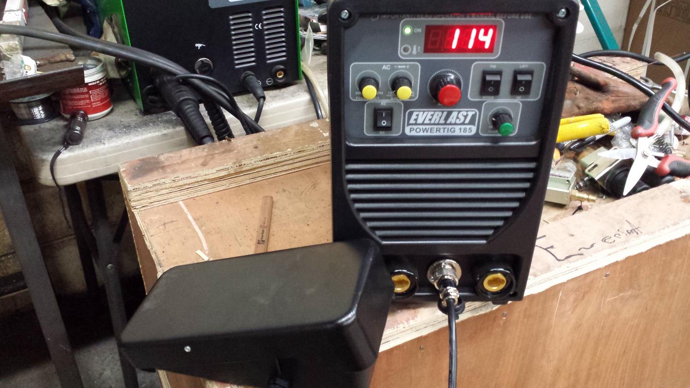

    The Current 185 uses the new 47 k foot pedal that is shown in the picture . The amps are set from the panel and stick is 115 amps max and tig is 125 max output on 110v . All new models should have the latest version pedal . The dimensions listed by Rambozo are correct

    I think mine is a 22k pedal. It was purchased earlier this year. The pedal is not the one pictured (I assume that is an SSC pedal?).

    The pedal is the new design . The 185 is one of the models that now has this pedal and it will be included if purchased direct . I am not sure about any Amazon models .
