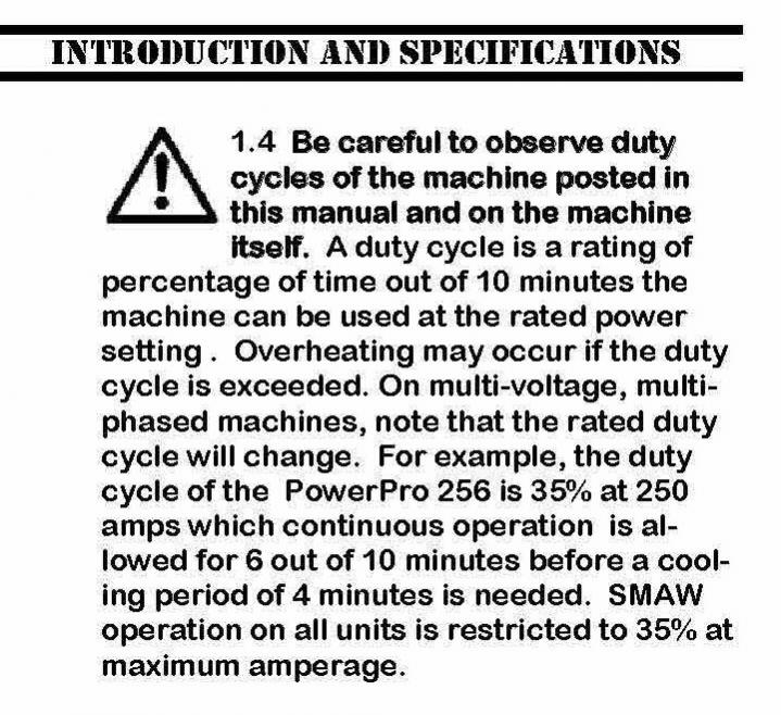

    I couldn't find it in manual but when I want my power pro 205 to cool do I just stop welding? And leave fan running. Or should I turn amps all the way down or I'd hate to just shut off cause the fan shuts off. Thanks for any and all help!
    Hey, Ogre, welcome!
    Stop welding and let the machine continue running for 10 minutes or so. That way the fan continues running, as you pointed out. During the shutdown cool off I clean up and put gear away.

    DaveO has a good point it will help the machine cool down. The manual has the information on what you need.
