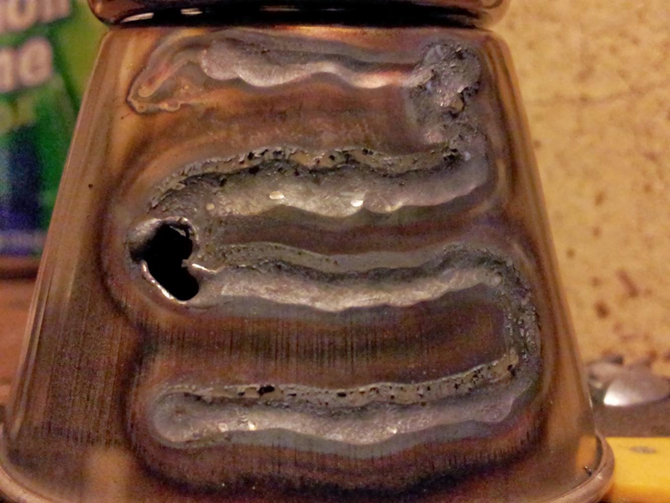

I received my PowerTig 250EX today. It got held up in Mezquite, TX for a few days (storm/ice) but to my surprise, IT ARRIVED IN ONE PIECE and not too badly knocked around by UPS. The machine looks great! I like the layout of the controls and it isn't too heavy to carry here and there but a rolling cart is definitely on the to-do-soon list.
So far, I've only unboxed the machine and accessories. I will wire up the plug, connect Ar line, try to rig the water supply for torch (water bib for now), turn on, test and maybe strike an arc or 300 tonight.
