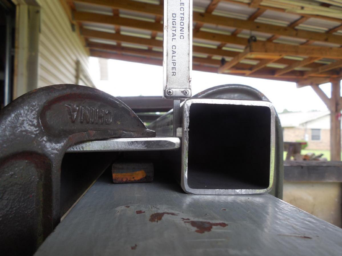

    Something you will need to figure out is the length of the rails for the correct travel on your table. The attached drawing show what needs to be considered for the length of the rail this is for both the X and Y rails. You need to add the width of the slider to the distance from the end of each to the limit trips. Now add this to the distance you want your torch to travel this will give you the total length of the rail.
Name:	Axis travel info.jpg

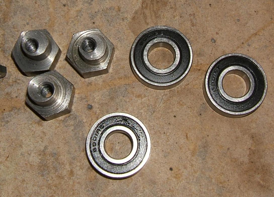

    This is how I adjusted the bearing on the sliders. I machined a ¾” hex to be offset about .240” and for a bearing that had a .471” ID. I drilled the center of the hex and taped it with ¼” 28 threads per inch. These are setup for a 6001RS bearing (rubber seals) which you can get on EBay cheap. It takes 30 of these per table (10 each for 3 sliders).
Name:	cutting new parts (11) A.jpg
ID:	11542   Click image for larger version.
Name:	test mounting of X sliders (1).jpg
