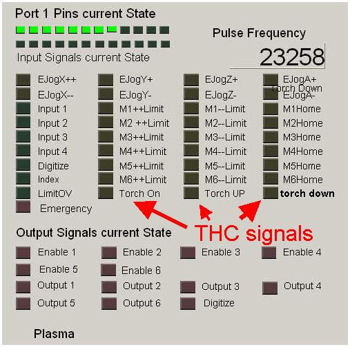

    Have you checked to see if the THC signals are getting to Mach and are correct? run the Proma test and watch in the diagnostic page of Mach.

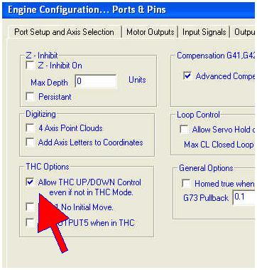

    I have thc option on in ports and pins.
    I have thc in mach3 screen off no green light. when I had it on the torch would not move and cut.
    I was running at 30 amps maybe I will try 40 plus amps
    I have pierce and delayand cut height very close to your specs.
    In sheet cam I am just using mach3 with pause no thc . Iam not sure what one would be best for me.
    proma test moved the torch head up and down. I will have to check it against the diagnostic page in mach3

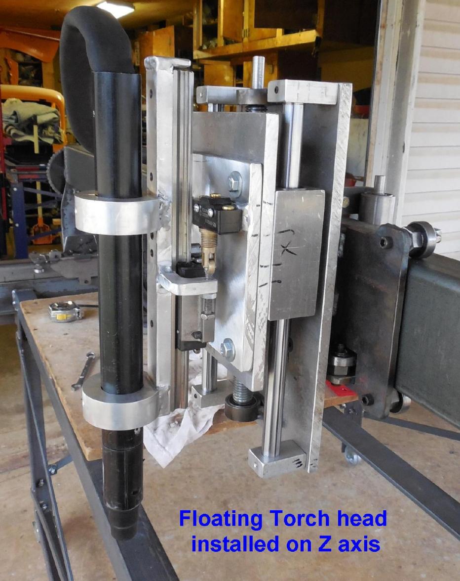

    Yes I do have a switch on the floating head assembly. I have all of home and limit switches in series and it works fine. If I a not using the floating head I have a jumper plug that is to by-pass it in the table wiring. Mach treats the signal from the switches in a way you can do this. If you tell it to home it homes the Z first then the Y then the X so any switch trips will stop movement of the axis and goes to the next axis. Any switch tripped will stop movement on the table. When using a floating head switch mach is in that mode and when it touches the metal it says this is Z0.0 and backs up and continues the programmed steps to set the pierce height ect.
    Going back to X0 and Y0 the step before that should be to raise Z so the torch is out of the way as Rambozo said to be safe.
    Another thing is G0 is move fast and G1 is move under control of the last speed setting F and a number is telling mach how fast to move about. You will see and floating head operation with a low F number then when cutting command come up it will have a higher F number. Mach will operate at the last F speed until it is changed no matter what commands it is. See below.
    The arrows are pointing to speed commands and the box show a floating head routine touch the metal set Z to 0.0 move up to .25o” move down to .140 for pierce height M3 light the torch. Next line drop to .060” a f25 (cut height) next line start moving while cutting F200 all movements will be at 200 until told different. The N### are line numbers the mean nothing you can add command lines or remove line no problems.

    So do I understand that a z micro switch is needed to allow touch to steel before each cut?
    I have a 1/4 inch of free movement on z axis .
    I may have to get a switch and find a place to mount it.
    maybe later I will send a few pictrues of my setup
    Wayne
    yes sir the Z limit and home switch is used to detect the end of travel for that axis. The floating head switch is only used to detect the metal when Mach tell the torch to go down and when it touches the metal that activates the switch and stops downward movement. Mach then resets the Z position to 0.0 and the torch moves back up until it reaches the Z value in the routine.
    It is hard to see but this video shows my table doing a touch routine.
    http://www.youtube.com/watch?v=gW7w9...mQfMwq0KTKpuRw
    Some table use a ohmic-sensing tip on the torch which works similar but only works on bare metal. And is a separate circuit just for that reason some manufactures still want a floating head switch as a backup for the ohmic-sensing tip so if it fail to make contact it don’t bust you torch????

    try two things there is a reset in the THC box click on it to clear out old setting.
    and upder ports & pins (mill options) no checks in the THC options boxs

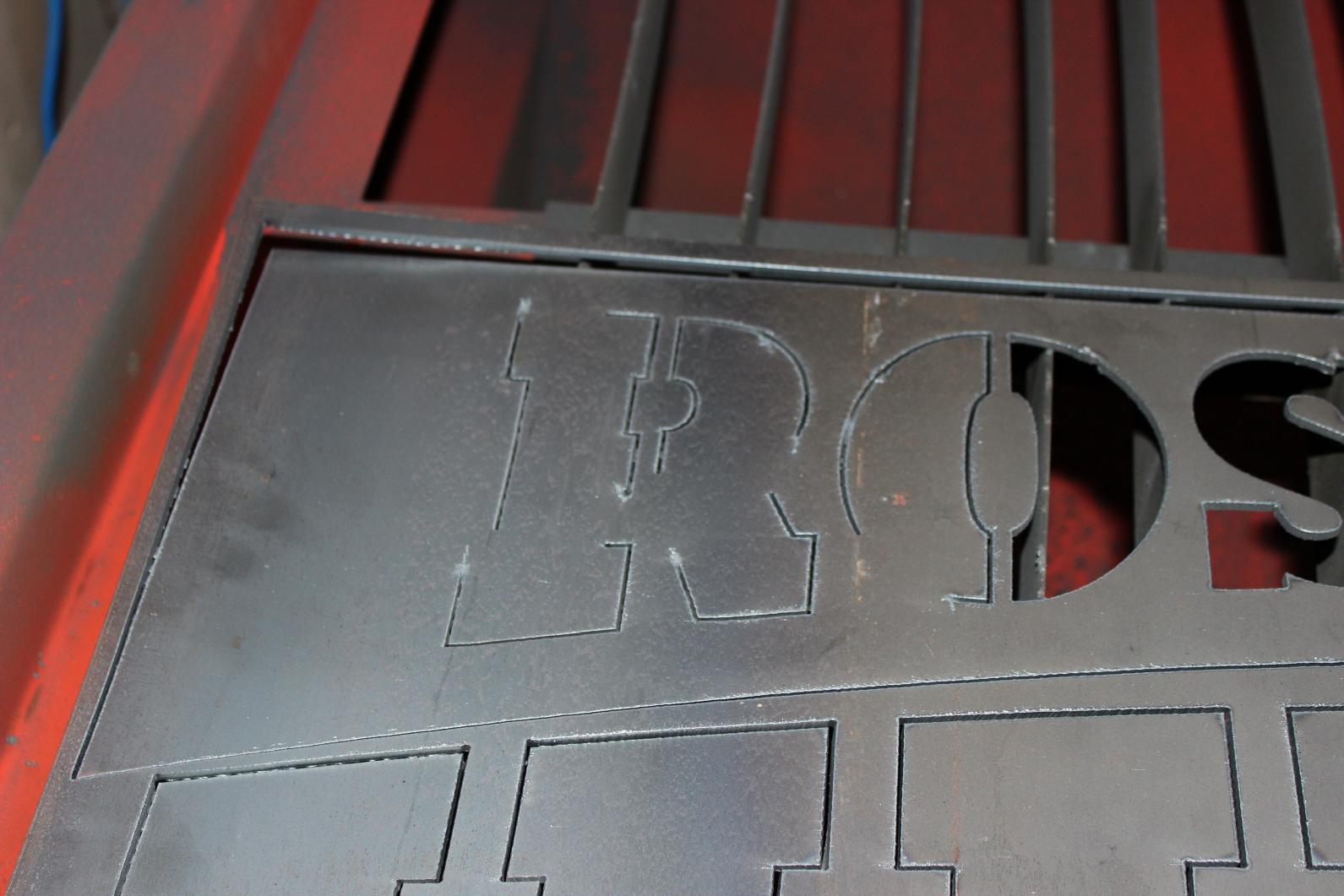

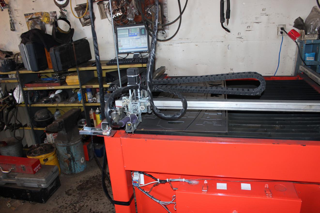

    I finished one sign . turned out ok .torch would cut out once in a while? I will try to attach picture .
    I will send a picture of my machine too if I can.

    Maybe I may reduce the thc voltage a couple to lower the torch/
    wAYNE

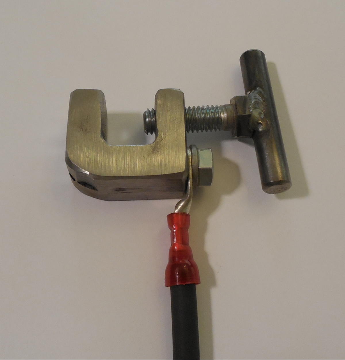

    something that may help with cutting is to attach the work ground directly to the metal you are cutting.
    Here is a ground clamp I made for mine it is small and will not get in the way of cutting
