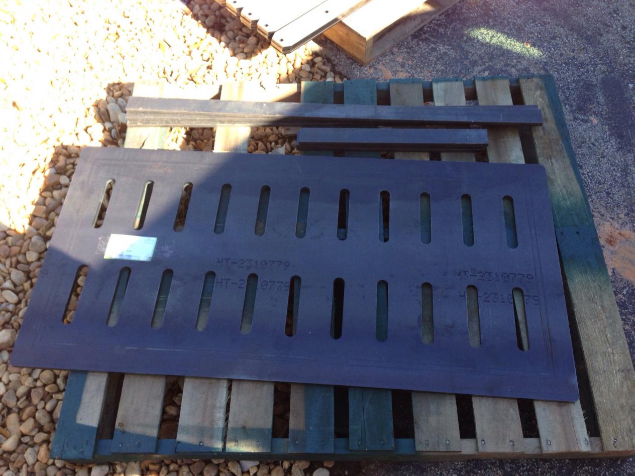

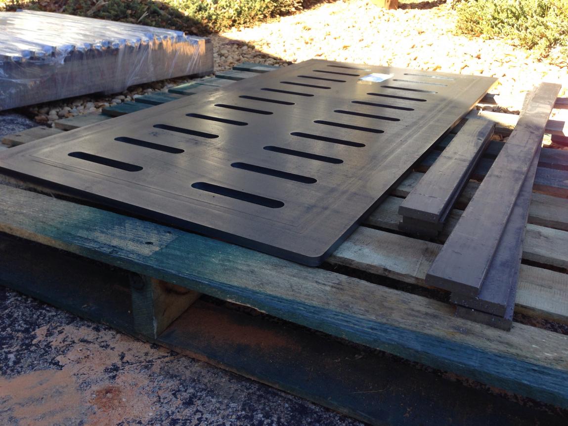

    Just got in a CK FlexLoc torch, so I'll give it a whirle tonight. Also just had a table cut from 1/2" plate. Laser cut with the metal $200.00
    Is the table 2' x 4' ?... looks nice. What state are you in ?
    Yes it's 2'x4' with 22 1"x6" slots 1/2" thick. Shop I used has a laser that can handle 1" thick steel. I pick it up on Thursday (have to work tomorrow). I am really excited about it.
    I am in GA.
