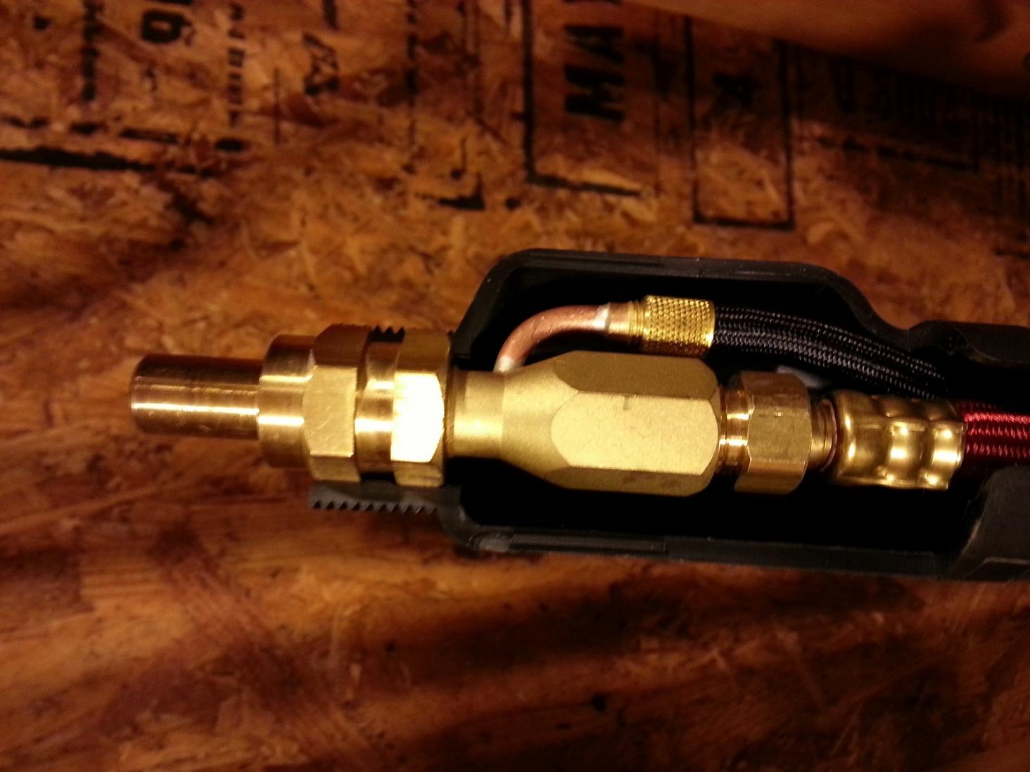

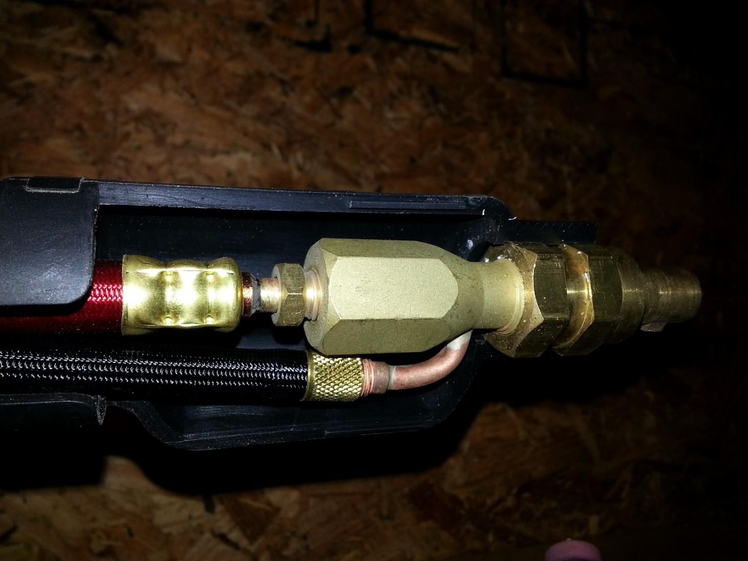

    There is no "adapter" the cable simply screws onto the dinse and it's a simple as that. The first time you put the dinse in the machine it will be hard to turn. Just crank it on around and it'll be fine after that.
    I have two CK torches for my 250EX. A 130 and a 210.
    When you say no adapter, you're talking about the extender block I was describing, right? You should still need the CK adapter to convert from the hose to Dinse / gas QD fitting, no?
    Even the torch that came with the 210 was really hard to connect the first time, but was fine after that.

    On both my torches the cable screwed directly to the the dinse. CK 130 Click image for larger version.
ID:	11726Click image for larger version.
ID:	11727 CK 210.

    Ah. Maybe it comes down to how it's being packaged. Where I was looking, the part you show is sold as two separate parts.
    http://www.weldfabulous.com/p-76303-...superflex.aspx
    http://www.weldfabulous.com/p-77559-...17mr70-qd.aspx

    That's correct. I purchased the torch with cable and a dinse. My point was that it doesn't require an adapter to screw the cable into the dinse.
    The part numbers have changed slightly since I got mine well over a year ago. I'm very happy with them. I use the 130 for everything up to 150 amps and then the 210 up to 250 amps. I would rather have a 130 flexloc than the 130 flex that I have.
