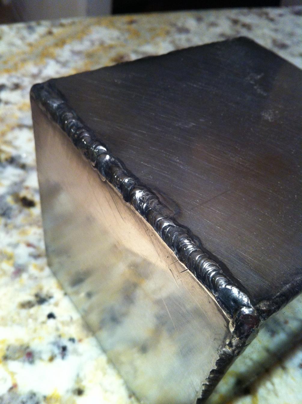

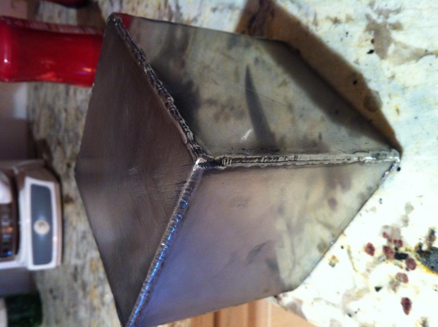

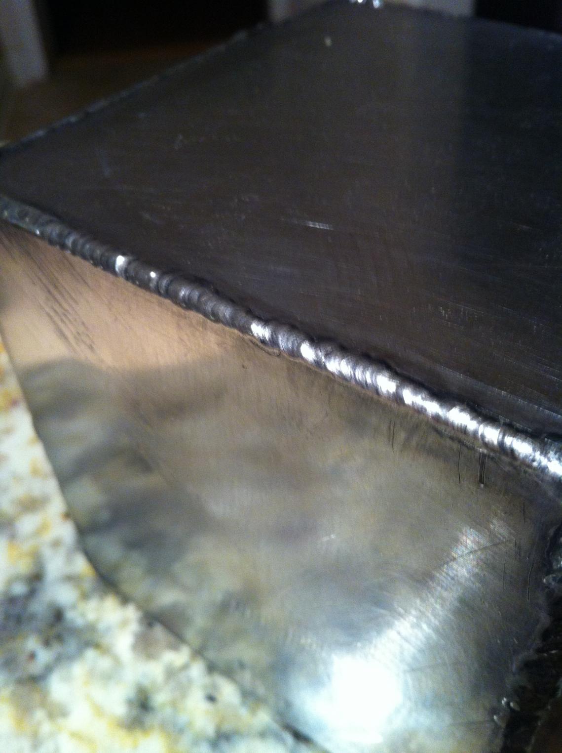

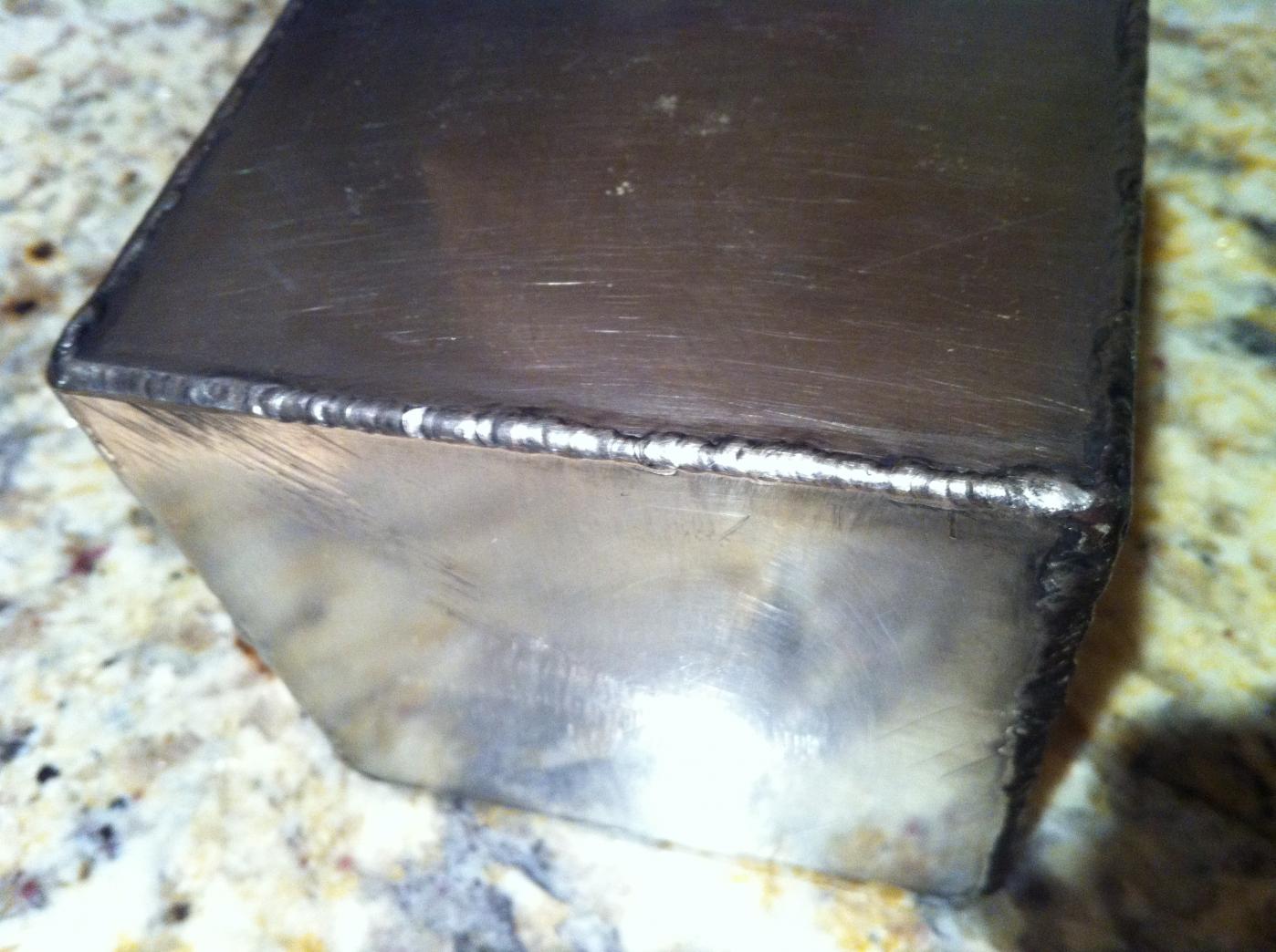

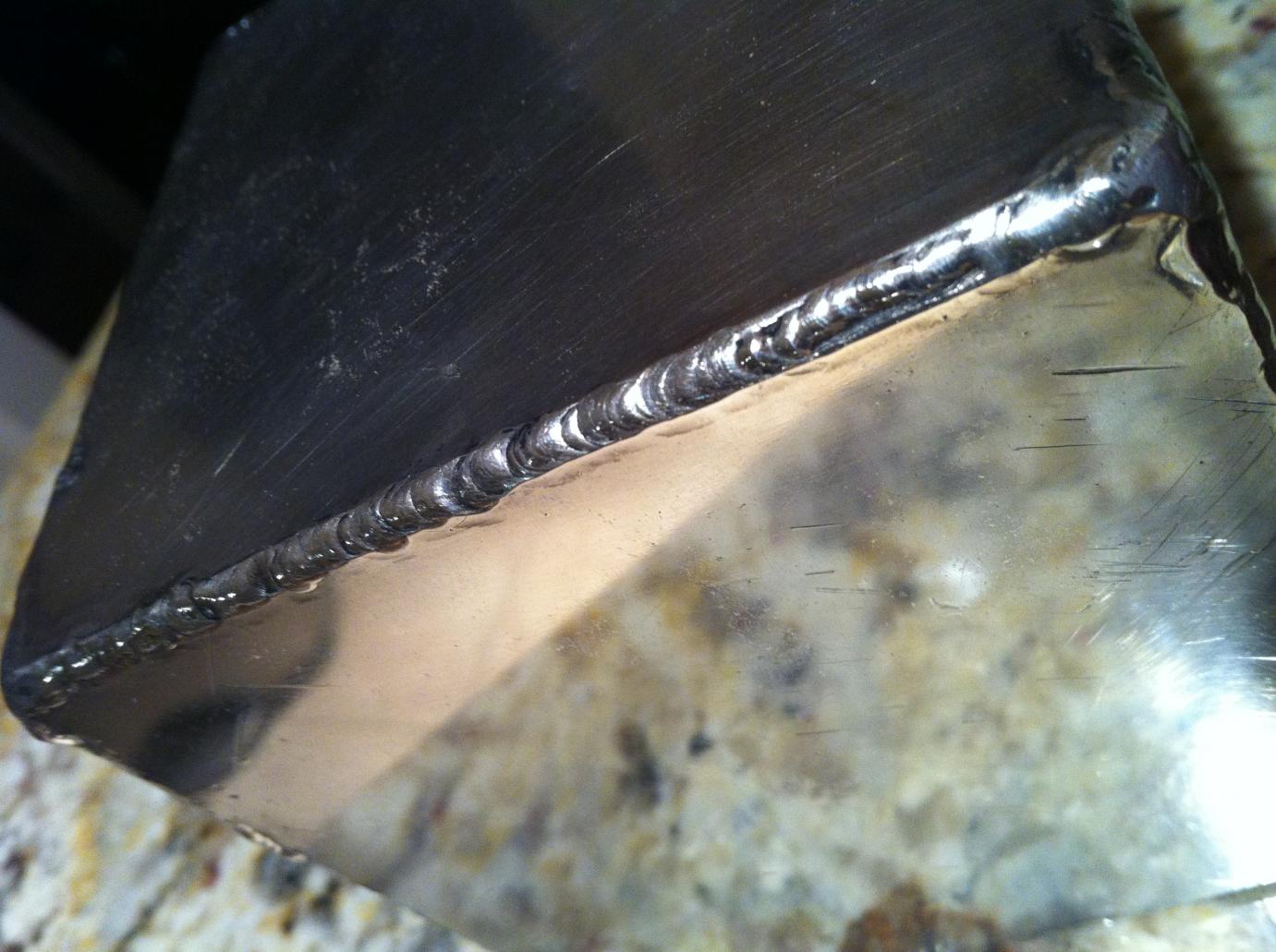

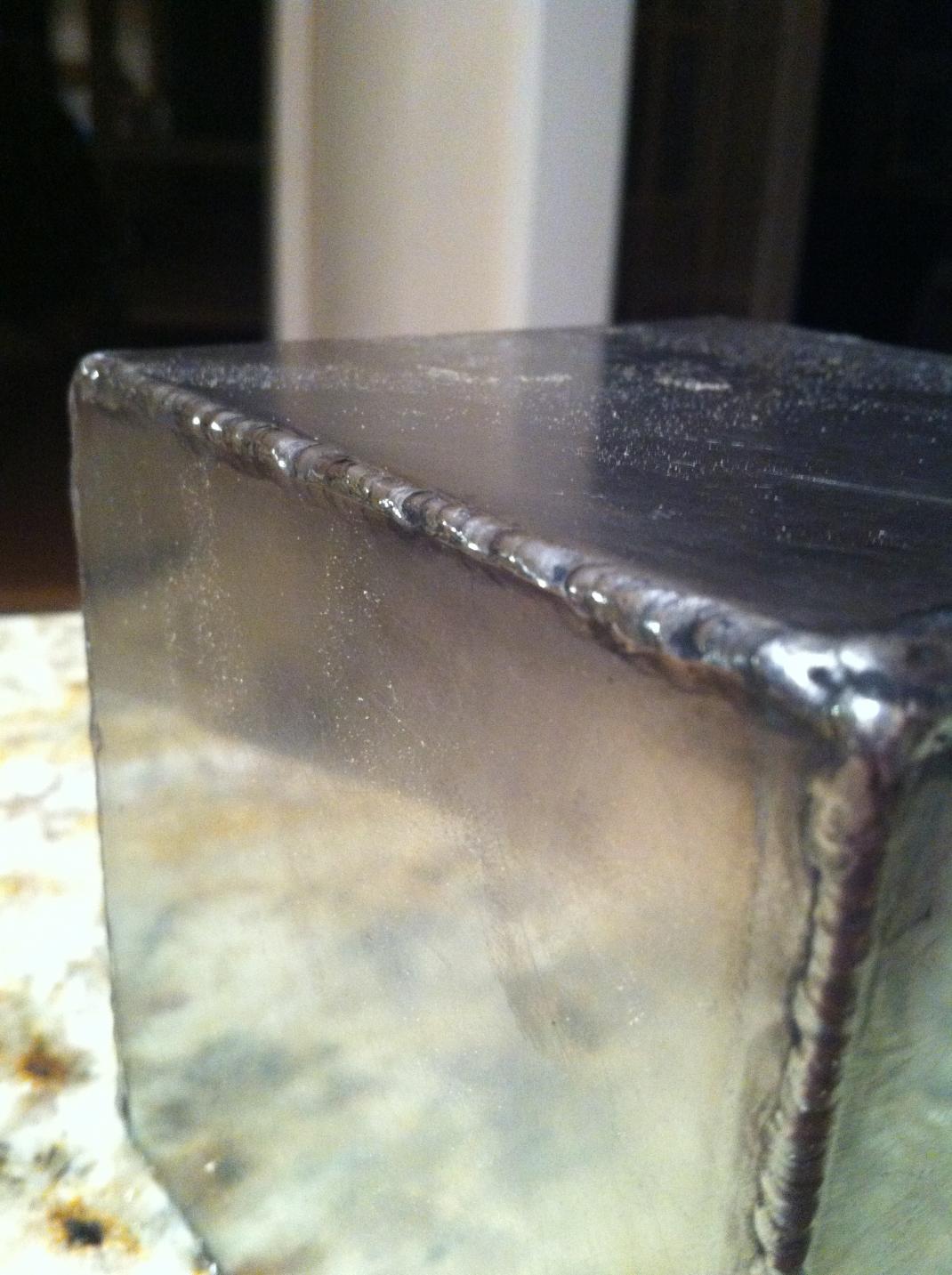

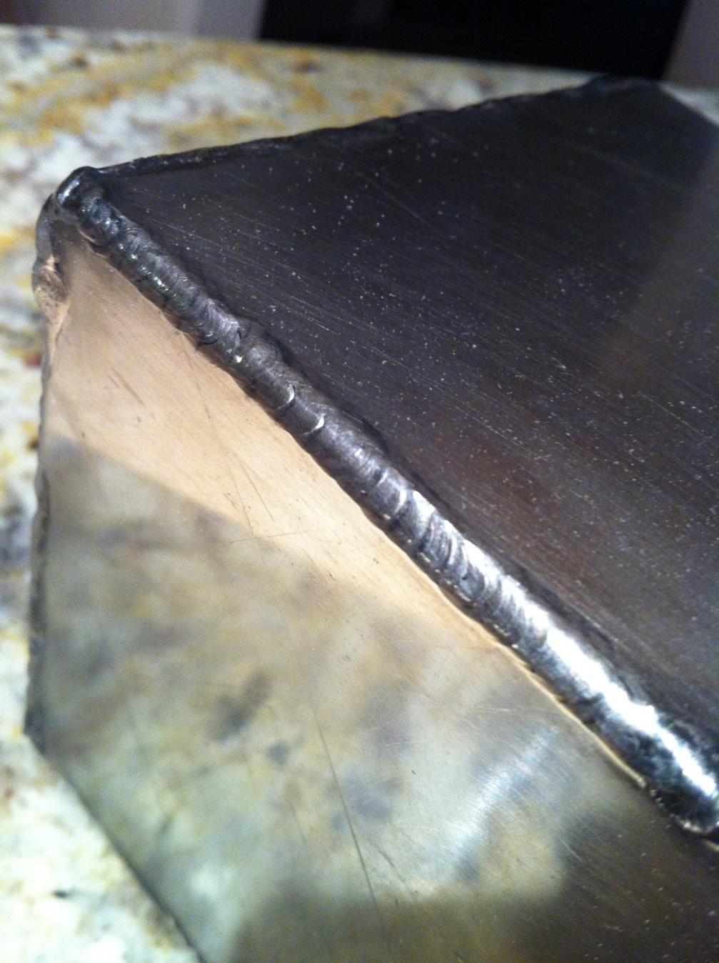

    Never tig welded before I got my 200t. Not formally trained in any welding.
    Went to scrap yard and picked up some stainless to play with. Maybe 16 guage sheet. Cut out 6- 4" squares and went to town practicing outside corners.
    Used 1/16 tungsten. Tried 1/16 filler. .030 stainless mig wire. And fusing.
    Started out horrible. Then got waaaay better.

    So what dose the tank inside look like, did you use argon to purge the inside to stop the burning or just welded it?
    For the first time it looks not to bad. Little more practice thing will be the way you will like it to look. Keep send your progress, nice to see new welders on the forum.
    Also welcome to the forum.
    Looks ok to me, and welcome to the forum redstopgreen.
    Lincoln A/C 225
    Everlast P/A 200
    i did not purge any. the inside seams were not too bad. a little wire brushing cleaned them up...before i couldn't get inside anymore. if i get a chance ill try and figure out what my first seam was and compare it to my best of the day.

    When I do stainless sheet outside corners, I leave a little overhang to fuse down and so rarely have to use filler. It's fast and produces a nice looking weld. If you want to limit the damage on the inside but not purge (if the inside doesn't matter much), you can use an aluminum angle backer to keep the air away. The thing with stainless is if you get it too hot and it's unshieilded, it burns producing a rough, porous surface.

    Your welds look really good for a beginner! You'll pick "it up" in no time with a little more practice. I started using the Solar Flux B on misc. stainless projects were the backside is accessible, and it's not bad to work with. Used to use copper backing, but on a finished part you have to be extra careful when clamping. I haven't started back purging anything yet as I'm finishing current projects at the moment that don't require SS welding.

    no real reason for the stainless practice, other than to be able to weld it. i only weld little artsy thing for gifts at the moment. mig didnt give me the control or precession i was wanting.im sure i will come up with some cool things to build with my new machine. maybe a bicycle or something. have to be steel though.
    the super ugly one in the photos was my attempt to fill a fairly large gap( i cant cut straight ) maybe 1/4" or so. i guess they are all pretty ugly. but i was fairly happy.i was using a cheater lens in my helmet. thinking about trying to stop using it. i strain my eyes real hard trying to see that close.
