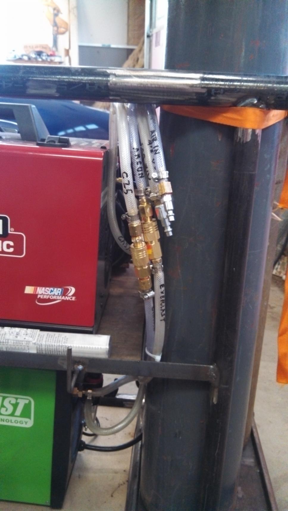

    I just saw a post about these on another site and have a few questions? I originally was planning on picking up a Powertig 250ex, and a Powerplasma 60s. What, if any advantage is there to buying separate machines versus going with the Powerpro 256d? Is warranty the same? Is a watercooler still an option? Duty cycles the same? etc.
    Single units give you less of a hassle in the event of a break down and you also avoid changing leads every time you want to cut or weld something,,,the water cooler is a must have option if you intend to get the most performance out of those units...I'm cutting at one end of the shop and welding at the other end,,,the idea of moving the TIG unit to a place to cut undoing the hoses etc and setting it up to cut every time does not appeal to me..many 256 owners get by with that and are quite happy with their units but I like a single unit for each job...and with a single unit setup having the plasma available for CNC plasma cutting doesn't tie up my TIG welder...
    Duty cycle is not the same. You are on the right track if the funds are there on the 250EX and PP60. 256 is normally a hobby level machine, multiprocess as well. And swapping hoses would drive me nuts too.

    I have the 256, and as said it's more for the hobbyist. I have had the machine about a year and I use the tig a lot but the plasma only a few times and never used the stick. The times I've used the plasma I "save up" all I need to cut and do it all at once.
    As far as change over it's not bad the leads are quick connect, so it's twist them off and twist them back on. Change the argon line to a air line*. Flip the switch to the desired function and you good.
    *Their is some pix on here of some tees and valves to make the gas air conversion easy. I'll try and find them and post a link.
    http://http://www.everlastgenerators...ighlight=argon
    Mine is set up like the one in post #27,, Thanks zoama585
    Still need to fab a better mount, but basic setup works. Someone mentioned seals leaking over time, but the $2.00 to replace the quick disconnect is worth it.
