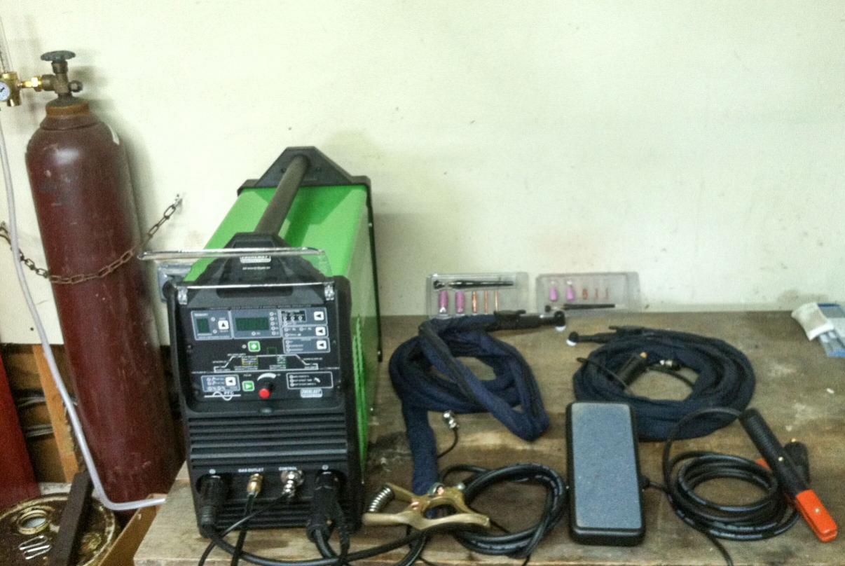

    New 210EXT "replacement" just showed up today. I'd gotten one in May but it died after about 2 seconds of welding. The one today is the newer one-dial model, generally looks like an all around improved setup. Includes a power plug on the cord, and a 120VAC adapter to plug it into a standard 15A 120V outlet at about 50% welding capacity according to the manual.
