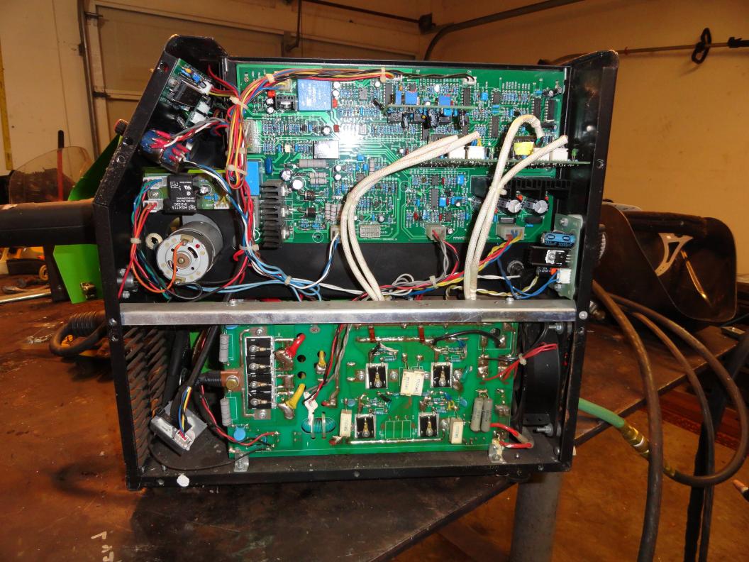

    I bought an IMIG 200 to try and hook up a Miller 30A spoolgun up to it. I recieved it today and tested it on stick using 5P and 7018. I was pleasantly surprised on how well it ran both - much better, in my opinion, than my 200DX. I know the DX is not supposed to run 5P but I haven't been crazy about how it runs LO-HI, either. The arc seems much smoother with the IMIG. The control in stick mode is YOYO - You're On Your Own - as the readouts mean nothing and is dialed in at the POT. No biggie, same as my other analog machines. I have not played with the arc control, I didn't buy it to stick weld but I'm encouraged enough to play more. The idea behind this effort is to have portability for jobs that I do in a harbor where 220V is available dockside in places or on boats that generate their own power, usually 208V. That it welds stick too, and well it seems, is icing. I do mostly aluminum. When I bought it, I asked for a female connector (Amphenol type) that is part of their spoolgun hook-up, which, they gave me for free, so as to have internal access for my designs. My probing so far shows that the contactor (lugweld says there is no contactor) which is energized by jumping the two pin contacts on the Euro style connection. At the Amphenol, which has four wires to it, two provide 13VDC, which apparently provides power for the spoolgun. The two other connections I cannot figure. Anyway, I'm off to make this work. I'll update how it goes, one way or another. Failure is not a concern. BTW, Alex gave me a good deal on the unit.
    The gun you have is too big for the i mig 200. You need the 250 or the mts 250S. The 200 cannot provide enough power to run the heavy gauge wire you are wanting to...and give you enough power to spray without creating an overcurrent or duty cycle condition by causing too large of a surge with the thicker diameter wire. (plus duty cycle is rated at 160 amps for mig (35%) and not 200 Amps. The relative position of the wirespeed pot on the panel changes the voltage to the spool gun just as it does to the wire feeder to increase or decrease the feed rate. As you vary the wire speed (amperage) pot on the panel, you are actually varying the voltage to either the wire feeder in the unit or to the spool gun. You have NO wire speed controlability on the spool gun itself on the i mig 200. The two wires in the amphenol connector are the switch wires which provide variable power to the spool gun. (If you turn the wire feed speed up and down the voltage will vary, probably not over 17V though) The "other" two wires actually go to the Euro Quick connect where the MIG gun (our gun) plugs in and is connected to the switch. This means to run our spool guns, you have to dismount the regular gun. The two little spring loaded pins are the MIG gun/Spool gun switch control (on/off). You don't have a large, separate contactor like you do in an old transformer welder. There is a relay soldered directly into a small circuit board with resistors and capacitors on it The actual welding power is provided at the Euro quick connect as well. You can see the relay in this photo off of my original unit on the upper left just below the pots and above the feed motor, though things may be a little different looking now. I took this picture the other day for a customer who was wanting to compare circuits. This is the first i MIG 160/200 brought in. I am still using it regularly, and it runs hotter than many production units but it's all it wants with .035 alum wire with the SM200 gun.
    The numbers on the wirefeed speed are fairly close in inches per minute, but can be 15% off depending on wire size. But when you start welding it displays actual amps output. When stick welding the same control does display amps. The arc force control affects both MIG and Stick modes. In stick mode though it controls the "dig" and boosts amps when the welding voltage falls, so amps will not always stay steady when welding if the panel is being watched. This is normal and is what you'd find on any inverter with arc force control and a display. When ever you you strike an arc, it goes from a static preset figure to an actual measurement of amps being put out.

    You will need two wires to power the motor. And two wire to turn it on and off by shorting the pins I believe. I can check. Somewhere I documented it and also hooking the pot up to vary the wire speed at the gun.

    Mark, thanks for the great, detailed reply. Here is what I am basing my (crazy) decision on: My current main machine is a Hobart Pota-Flex (ever heard of that? Early inverter machine made by Panasonic) which will run .047" wire @ 150A, 21V. I use that setting all the time for .125-.190" material to my satisfaction. I completely and respectfully disagree that the 30A 'is too big'. If this doesn't work with .047" I have no probs dropping down to .035". Hell, I've used .030" plenty of times, point being, gun size has absolutely nothing to do with what I'm doing, unless there is not enough volts for the drive motor. I don't like those little toy guns and I don't want to buy your bigger gun because I already own three 30A's. If this works then I'm prepared to pony up for one of your bigger machines to run the whole taco - a XR suitcase and the 30A gun. I have had Printz, Cobra, Hobart Linear's and other guns. For over 30 years the Miller pistol guns have served me better than any. Again, what I'm trying to do here is have an extremely portable machine that is for that purpose. I have no pretensions for this to replace my main machines. It is very attractive that this machine runs on a 5.5K generator which means all of it will fit easily in a Cessna 172-180. Believe it or not, I've been asked if I could weld aluminum in very remote places.
    Here is what I think I'm going to do after I opened up the machine and probed with a VOM: I'm going to install a three function switch on the front of the machine that a) shunts the + power from the internal drive motor after the speed control POT so the 30A motor is controlled by said POT, and b) shunts the 2 control wires from the Euro connector to two free pins on the pin connector. Four of the pins on said connector are taken so I'll remove one now unnecessary wire from the connector to do this. Now I have the trigger on the 30A actuating the weld power and drive motor power controlled by the speed control POT. I've tested it by baring some wires on the 30A and jumping to the box. Thus throwing the switch one way will make the machine work Euro, and the other way will run my spoolgun. I have no problems with the wire speed control being on the box, I don't spend much time adjusting wire speed after I'm set up. Of course, the proof will be in the pudding as to how well the wire speed will be controlled but I see no insurmountable problems. Worse case, I have Miller controller for older style machines that makes 24VDC from 120VAC.
    You say that the POT controls the voltage at the pin connector but all I get is a steady 13VDC there. At the internal drive motor I get up to 15+. And you say that those other two wires on the pin connector go to the Euro 'on-off' pins? I'm confused by your description of what the wires going to the pin connector (amphenol type) do.

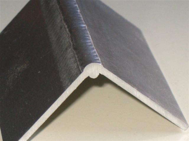

    You win, I don't care you top me. You're smarter, have more experience and are more intelligent. Here is a short arc weld single pass on the outside of corner-to-corner .100" 5052 Notice the lack of penetration and porosity. I give up.

    Lets go back to the beginning, which is the most important thing to me. In my entire welding career EVERY company that I've dealt with has been helpful to me in trying to tie together what ever combination of equipment. That does not seem to be the case here. Hey mark, the fact that you even answer with some great info is cool but to say that the 30A won't work because it 'is too big' is, come on, ridiculous. Just help me do what I want to do like Miller, Hobart, Airco, Lincoln and Printz have done for me in the past. Too much to ask? I realize 'I'm voiding the warranty', hell yes! You guys really want to sell welders? To what? saturday afternoon hobbyists and auto garage welders? All the BS about what I know or don't know, or the speculation about what I'm trying to do is a waste of time. There are circuits and things to be aware of to make this work. And bottom line, don't mean squat if you help me or not. I'll figure it out and if I blow her up in the process, so be it!

    Please don't give up, as a fellow scientist I'd like to see what you come up with.
