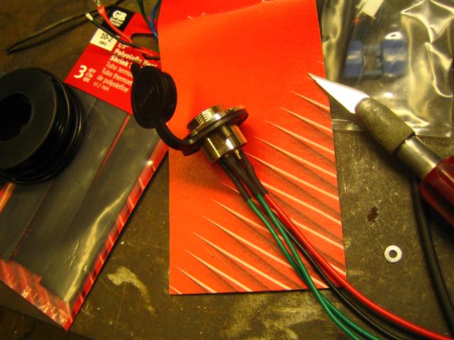

    So, I rethought a little and and after not finding the switch I wanted I decided to run what I brung. I have an Miller adaptor that made the so called 'second generation' XR gun work with the 1st generation XR feeder. I whacked it in half (gag) to make the connection between the 30A and the IMig pin connector. First, I removed the male connector from the IMig and removed all the wires and replaced them with 18ga wire to do the two functions of energizing the weld power and provide power to the drive motor. Only four lines needed.

    After reinstalling it, I butt into various wires to make appropriate connects:

    Then I built the adapter. In my little burg there was no four conductor wire so I just used 18ga hook-up wire and helping hands:

    After soldering and heatshrink, we have the completed adapter. I'll wrap it later. Notice funky 30A; that is the very unit that went swimming in 1988. Pretty dodgy but still cranks wire, sort of:
