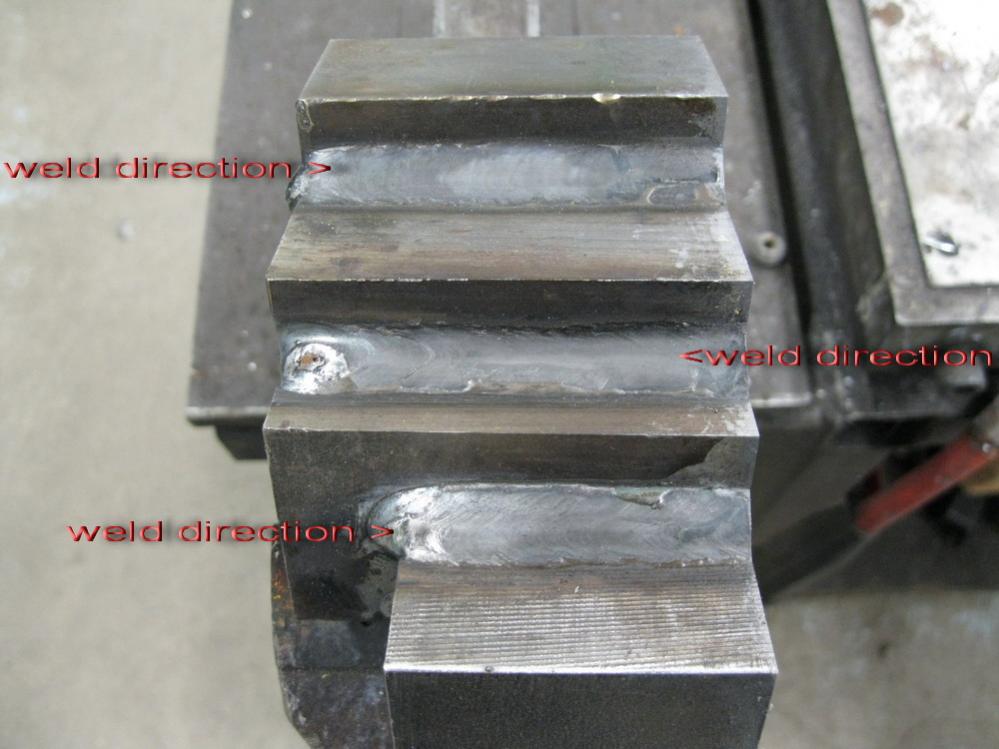

    Test different gases. Used MTS250S in Mig mode not SYN/Mode all welds done with the steel cold using 98% Argon 2% o2 and 75% Argon 25% Co2 and 100% Argon. The eases to weld was the 2% o2 and 98% Argon all welds same settings except the Short circuit weld. The Spray Arc set to 25.5 Volts gas flow 12 LPM.

    The 75/25 showed the best penetration, but it is too much CO2 for proper spray. A little less and you won't see much difference in penetration but a lot smoother easier flow. The 98/2 even showed better penetration at the toes than pure argon. That's where a 90/10 or a 85/15 or even 82/18 (C18) would help out...and give better penetration with lower settings. The short arc is pitiful, but the lack of fusion is a result of making one heavy thick, gobby pass. This lesson can be carried over to aluminum as well by the way, not in the gas mix, but in the penetration and fusing at the root and at the toes...(short circuit versus spray)
