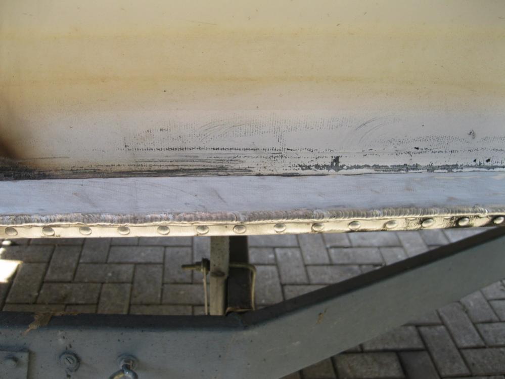

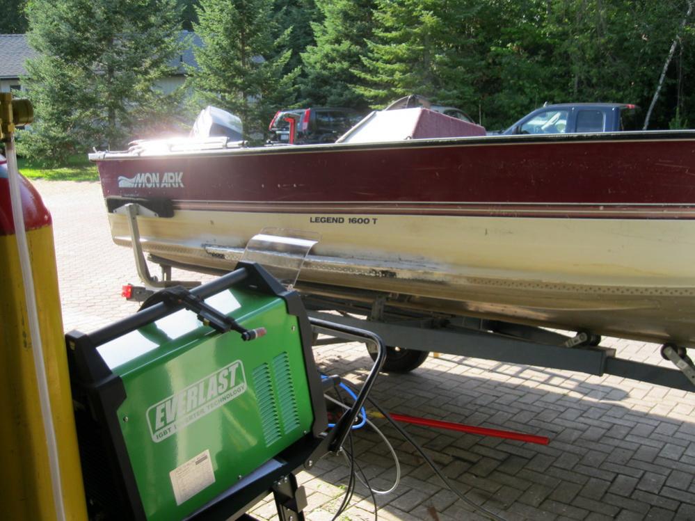

    Used the new 325EXT in single phase 240V had to welded a boat with a crack 52 inches long just a little leak.
    Dang. How did you prep it?
