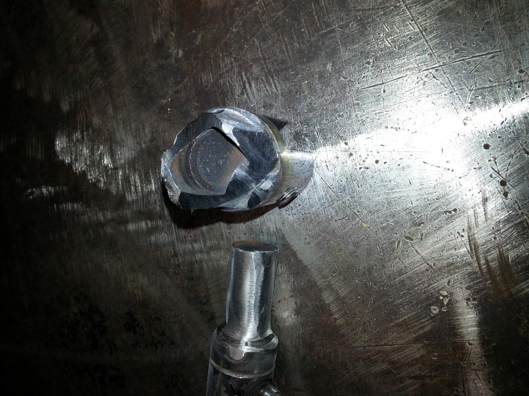

    After I wire brushed it. I do have the spots on the inside. 16 Gauge SQ. tubing scrap

    I turned the V up to about 2 1/2. Started punching through the tubing. Left a blob on the inside. Seems V2 and Wire 2 gives me the better results. Not the best. Guess only the Solid and Shielding gas will do that.
    Don't go to Tractor Supply. Go to you local welding supplier. A 125 can be rented easily for about 4-6 bucks a month.
    16 gauge is about the limit for flux core. I think you are expecting a lot here, more than what you can get out of flux core. Flux core really is intended for much heavier weldments. But if you are getting little blobs inside, that is what it is supposed to do. Otherwise, you don't have penetration, you have something that is barely glued together.
    But here you have these flat U shaped ripples which also indicate you moved too slowly. The ripples should be more convex (concave...I suppose depends upon how you view it), but whatever, the ripples should have more arch and a bit more separation. You should not end up with elongated V's, but simply crisp, U's with a good bit of arch across the bead face.

    On the V2 and W2 setting I get a bluish spot on the inside. If I turn the V up a bit to 2 1/2, Its looks like its too much. Leaving sunken spots on the outside. Maybe 2 1/4? When I find some more scrap, Trial and Error time.
    I was trying to keep the scrap piece from moving too much. Its only about 2" long.
    Your wirespeed is probably low...but the question is, did you go and read what the suggested voltage and amp/wire speed settings were for your wire? Even if it does not have a digital meter, you can determine wire speed easily enough, and get a pretty good guess where voltage would be on the dial by dividing up the range of voltage (given on the specification data found on the unit) into 10 parts. YOu should be able to get pretty close. I am not sure but it sounds as if you don't know that the metal is supposed to melt through for proper penetration. It should be hanging in globs, but should have a neat little line or "bulge". The bluish spot only means the metal is getting hot. It doesn't mean you are getting penetration.
    Welding on top of a piece of metal really is not the best way to learn. You need to fit up some joints and then tack them together before welding a solid seam. You are probably delaying your learning curve by trying to keep welding on thin metal like this.

    What wire are you using, specifically? Stuff that has sat around unsealed will run like utter crap. If it is known good stuff, then we'll work on your technique.
    As far as your welds on your test pieces, you need to move faster doing flat stuff, and you may have too much lead angle, piling up the weld which makes the base metal just drop away. Filling in the J joint between the rounded edge of the tube and your plate will require you to slow down a bit, but, you are going to want to turn it up and fly. When I am doing fluxcore, I always look at the leading edge of the puddle because the actual rear of the puddle is often obscured too much to do you any good looking for it, especially if you don't have a good enough helmet/lens to actually see what is happening. You want to see the puddle "bite" into the base metal consistently and evenly on both sides.
    For the tube joints to the plate, you'll want to learn to "wash" the puddle up to the tube while keeping most of the heat on the plate. This helps a LOT in any welding of thick to thin stuff.
