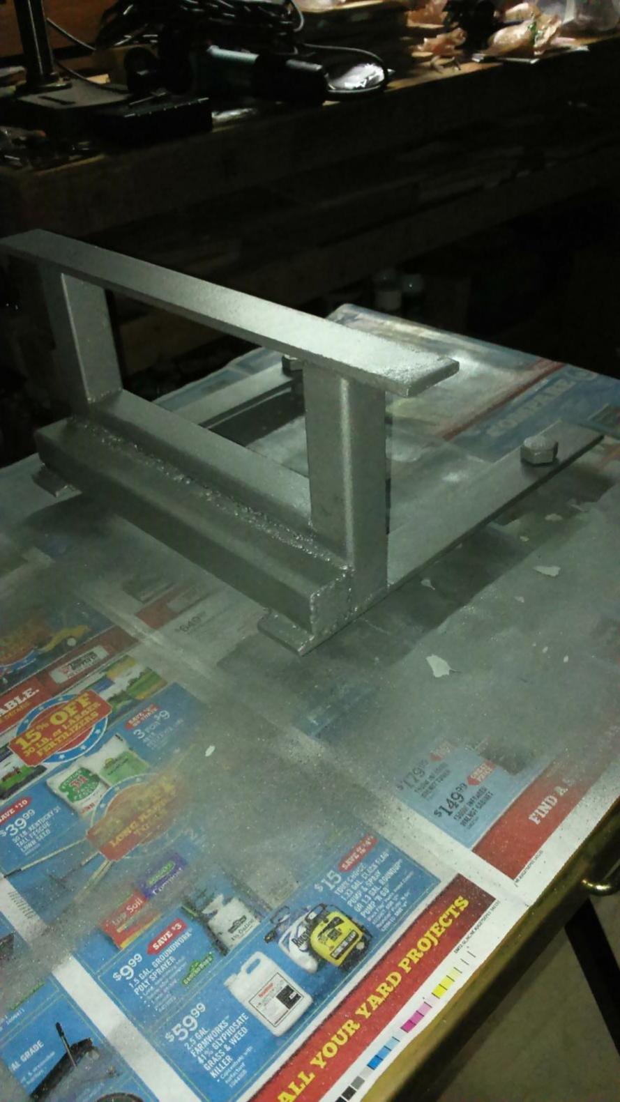

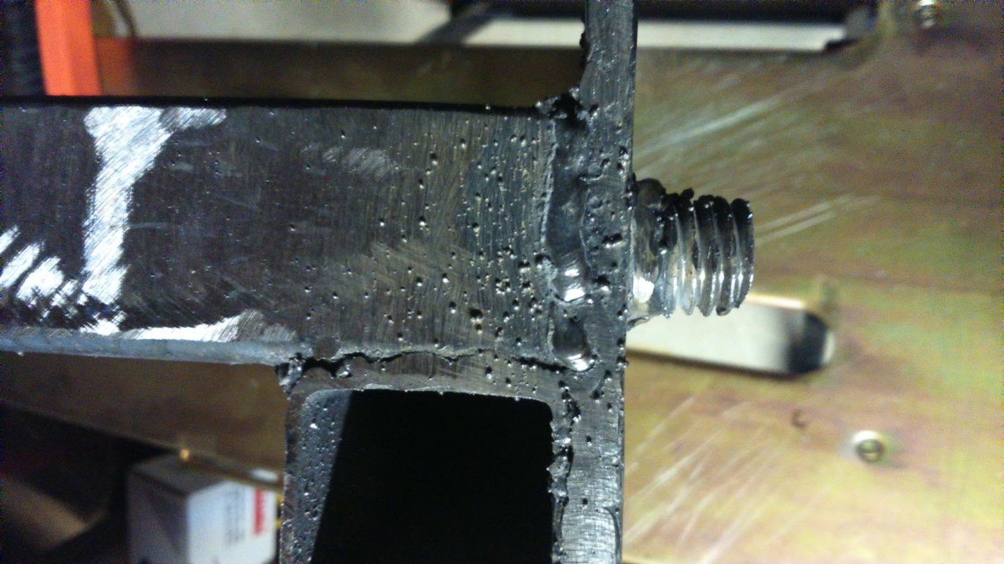

  3. #43
    Aug 2014
    263

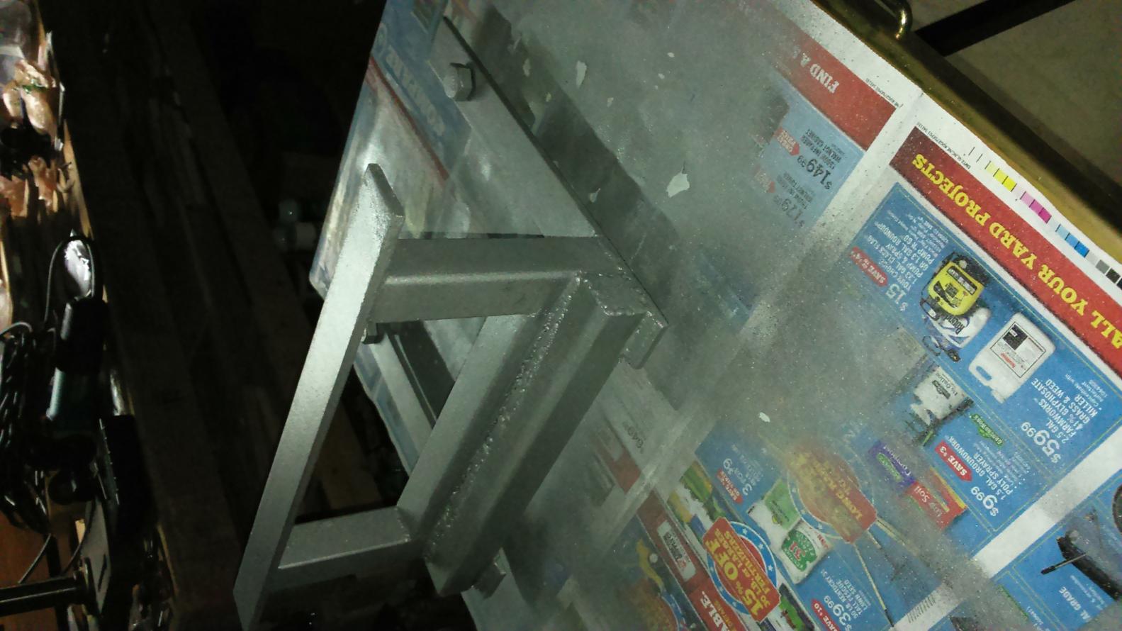

    How does this look? I have been trying to clean up some of my bad spots.
    Thanks

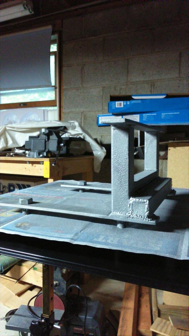

  9. #49
    Aug 2014
    263

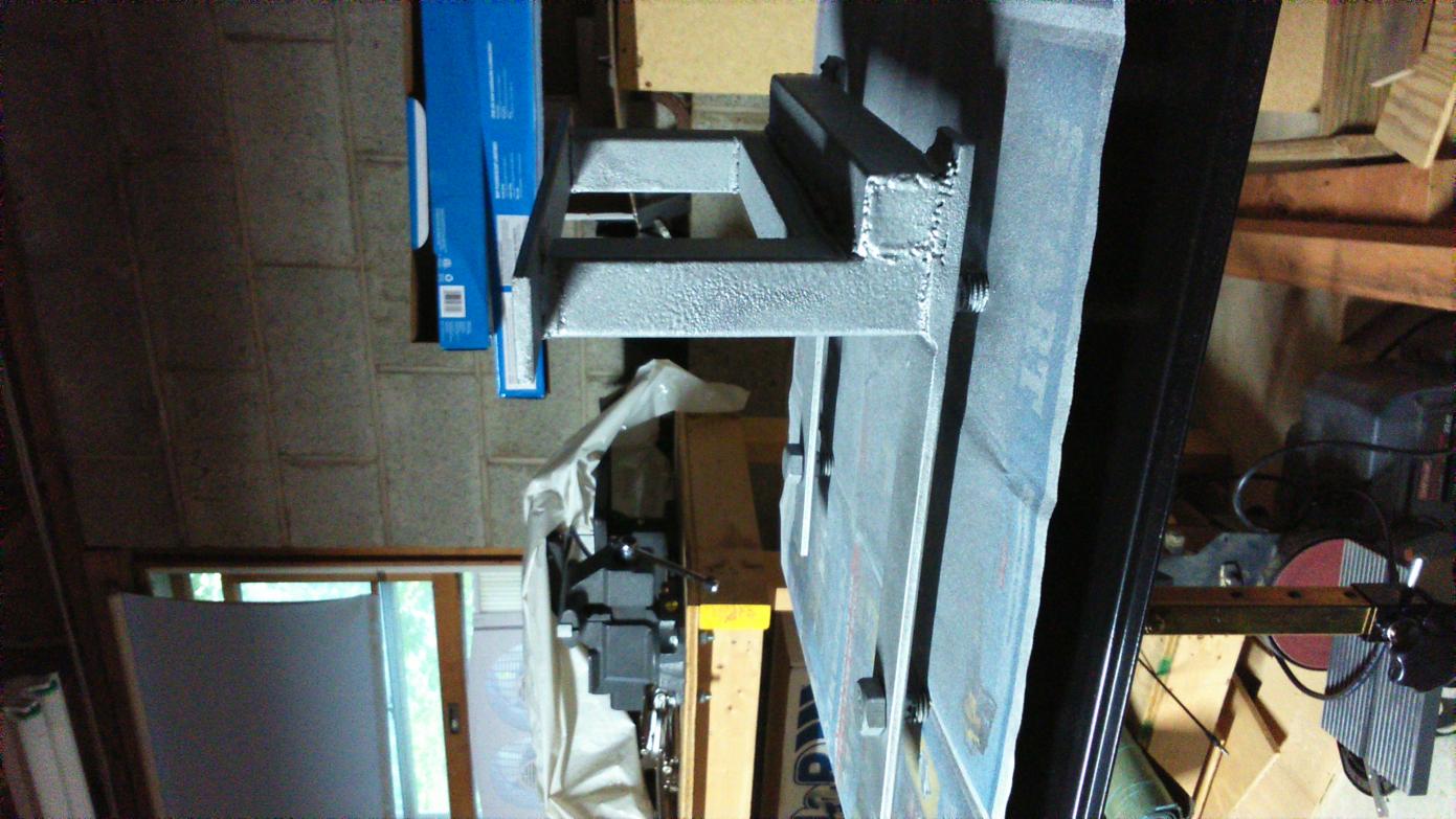

    I gave up on finding the plastic plugs for the open ends. Attempted to make metal ones. Using 16G sheet metal. That was fun bending. Had to use a vise and a dead blow hammer. Belt sander to grind it to fit. Welded it in place. Painted it. Drying now.
  10. #50
    Why did you have to bend it? Most people just cut a square and weld it in place.
  11. #51
    Aug 2014
    263
    Wasn't sure if I did that it would stay in place. I wanted it to sit inside.
  12. #52
    Sure it will. Just hold it in place with a magnet, tack then weld. Better yet, allow for a cap when you fit up your tubing.
  13. #53
    Aug 2014
    263
    I cut the Caps out with Aviation Snips. They weren't very square.
    This whole project was Good on paper. Not in practice. Did not come out as I had intended. I shouldn't be surprised. Story of my life.

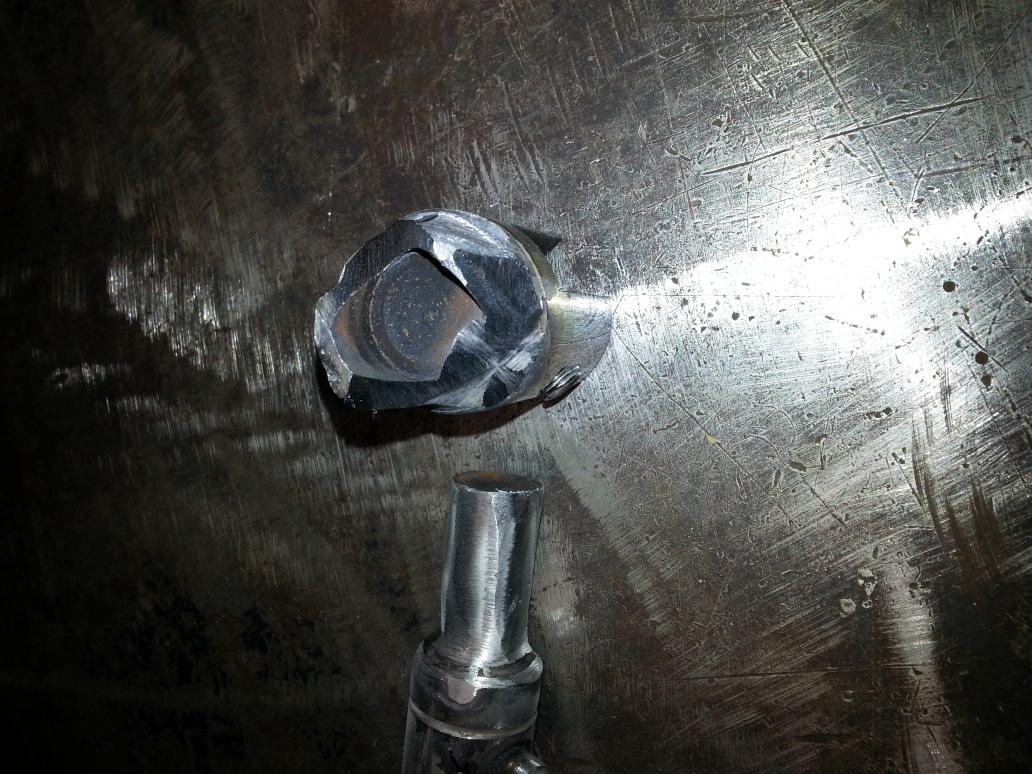

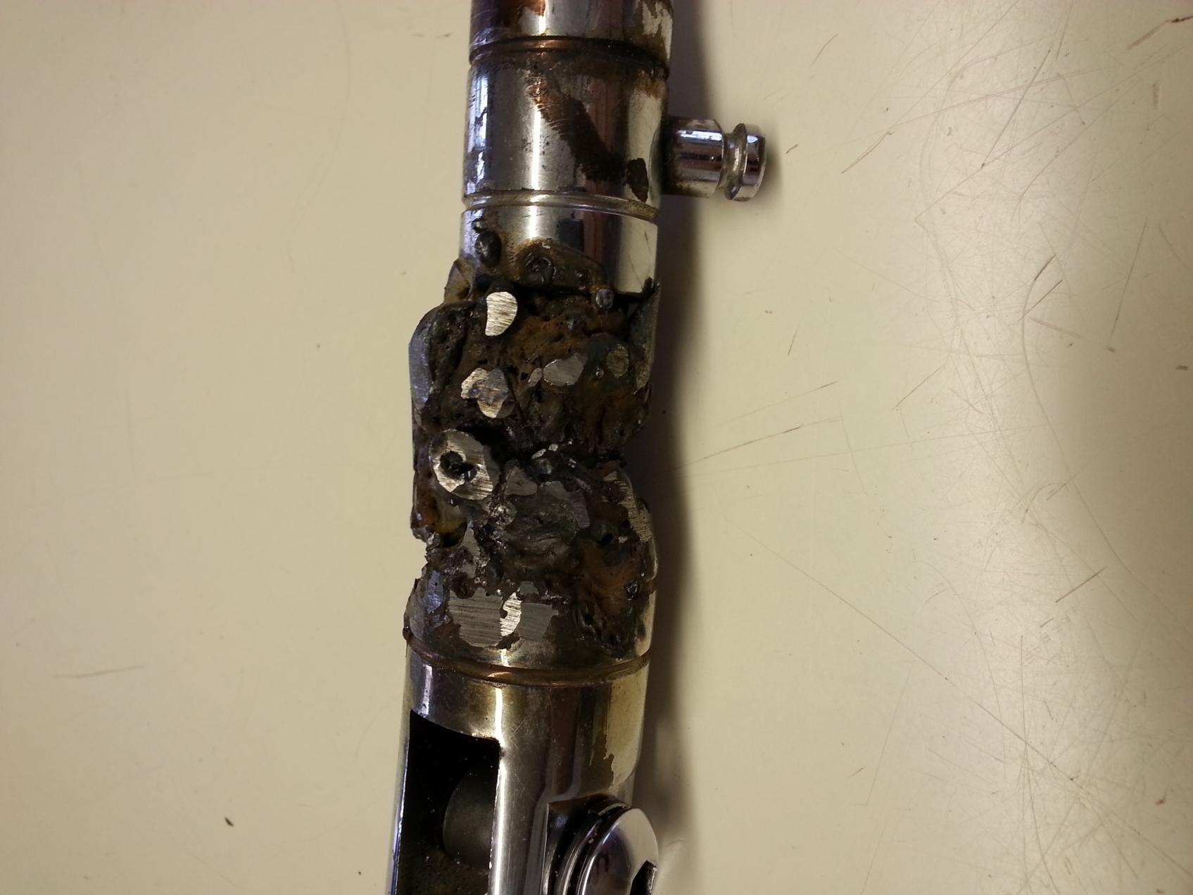

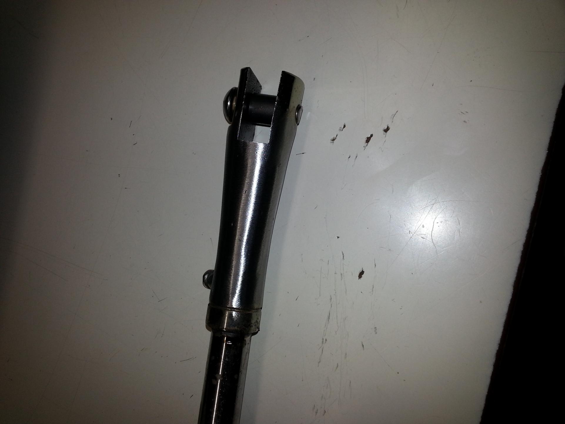

  15. #55

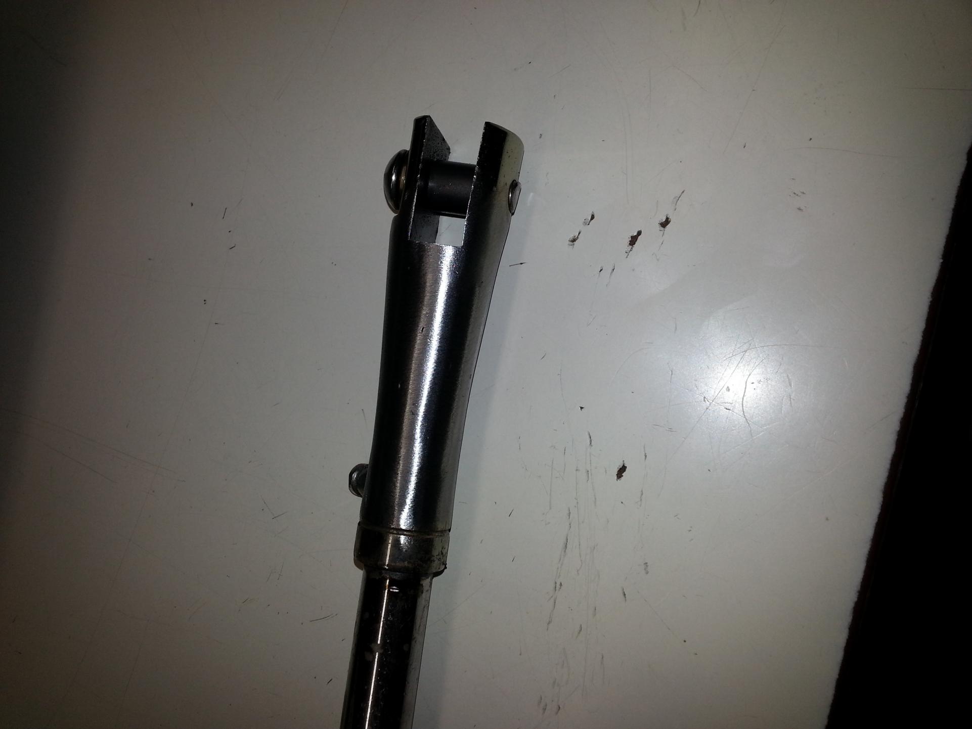

    A grinder with a flap disc can take care of a multitude of welding sins.
    Or as they say; Never weld more in the morning than you can grind off in the afternoon.
  16. #56
    Yep, I just did a quick fix for one of my truck drivers because I felt sorry for him after seeing what his "uncle" did. I have no idea why his "uncle's" weld broke.
    I just ground out the bird shi* with a flap disc, made a sound weld and then filled the empty area with weld and smoothed it with the same flap disc.
    I didn't bother with the couple of tiny little voids left because the weld was strong, I was tired and the job was a freebie. I think he should buy me lunch.
