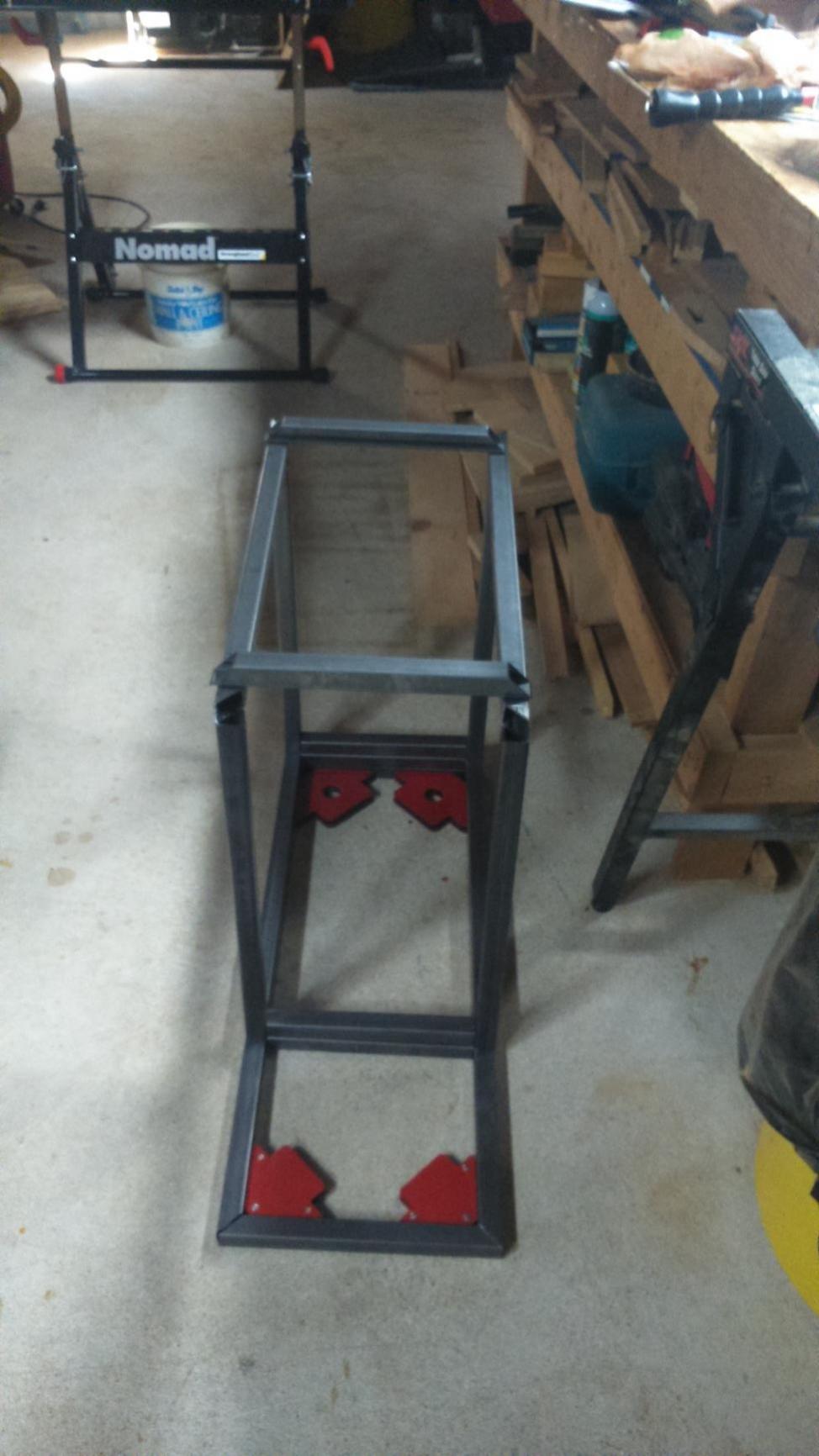

    Hi all. I may eventually build my own Welding Cart. As I haven't found one yet that is decent. After thinking about it a bit, I am not sure Where to begin? One of my ideas involved using Angle Iron (1/8") for the frame. 16 gauge sheet metal for the shelves, Top deck. 6" wheel for the rear. Swivel Casters for the front. When I have some time I'll have to sit down and take measurements.
    Unless you guys/gals think that is a bit of "Overkill"?
    Thanks
    Elantramax1
    Sounds good to me! Fortunately there are tons of cart ideas posted here and on other welding sites, so you can browse to see the range of ideas that others built- there may be things you haven't thought of, or problems you can avoid. Some guys have started with a store-bought model and modified from there, others have created on the fly. Multiple welders? Build in multiple shelves. Confined shop space? Use swivels on all four legs to get a zero turn radius. Are you planning to carry a shielding gas bottle, in the future?

    Here is my idea.
    Cut two 30" long pieces and 3 10" long pieces for the base. The Shelf and Top will be 2 18" Long pieces and 2 10" long pieces each. Using 4, 1" Sq. for the Legs. Welded to the top of the Base. Forming the corners of the Shelves. Maybe 20" High or so. And weld the Sheet metal to the bottom of the frames. So that the Shelves have a lip around them so things don't fall out. Possibly using 16 Gauge. Under the Cylinder, 3/16" Plate. How does this sound?
    Thanks
    Sounds about right, but you can get by with 14ga. plate under your cylinder. Way easier to cut and over that span will hold several hundred pounds. The devil is in the details, especially with tubing. So work out where you will use mitered joints and where you want butt joints, so that any tube openings can do dual duty for something or be capped or covered. Some creative carts have the tube legs open for handy rod storage, but that doesn't really apply for a MIG cart. Be sure to provide a place to store your cables and having consumable storage is a big plus. Expanded metal shelves are nice in that they promote great airflow for cooling and don't catch crud. Of course then you can't put small items like contact tips on them, but depending on your design you might have a small drawer for those things or keep them in a nice divided plastic box.

    Got to figure what Gauge to use for the Shelves? The Imig 140 weighs about 30 Lbs. + Plus wire. Tank weighs about 40 Lbs. Steel. 16 Gauge may be a bit of "Overkill" Galvanized or not? Not would be safer to weld. But a real PIA to prime and paint.
    Aug 2014
    263
ID:	12397 Here is where I am.
    Aug 2014
    263
    The Beave suggested I use an Open grate style shelf. I found a 13 Gauge, 3/4" one at Tractor Supply. And a cheaper one at HD. The one at HD is 1/2" spacing. And it states .125" which tells me 1/8". These are 12" x 24" pieces. Which would work for the two upper shelves. Not sure if I want to Trust that for under the weight of the Tank. I am thinking about the two at HD. Would get me started. The bottom one would be welded on last.
