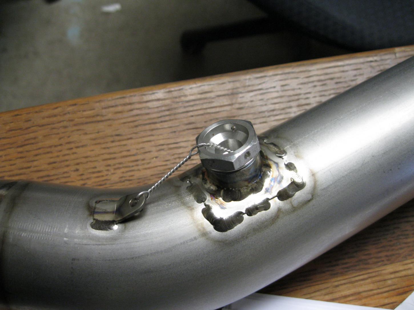

    Hi all. I probably know the answer to this. Just wanted to kick around the idea. Before it happens again. Here is my Story:
    Boy did I get Lucky today. While coming back from Browns Mills my Motorcycle suffered a malfunction. The O2 Sensor Plug fell out of the exhaust pipe. Over on Browns Mills/Cookstown Road. Another motorcycle rider stopped to help me. Couldn't find it. I "Limped" my way to Bordentown to get gas. Then to my fathers house. Went to HD and Lowes looking for a M18 1.5 Plug to replace it. Ended up at Advance Auto at the White Horse Circle. They had what I needed. Got home and installed. I may use my welder and tack it so it doesn't come loose again.
    My Motorcycle doesn't have an O2 sensor. It has a Plug in its place. Can I Tack Weld this so it doesn't happen again? The Pipe is Stainless Steel. Copper Gasket. Not sure about the Oil Drain Plug I had to use. As I couldn't find a M18, 1.5 Plug.
    Thanks
    Is there anyway you can put a lock wire on it most of the exhaust pipes I do I put a tab on it or find a place to put the wire. Just drill a hole in the plug and find a place for the wire or make one.

    Guess I could do that. Have to use my drill press. Not sure if I have any Safety Wire laying around. Just wrap it around the pipe
    That is better then have it blow out copper wire works if you don't have stainless wire.
    Blue Loctite?
    Or Red if you want a more permanent solution...
    rivets
    It would be too hot for locktight to work. Locktight breaks loose at about 350 deg. I would do what Kempy said and put a safety wire on it.

    Due to the weather this week, I'm not in a big rush. I may just get another and drill it. Incase I run into problems. Thanks
    Loctite make one for +650°F but wire is cheap Loctite is not. (http://www.henkelna.com/us/content_d...bricity_tl.pdf)
