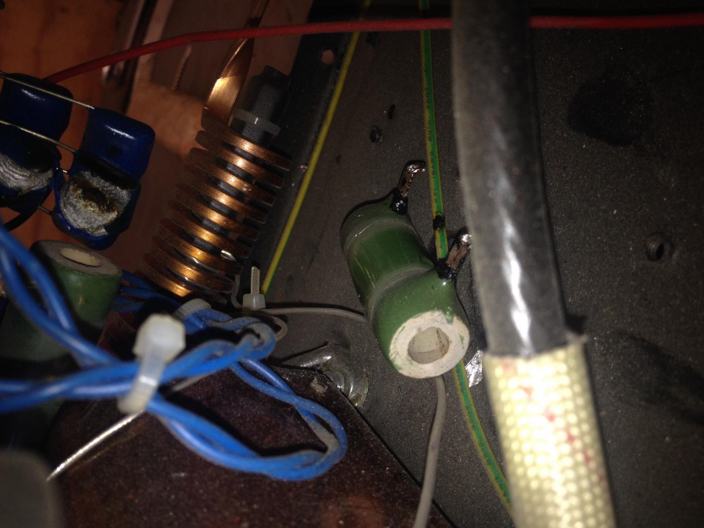

    Well... My 250EX burnt up again today! It had been working great, mostly tigging aluminum. I switched over to stick welding with 3/32 rod at 70 amps and it began to smoke. So now I suppise I'll have to pay another $150 in shipping. More importantly is the down time with out machine.

    These are two pics of what I found.
    Looks like you let the smoke out of those caps.
    I hope they can get you taken care of quickly. I'm still waiting on my machine to be repaired.
    Well, I finally heard from repair site. They have determined my welder was struck by lightening and are not going to warranty it. I tried to explain that was an impossibility because I never leave any machines plugged in. Just the nature of sharing shop with vehicles. I further tried to make clear that I was using machine when it failed! I had been tig welding. Then I switched over to do some stick welding. When I did, machine started smoking. Again, no chance of a lightening strike. Needless to say, I'm very disappointed in Everlast!
