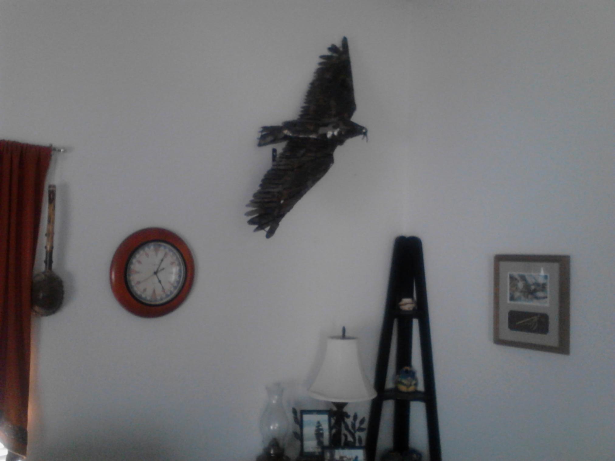

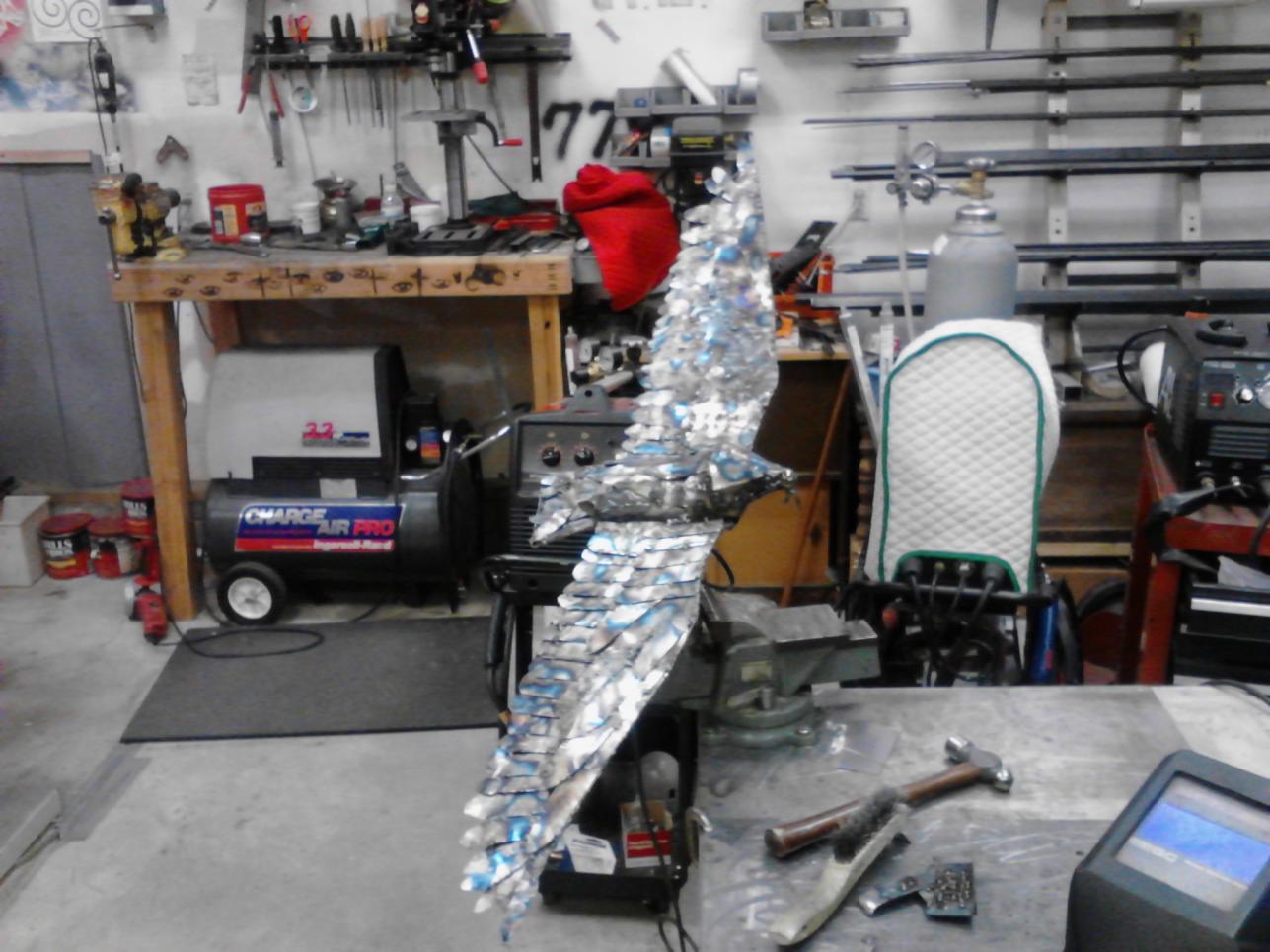

    I've been pretty busy just trying to keep things afloat since I'm "retired" now and don't have a steady income but I'll tell ya I'm a whole lot happier now not having to please the unpleasable and do things the way incompetent "superiors" want me to do things. Been making lots of things in the shop and vending at races and runs ... here's the last thing I made Click image for larger version.

ID:	12456 ... if you can't tell ... it's a raven that I made to sell but my wife liked it so for now it's hung on our wall ... till she gets tired of it.

    Looks nice. I see why she wanted to keep it. Looks like a lot of work. You braze or MIG it?
    It took several days and a lot of material ... since it was done with a lot of small pieces I held with one hand while attaching I used my MIG that allowed me t keep the weight done however I have been using a lot of silica bronze and my TIG on things lately ... I love the way I can use low heat and the filler flows nicely on thin metal.
