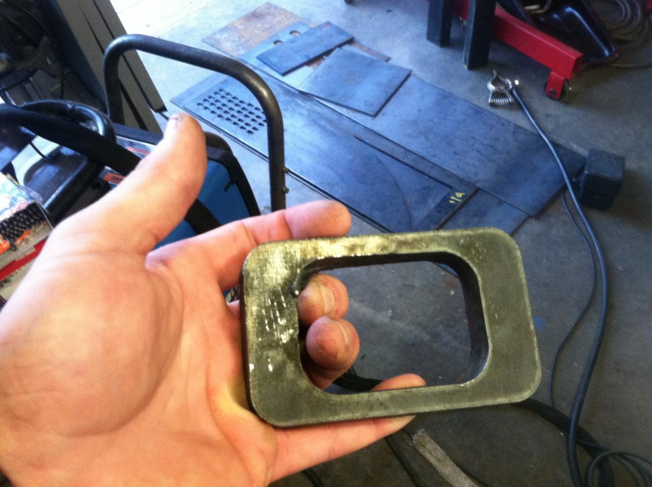

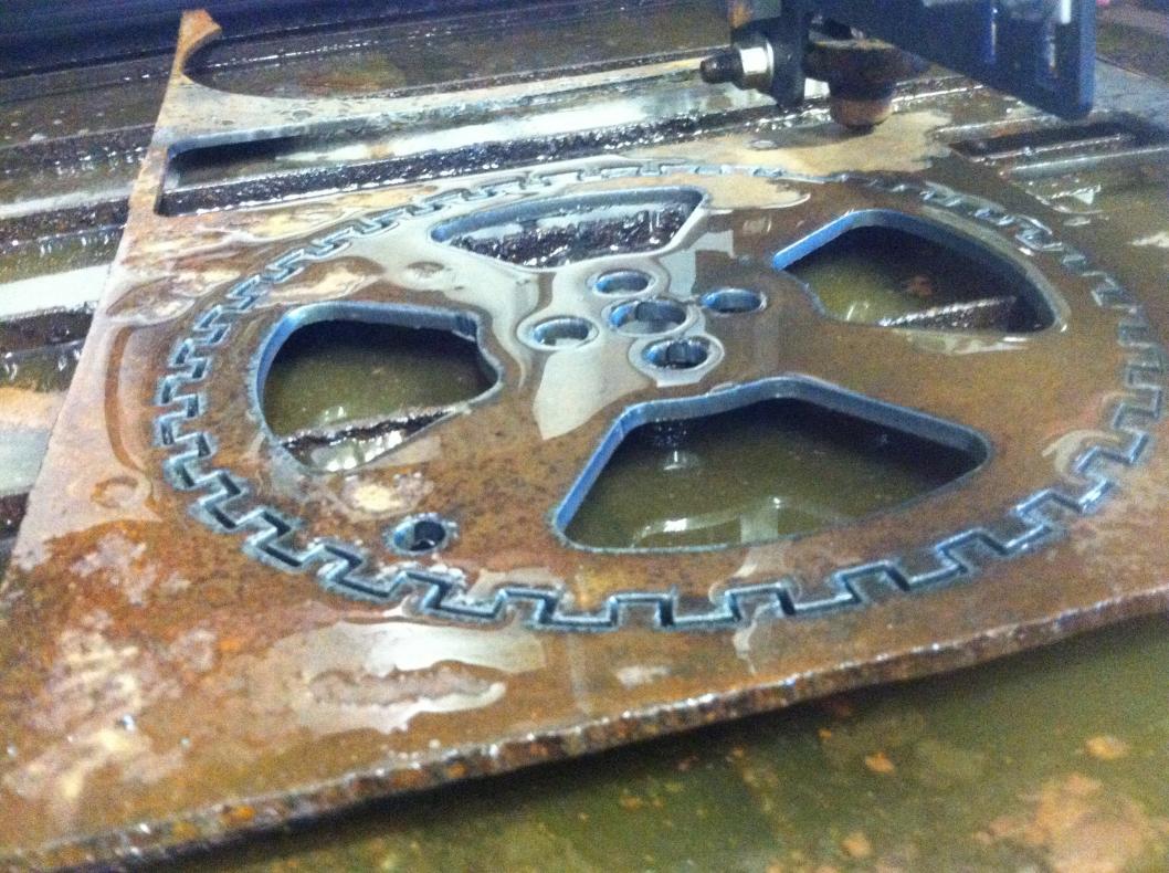

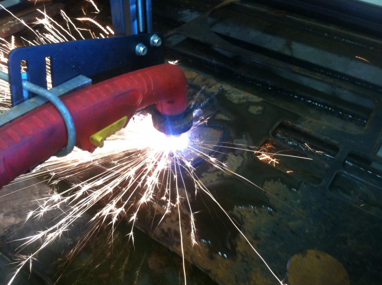

    Doing some cutting on the torchmate tonightClick image for larger version.

    Very nice. How bad was the cleanup? It is nice you can make your own parts. Did torchmate come with controller and software?

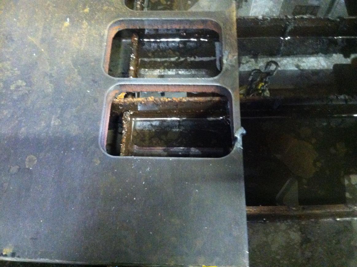

    That's really good work. Oleg forwarded me pictures of that last you night. If you can, post up the consumable size, material thickness, amp used, thc or not, speed etc. and the details about what it is and why it's needed ( for conversion I believe) for others reading interest.

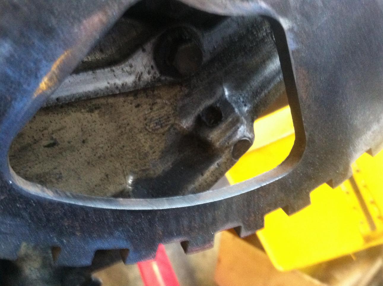

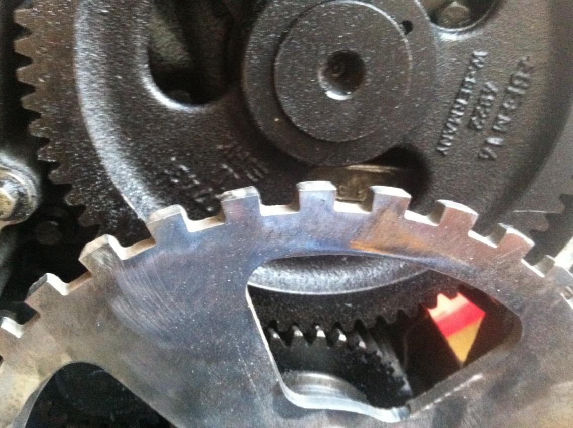

    This part allows the factory tach in ford trucks work with a cummins engine, metal is 3/16, cut rate was 40 ipm, at 45 amps, no torch height control, consumables are 1.0 tip for the s75 torch. I am looking to getthe machine torch in the future. Thank you for the questions.

    Very impressive work. After cutting and clean up did you have to balance it, like you would for a boat prop?

    Thanks!No balanceing required for this applcation

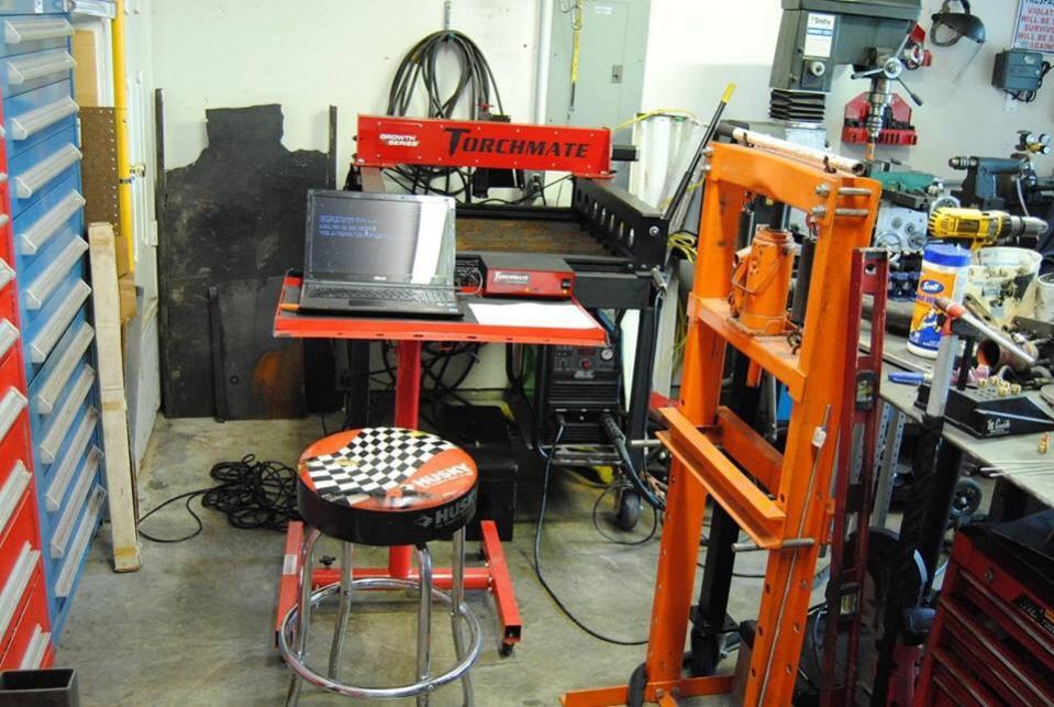

    Pretty slick. So you drew it in their cad/editor. And then sent it to cut? If so, slick. So you added computer and plasma cutter and you were running? How bad was assembly? I looked at the 2x2 but never bought. Sounds like it was pretty straight forward.
ID:	12484Click image for larger version.
    This is my work space for plasma cutting

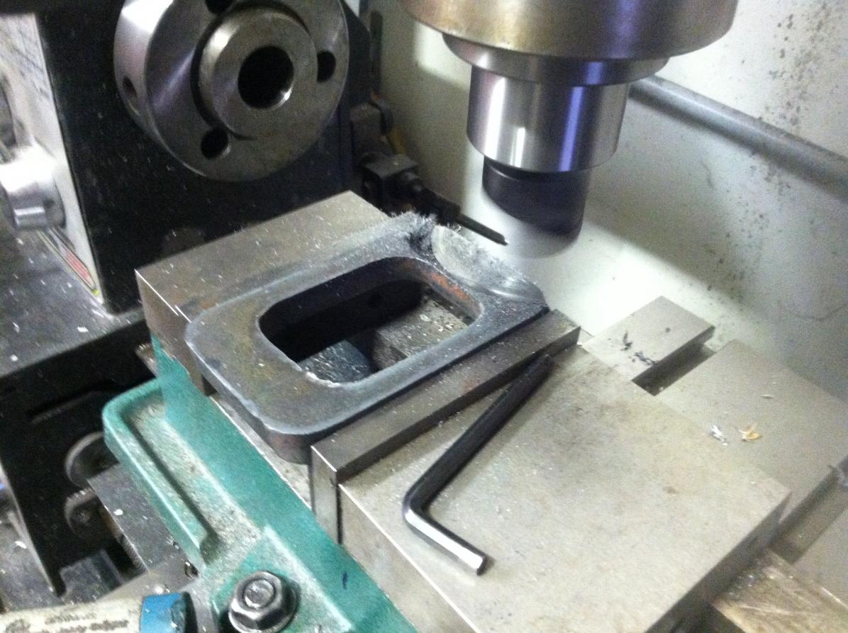

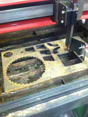

    Cut 1/2" at 20 ipmClick image for larger version.

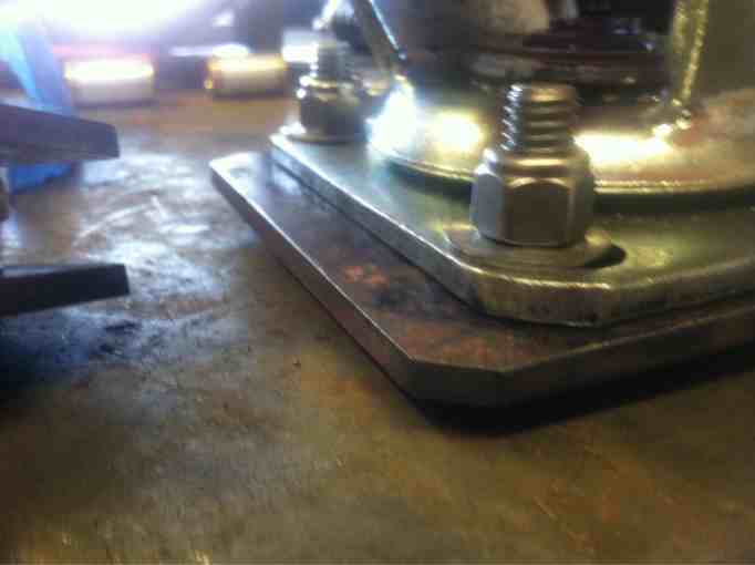

    3/16 sheet used on my caster wheel project
