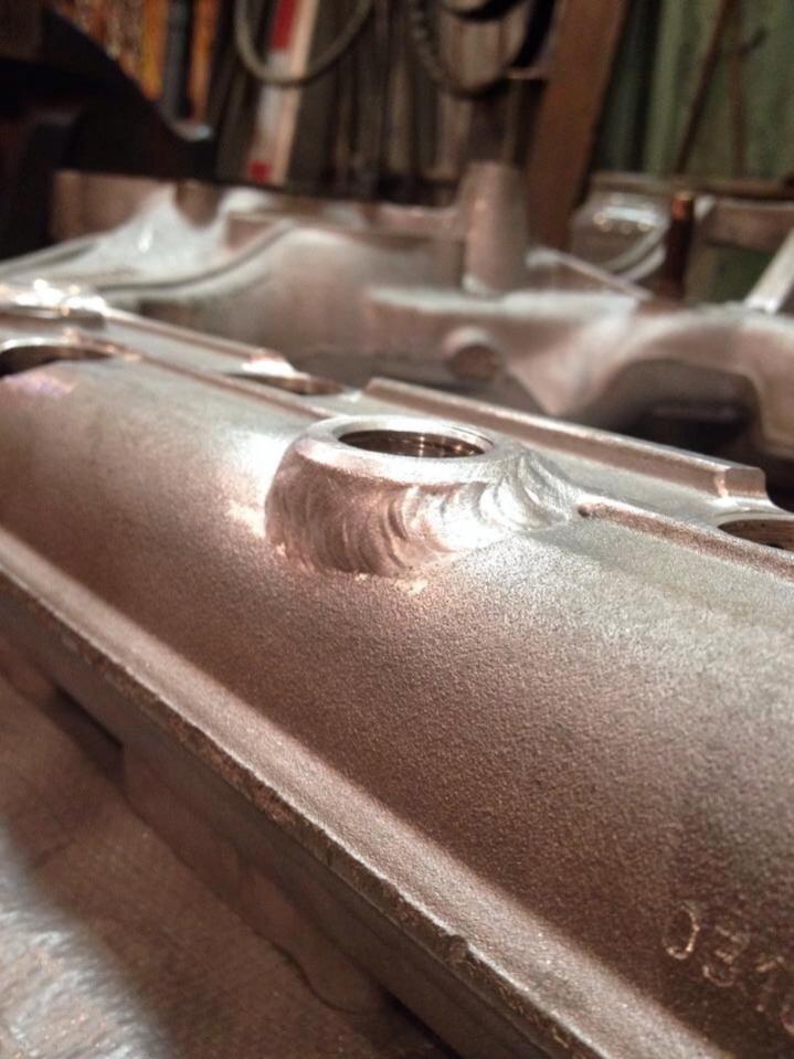

Milled down 14- 9/16 diameter posts that ran thru the intake to bolt it down. That's 4 inches of restriction per side, intake will now bolt down from the inside. Access is thru the bungs. Click image for larger version.
