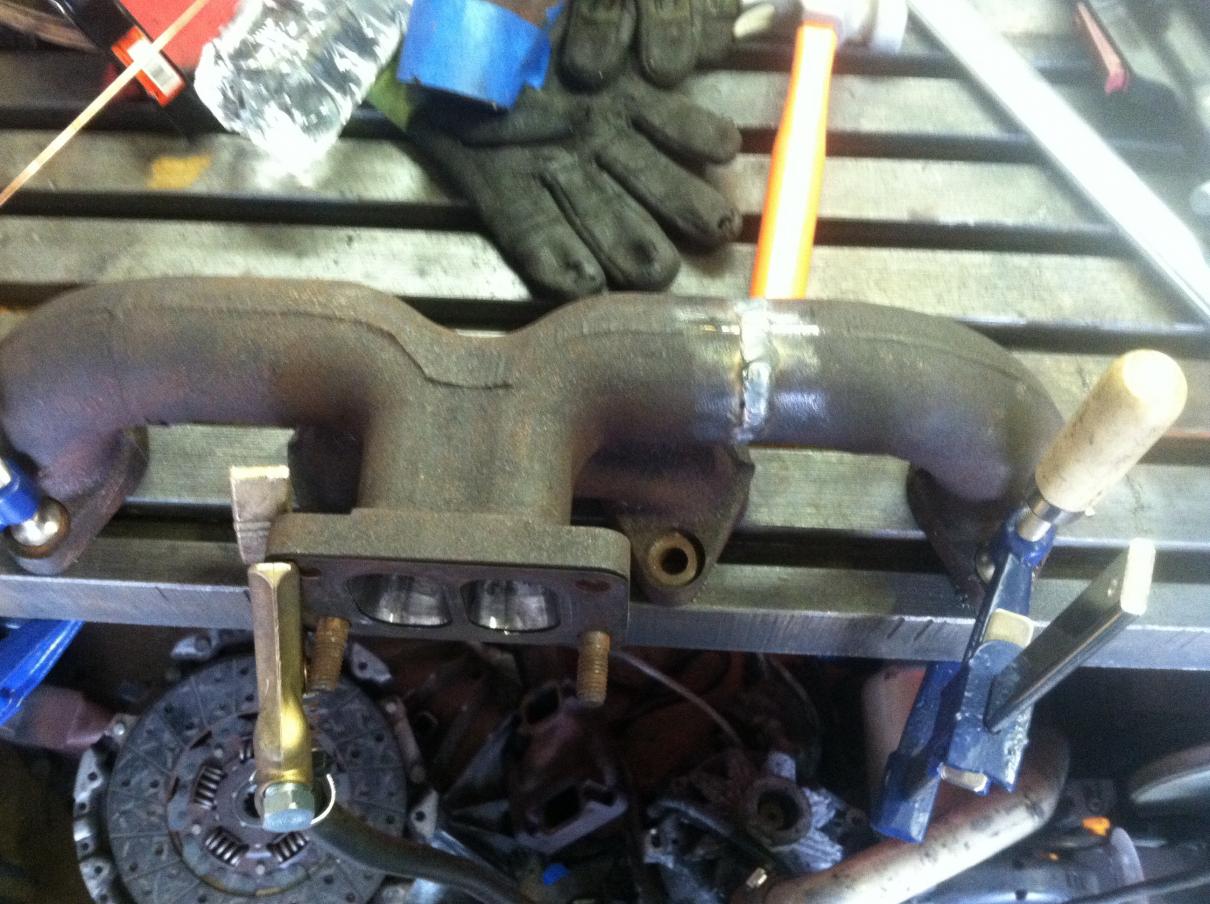

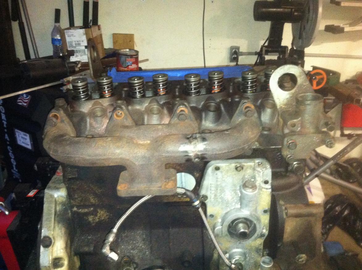

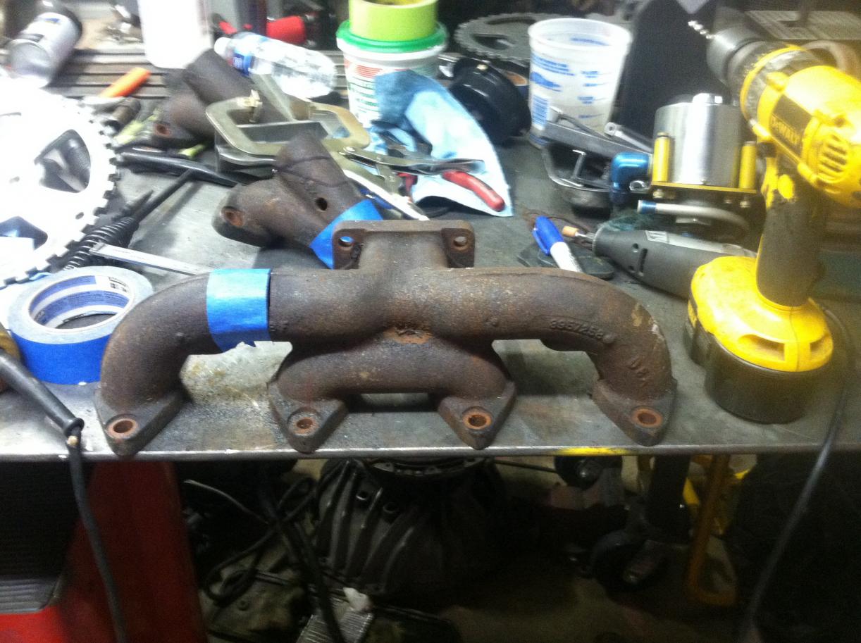

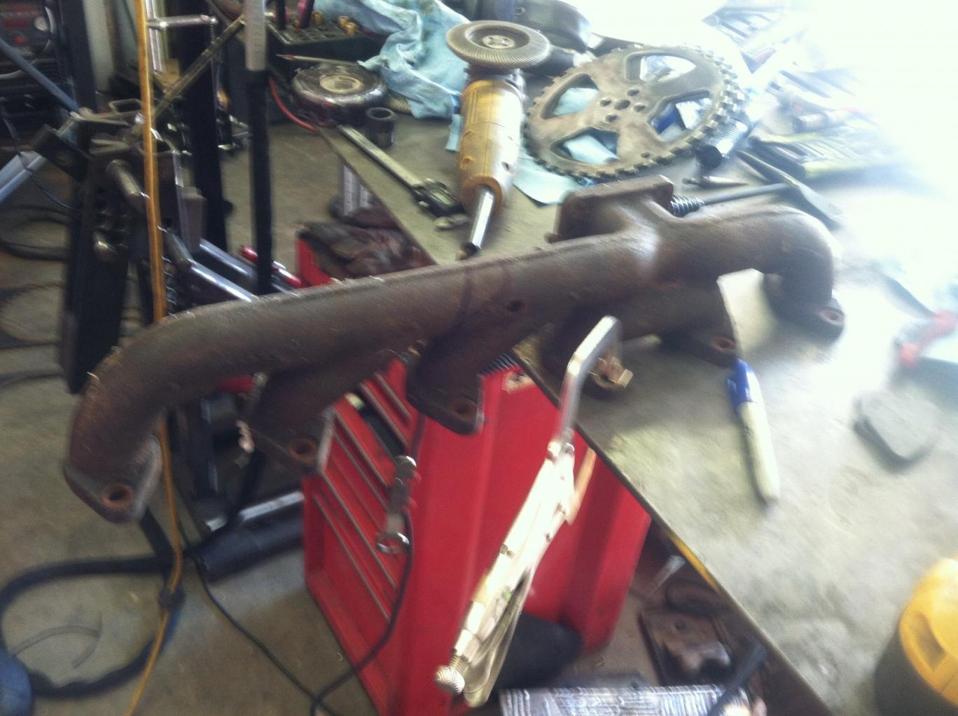

    Cut this down to fit my 4bt cummins and tig welded with my 210ext Click image for larger version.
ID:	12491Click image for larger version.
ID:	12492Click image for larger version.

    Just curious, how did you cut it, and did you have flush mating surfaces or did you have a gap? I've always heard that for cast iron you have to preheat and post heat carefully to avoid cracking. Same deal for you?
    I left a small gap chamfered both sides, cut it with a band saw and I did pre heat it and clamped it to the table till cooled to ambient temps

    What filler metal did you use on the exhaust manifold ?
    Er70s-2 seemed to work fine, no cracking occured

    A little more progress, reshaping the ports
ID:	12494   Click image for larger version.

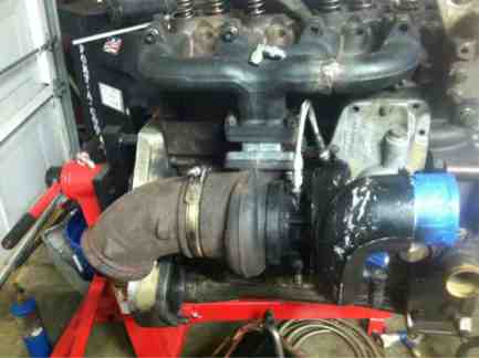

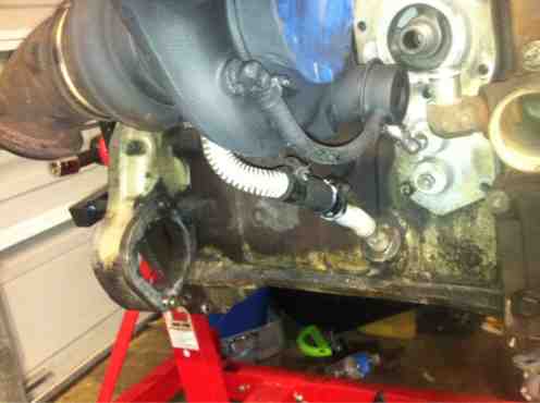

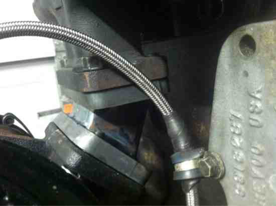

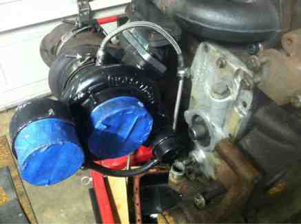

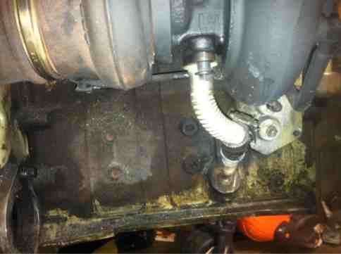

    Here is the manifold and turbo bolted in placeClick image for larger version.
ID:	12546Click image for larger version.
ID:	12547Click image for larger version.
ID:	12548Click image for larger version.
ID:	12549Click image for larger version.

    The oil filter will be remote mounted
